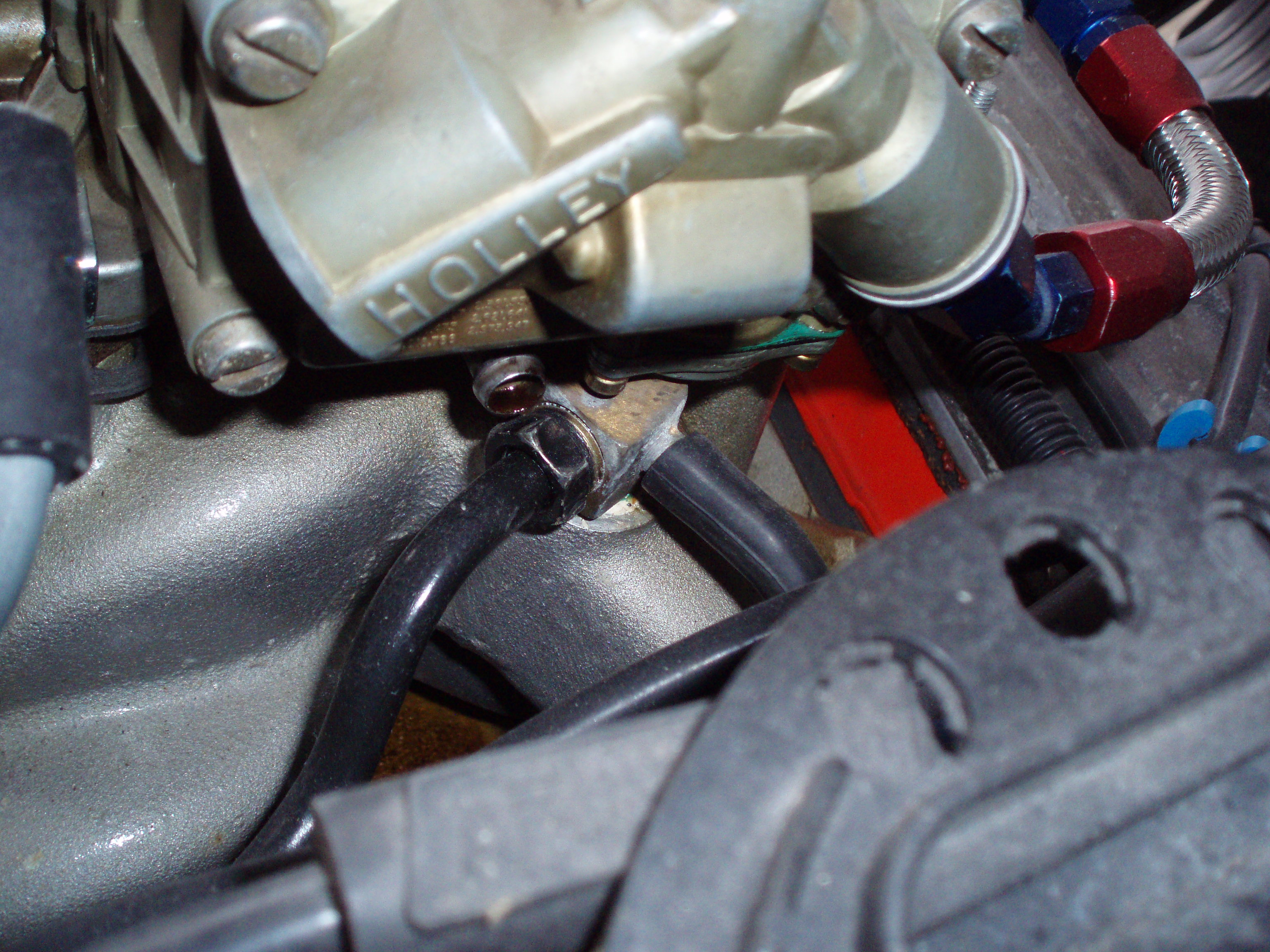

What type of 90 degree fitting are you using into the intake, Brass, Plastic, Steel?
While not a great shot this is a better picture of how I modified the brass fitting on my 406. If you are using a brass fitting why not drill and even solder a piece if 1/4 tube into it for your vacuum modulator? It would keep all that at the rear of the engine.
While not a great shot this is a better picture of how I modified the brass fitting on my 406. If you are using a brass fitting why not drill and even solder a piece if 3/16 tube into it for your vacuum modulator? It would keep all that at the rear of the engine.

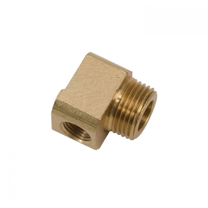

I used this fitting made by Edelbrock. It was the only one I could find that would fit under the bowl without a spacer.
I had that one also, but did not use it. On one of the flats you could drill and solder a piece of 1/4 brake line to use for the vacuum modulator on the transmission. as far as the PCV and brake booster I don't imagine it would matter if those were both ran off the same 3/8 line. The pcv line under the air cleaner is a great idea rather then using a push in filter in one of the valve covers. Makes it a closed system like GM had.
