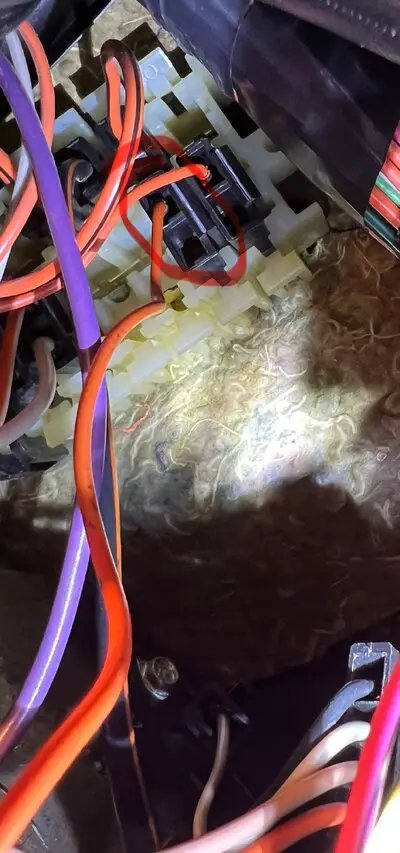

Hi all, I got a very nice lighted visor mirror to replace my unlighted one. Where does it plug into the harness at? Does it go directly in the fuse block?

Orange wires usually go into the distribution block.. usually on powered option cars..i may be mistaken though.. I'll see if i can find it in my body manual
The orange wire double cavity connector (C353D) withh plug into the C353 Junction block the the upper left corner behind the dash. It should route up the driver side A pillar over to the passenger visor mount.
That's what i meant by distribution block.. i just happened to have mine sitting on my side table lol
And to top it off i had a wire i could not figure out were it went to when i was putting my interior back in lol.. now i know its the vanity mirror.. one members question results in anothers X on another checklist!
Thanks for the help! I have it plugged in to the block but no power to the mirror. I’ve checked the bulbs in the mirror and they are good. What am I missing?
