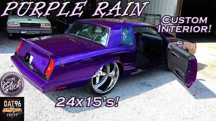

I’m working on getting my rear end ready to go but before I get too far I have a question. I found this car online and love the stance and the way the rear wheels are deep and the front are not. My question is what do you think was done to the rear end to achieve this? Rear is 24x15 which I don’t need 15 inch wide wheels but I would like 10 inch wide. And I would also love to have the deep dish wheel in the back. View attachment 182006
Not sure what they used in your picture but here is my 87 Elco and sizes info: frame notch, Ford 9” (stock width), QA1 coil overs, billet specialties 19x10.5 with 305-35-19 Michelin pilot sports and custom 5.6” backset. The front is coil overs, 2” drop spindles and 18x8 billet specialties with 4.75 backset and 265-45-18 pilot sports. I went this route so I could put matching “good” tires on it I could easily replace on the road if needed. The coil overs give me significant ability to set the stance the way I want it. We have since dropped the front 1.5” and the rear 1” since this pic was taken. I hope this helps you decide
