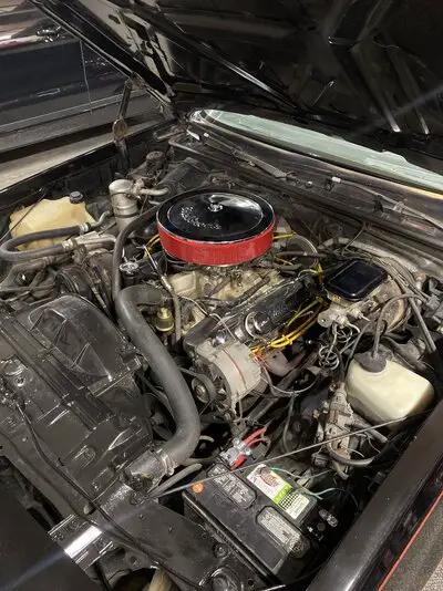

So I’ve got a couple questions and hoping to get cooling system advice. My son’s ‘83 Calais was originally a V6 car but it has a ‘69 Olds 350 in it now. It's a 3 core radiator but it looks pretty crusty and already has a tiny leak so I’m planning to just replace it. We live in Nebraska so summers are hot and humid, the car is also black, and I noticed that when we would idle for a while the temperature would creep up. The fan clutch appears to be the cause for that. He currently has a school permit so he doesn’t drive it for very long but I need to get it resolved before winter so that I don’t have to keep adding coolant. Parts stores aren’t any help in my area b/c of the engine swap and I don’t know what the engine came out of. I’m not looking for the cheapest options but it is a ”school” car so I’m more interested in reliability. Originality doesn’t matter and he wants to participate in car shows but I would like to not have to make a lot of mods. It’s using the built in trans cooler currently (turbo 350 trans).
-There’s a lot of fan clutch options for a ‘69 Olds 350 so I’m not sure what part # to go with there
-Is an aluminum radiator the better way to go to keep temps down in the summer or should I stick w/ OE style.
-For hoses would you recommend the universal braided style or find a rubber style to fit.
Any advice is appreciated.

For dealing with the parts counter dopes, just claim it's a 307 with heavy duty cooling but all they'll have is those plastic tanked/aluminum cored units. Summit is one place that carries copper/brass units. For all aluminum not all direct fit are a direct fit.

For those of you looking for a radiator that fits perfectly to replace a 307 stock radiator I bought a Champion aluminum 3 core that had no fitment issues but they do have larger outlets that require different radiator hoses, here are the part numbers I used which are both made by Dayco upper hose 70548 and lower hose 70936.

With minor trimming you can fit a wider A body rad. I used the aluminum plastic radiator with my 350, stayed within 10 degrees of the thermostat. I also used the Champion 3 core, it only cooled Ok but fit quite well.

Speed Daddy and DNA Motoring both sell radiators that are apparently equal to Champion in quality but slightly cheaper. They come with a plastic drain petcock.
I currently have no complaints about my plastic tanked Spectra, but will likely upgrade to an all aluminum B Body unit from DNA in the future.

Update: I ended up purchasing a Liland Global 162AA3R aluminum from Rock Auto for less than $300. It was listed as the HD cooling replacement for a 307. Even though I haven’t been able to drive it on a hot day I can tell it’s doing a better job of cooling. I also replaced the fan clutch and flushed everything out. Previous person who had the T-stat housing off was nice enough to strip the threads out of the intake so it got helicoils and a new housing.
