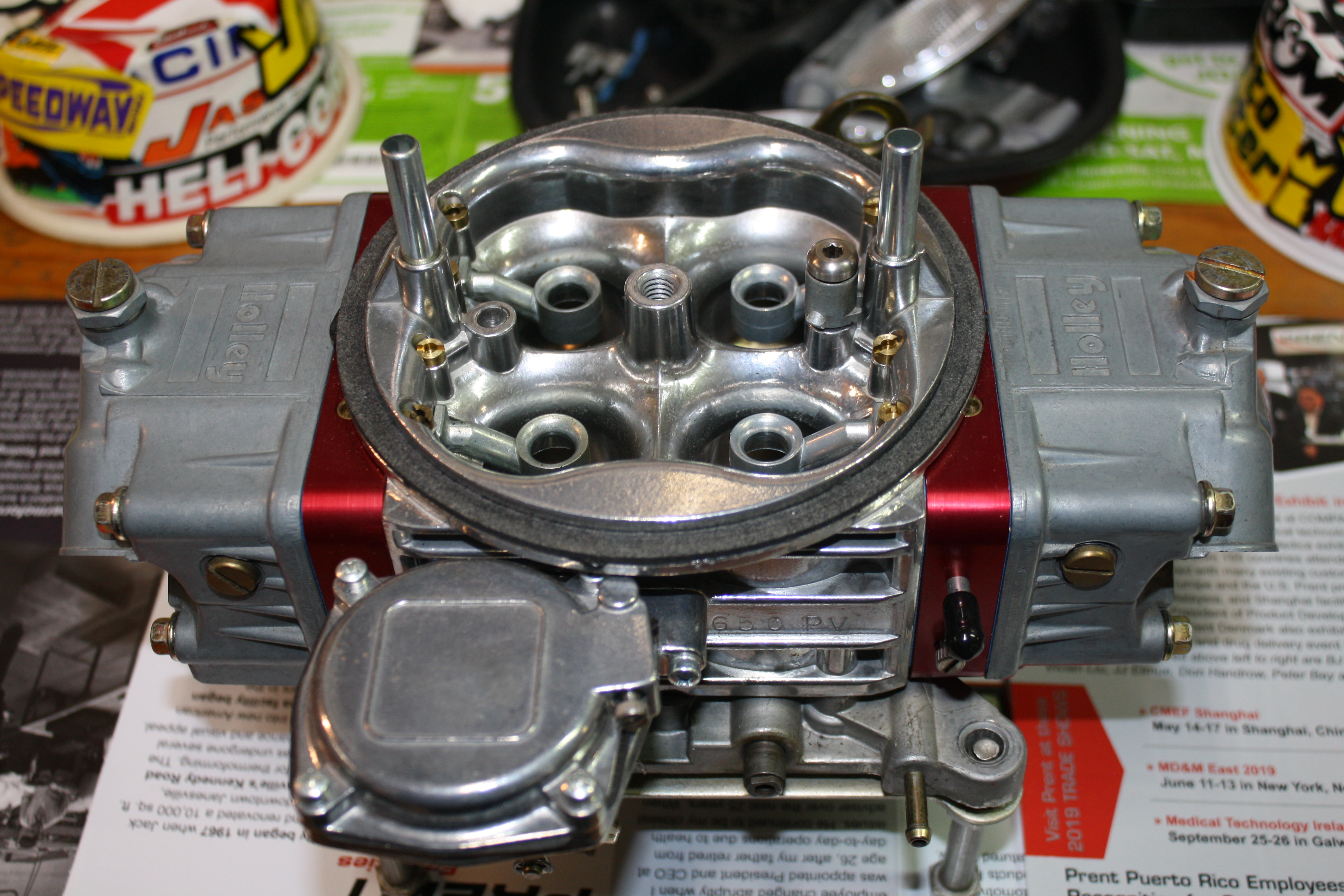

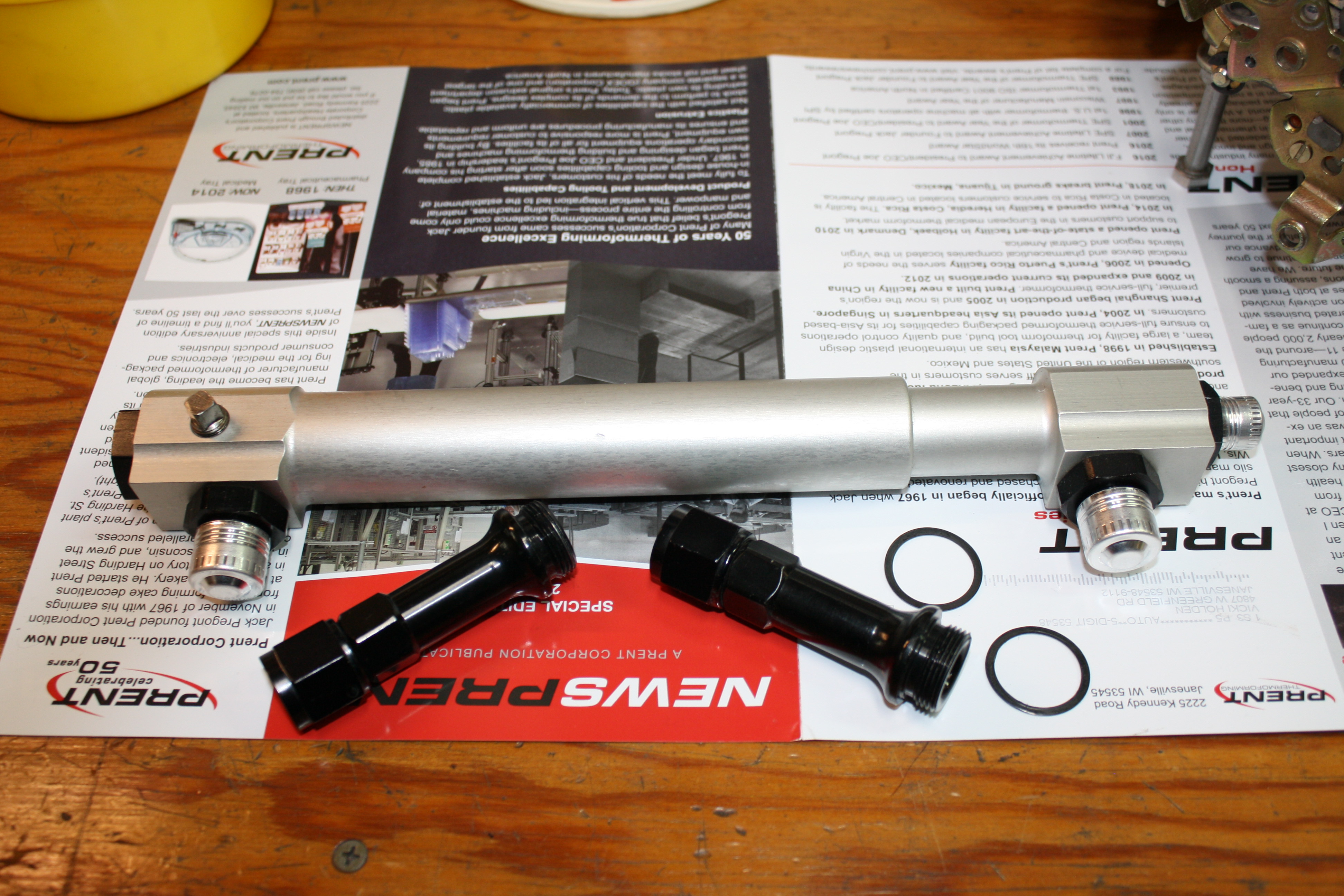

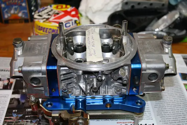

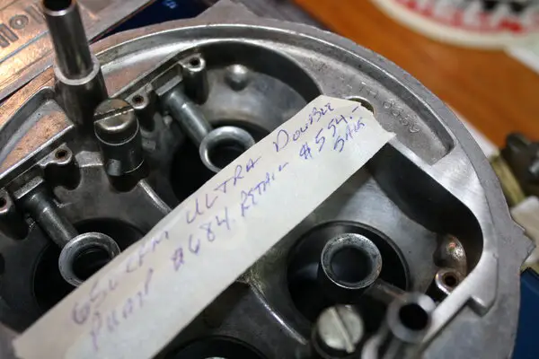

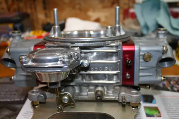

Greetings Myles & all; This is just a short note, more late. I have some carbs that may work for you that I'm selling for a friend + one of mine. Here are the pictures. Later Ole' Bob.
