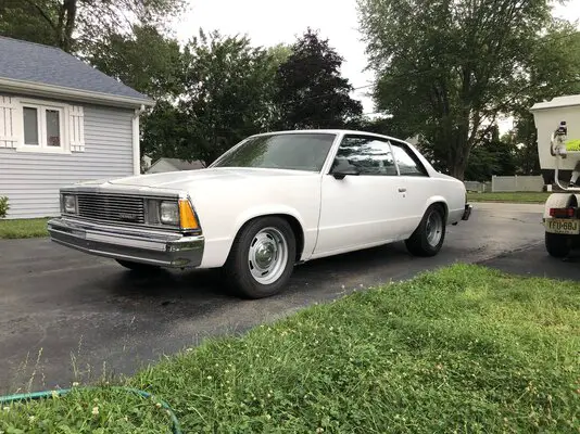

Does your wagon sit lower than this? I had vette rally’s all around but they rubbed when I lowered it. Now I have 15x7 FW code rally’s in front and they no longer rub.

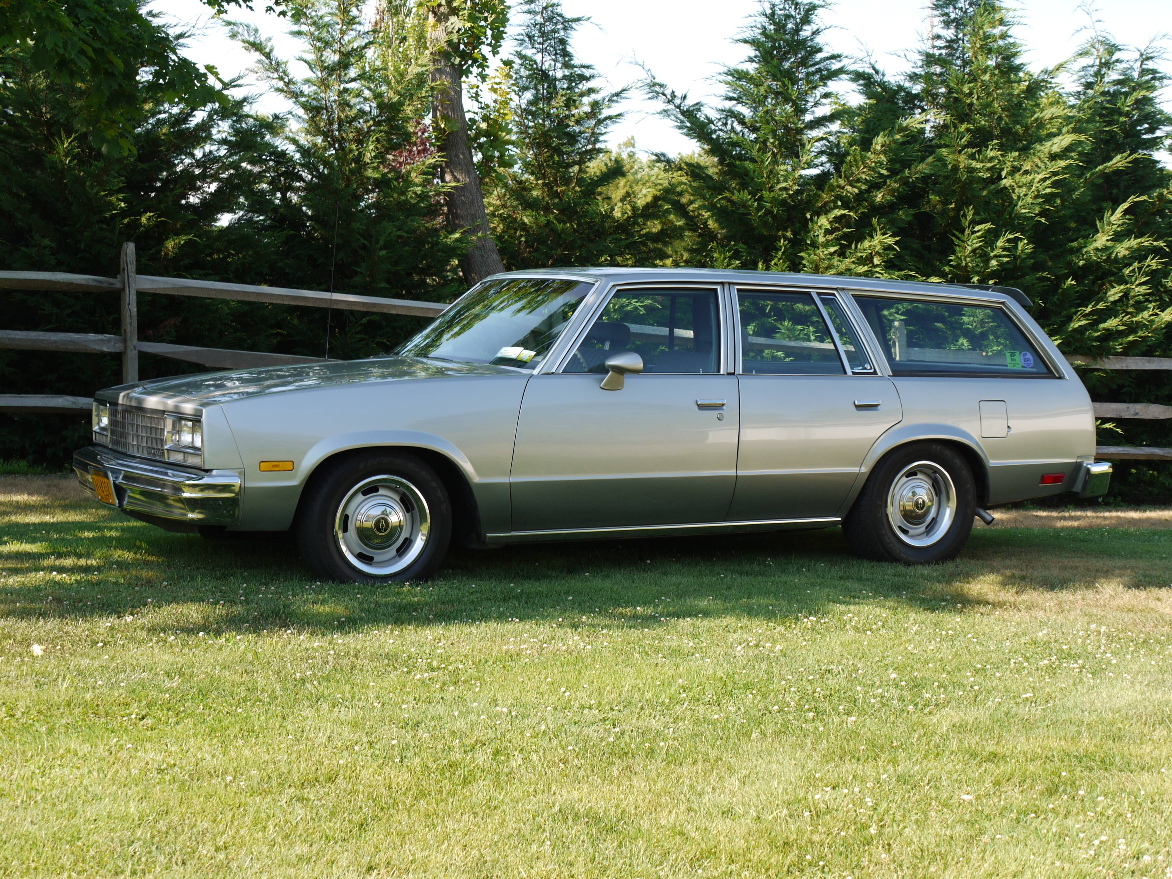

This is how I bought it. At that time both inners had damage from tires rubbing through. I bought it with 205 60 15s on 6" rally wheels in the front and 235s on the back on 7" rallys.
I picked up a set of stock spindles out of an 86 Regal at the yard this morning. To be honest I dont really want to change them but at this point I think its the only way I can go to get the tires and rims that I want. Sucks but it could be worse.

Looks like it sits about the same as mine. I have Hotchkis springs in mine so maybe that’s why it doesn’t rub. I have the same size tire on the front but a 7” wide wheel.
Edit: I do get a slight rub on the sway bar at full lock. I have blazer spindles to put on at some point that should take care of that.
Edit 2: I just checked and I’m running 215/65r15’s on the front
