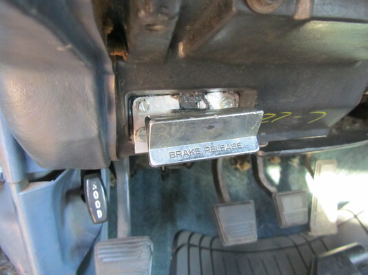

I had to wait until I dragged the Whaler home for winterizing. Now I have room and time to work and the weather was great today. I cut a sheet of aluminum plate to fit that spot, then ground out the hole where the release sits. A combination of sheet metal screws and epoxy secured the aluminum plate to the spot on the dash where it broke off. The release handle pulls out OK, now to wait for it all to harden up. A bit crude, but the knee bolster will hide the ugliness. I can't believe how I still apply the brake out of sheer habit, even knowing the darn thing was busted!!!!!!!!!!!!!!!!!!!!!!!!!!!!!!!!!!!!!!!!!!!!!!!!!!!!!!!!!!!!!!!!!!!!!!!!!!!!!!!!!!!!!!!!!!!!!!!!!!!!!!!!!!!!!!!!!!!!!!!!!!!!!!!!!!!!!!!!!!!!!!!!!!!!!!!!!!!!!!!!!!!!!!!!!!!!!!!!!!!!!!!!!!!!!!!!!! IMG_0727.JPG
