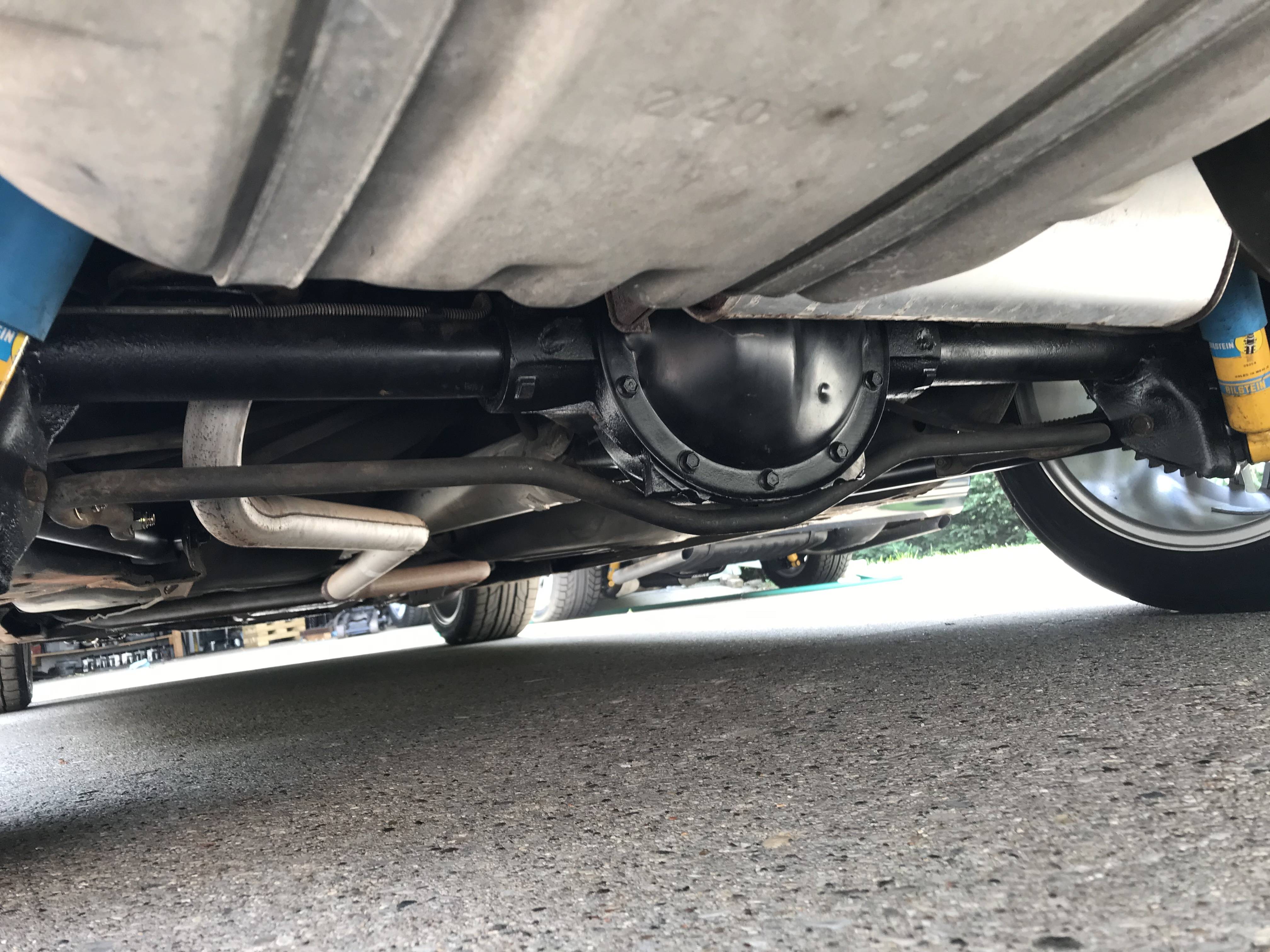

Finally found a home for the 8.5” I picked up about 4 years ago. On and off worked on cleaning it up since getting it (including snapping the cross pin bolt, fun) and after planning on putting it in the wagon last summer I freshened it up, internals looked good to me so just axle bearings, replaced one axle with a better used original one I had, longer studs, and a good wire wheeling. The last couple weeks started the swap, picked up a driveshaft from a 2005 Trailblazer 2wd, snug fit but works. Test run this morning and no loud noises, fell off or leaked so it passes the test. Need to bleed the brakes, the speed bleeders I like to use and bought don’t fit, the new wheel cylinders apparently take a slightly different thread or pitch than stock.
New Ridetech arms in the rear too, sits slightly lower for some reason now as well. I also put on 1/2” spacers on each side after noticing the passenger side rubbed the inner wheelwell very slightly with the 5mm spacers I had been using.
Behaves well with the 3.73’s, can get out of it’s own way a bit better now, I wouldn’t want to take it on the freeway (ok, interstate) but feels good up to 50 or so.

Wasn't planning on it at first, after the rear end swap the rear end dropped a good .5", maybe more, I decided to get Ridetech coilovers in the rear....I guess I'm going for Ridetech sponsorship on this car 😀. Probably the stock arms binding enough to keep that stance, which was about perfect, only thing I can think of. Once the free moving Ridetech arms were in it dropped just enough. Got the coilovers cranked up, not much higher than it was but pretty happy, about even with the front. Will play with the shock valving, only one way adjustable. And due to the coilover change I had to remove the tailpipe for clearance, and found a muffler of the same specs on Walker's website only 4" shorter, got that and a new pipe, an adapter and am back in business with full exhaust, although the connection on the muffler inlet is just a clamp so condensation splatters on my new shiny coilover. First world problems. Not wanting to put any money into this exhaust, for now anyway, and like it quieter.
