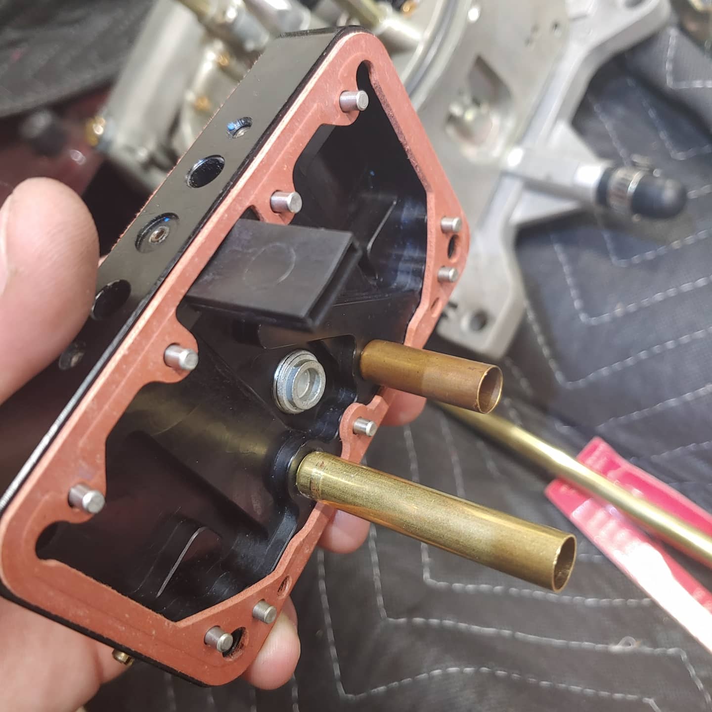

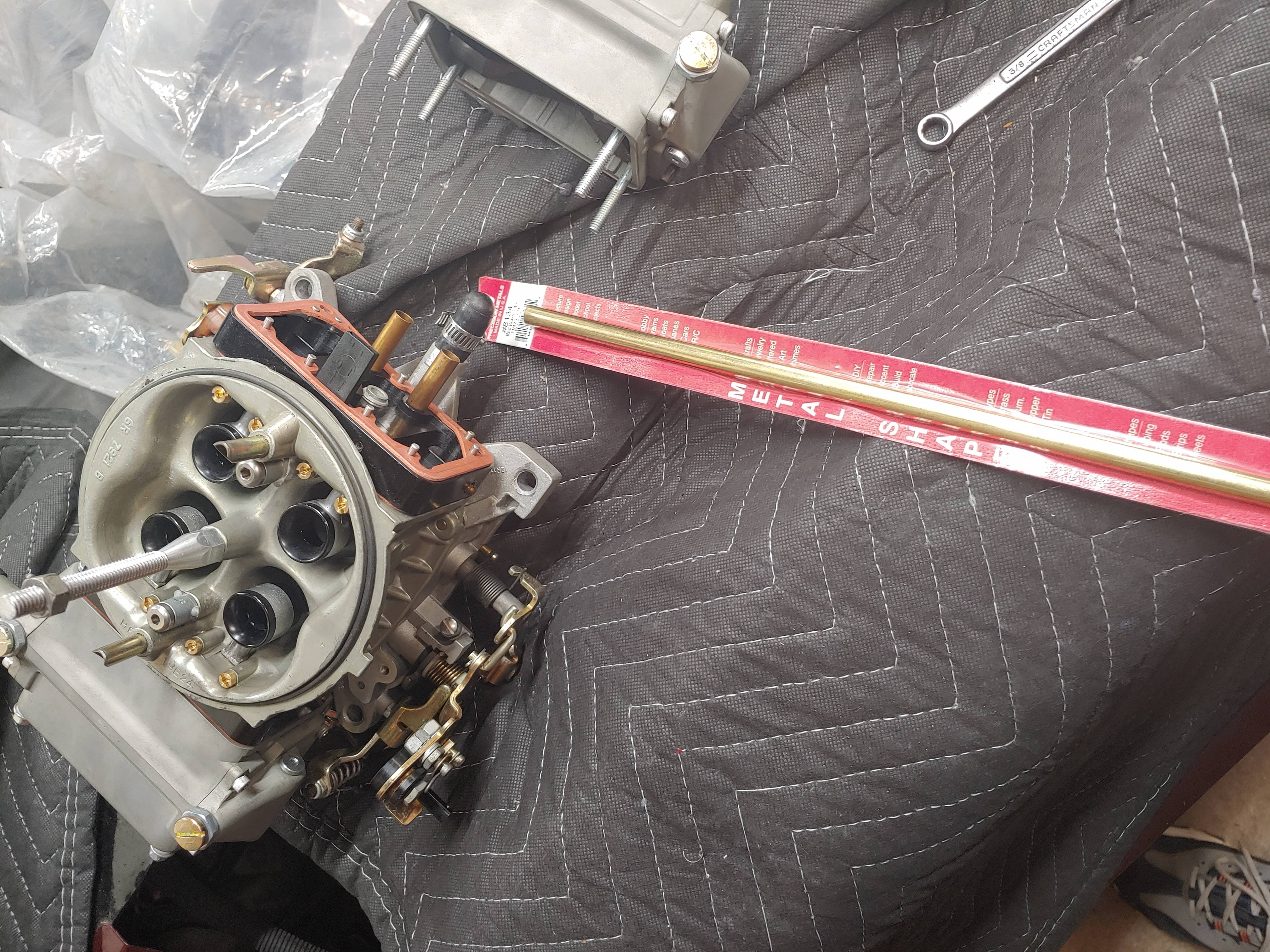

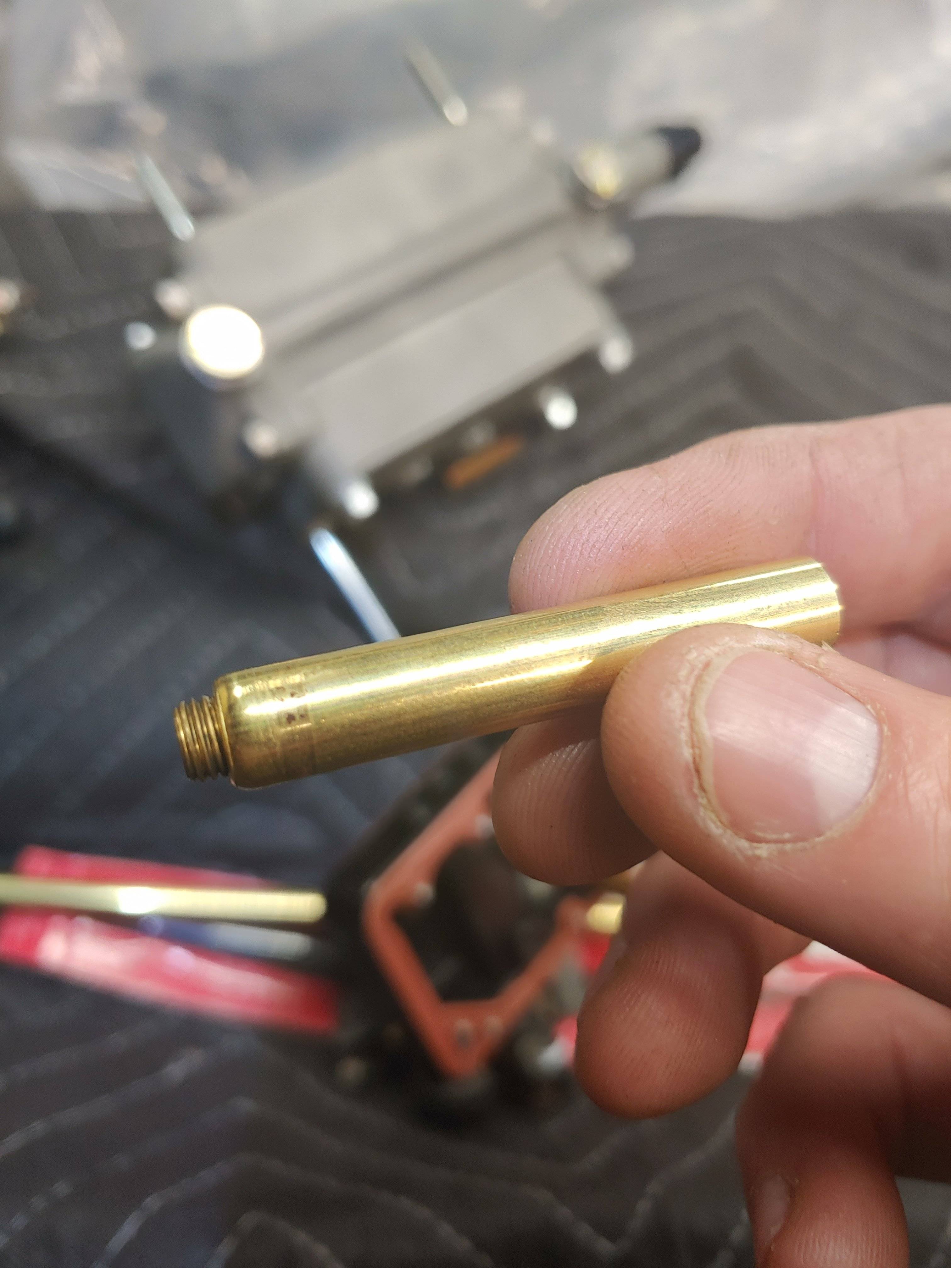

Tech tip for making good jet extensions. Never used thread in jet extensions, they are a restriction. I needed to make custom ones because my dual needle and seat bowls are much bigger than standard holley bowls.
Take some 5/16 I. D. tubing, anything will work as long as the I. D. is 5/16.
Measure what u need
Cut it with a tubing cutter with good pressure so it swedges the end a good bit as it cuts
And there ya go. Perfect jet extension with zero restrictions
