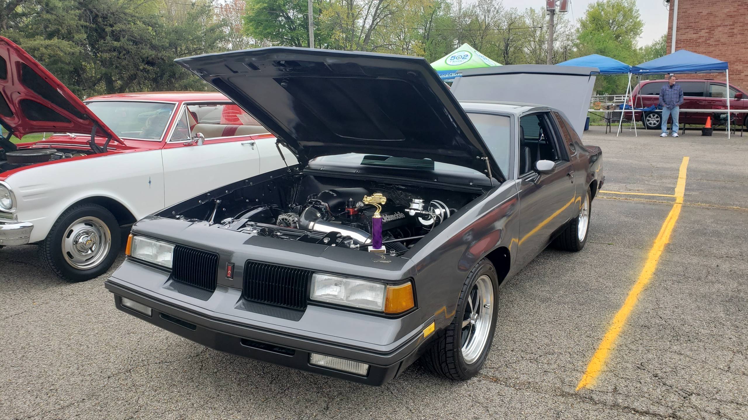

I'm running a 5.3 from a 2000 Silverado. It's cammed, valve springs and some other needed internal upgrades along with a custom converter and 4L80E trans. It's a solid cruiser, gets up to speed quick and I can drive down the highway with ease. I went a bit overkill on mine though to make it look clean.....

I'm running a 5.3 from a 2000 Silverado. It's cammed, valve springs and some other needed internal upgrades along with a custom converter and 4L80E trans. It's a solid cruiser, gets up to speed quick and I can drive down the highway with ease. I went a bit overkill on mine though to make it look clean.....View attachment 173674View attachment 173675View attachment 173676
Looks DOPE! I plan to do some major research before I start spending. I will look into the tread on ls swap. Thanks
