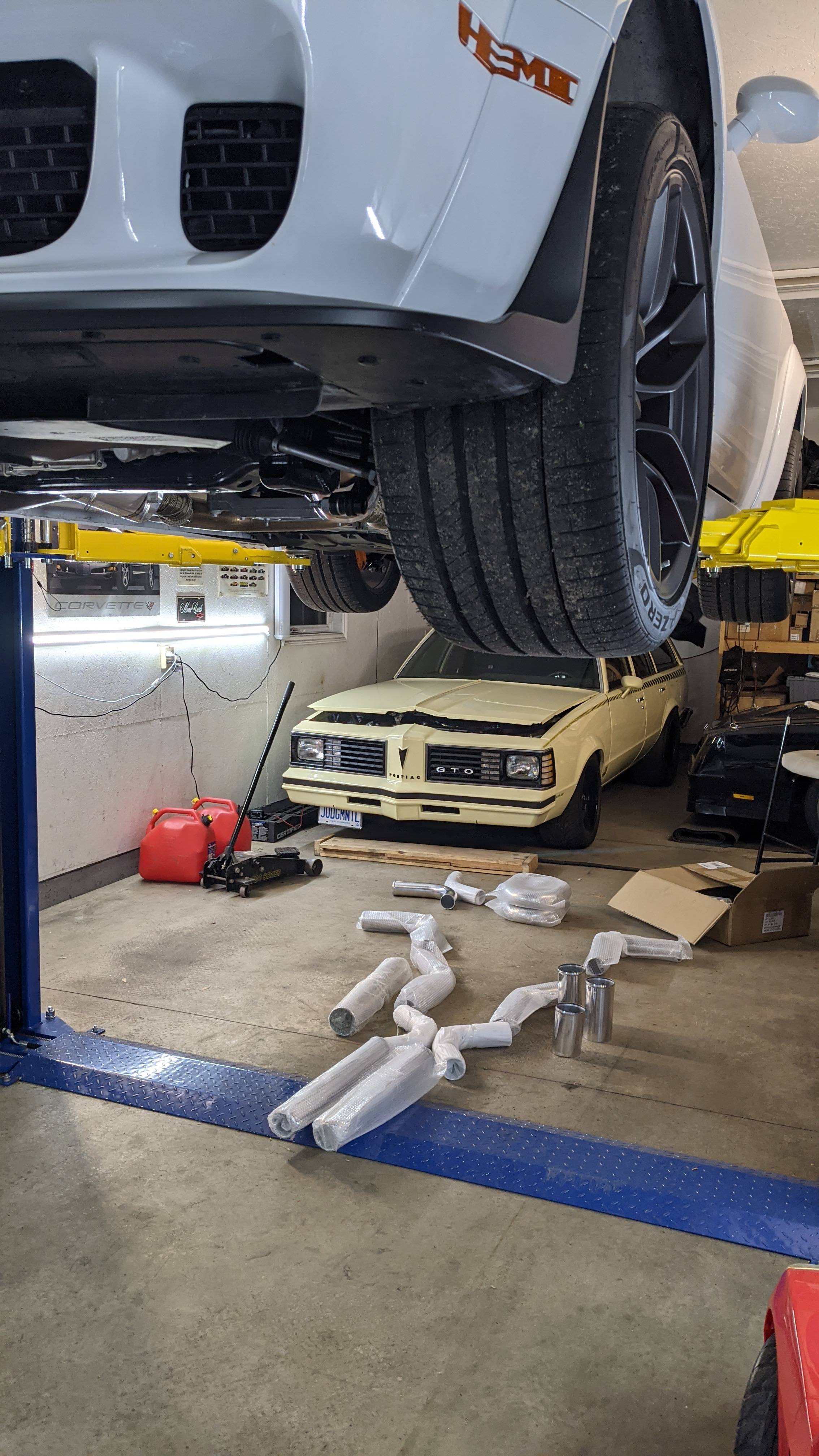

Obviously it is hard to remove weight easily and permanently from these cars. The first step is to not option the crap out of them. The next step is to replace heavy parts with light weight parts. Only one problem - they really don't exist short of mega dollar race pieces.
So what do when you are "poor" and still dissatisfied with the weight? Get creative and do something no one else has (as far as I know) yet.
Build an aluminum exhaust!
And when I say build... I mean build. Most everything exists, but some - lots - of assembly is required. Been sourcing parts from all over - including cooking vendors.
A basic 3" intercooler pipe kit has everything I need for bends and such.

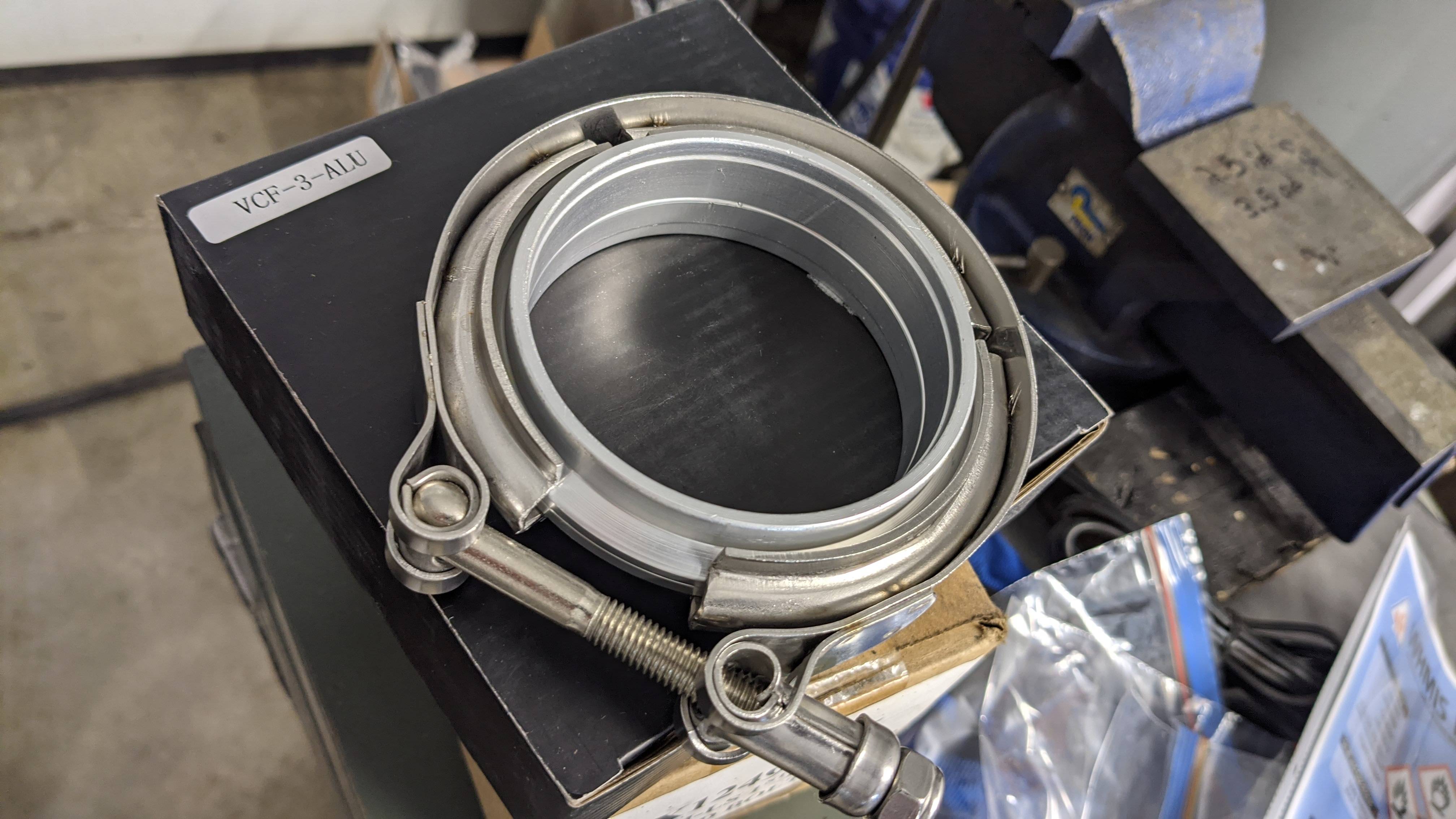

Aluminum v-bands are a thing. These are going to allow me to drop the back half of the exhaust off and use turn downs at the drags.

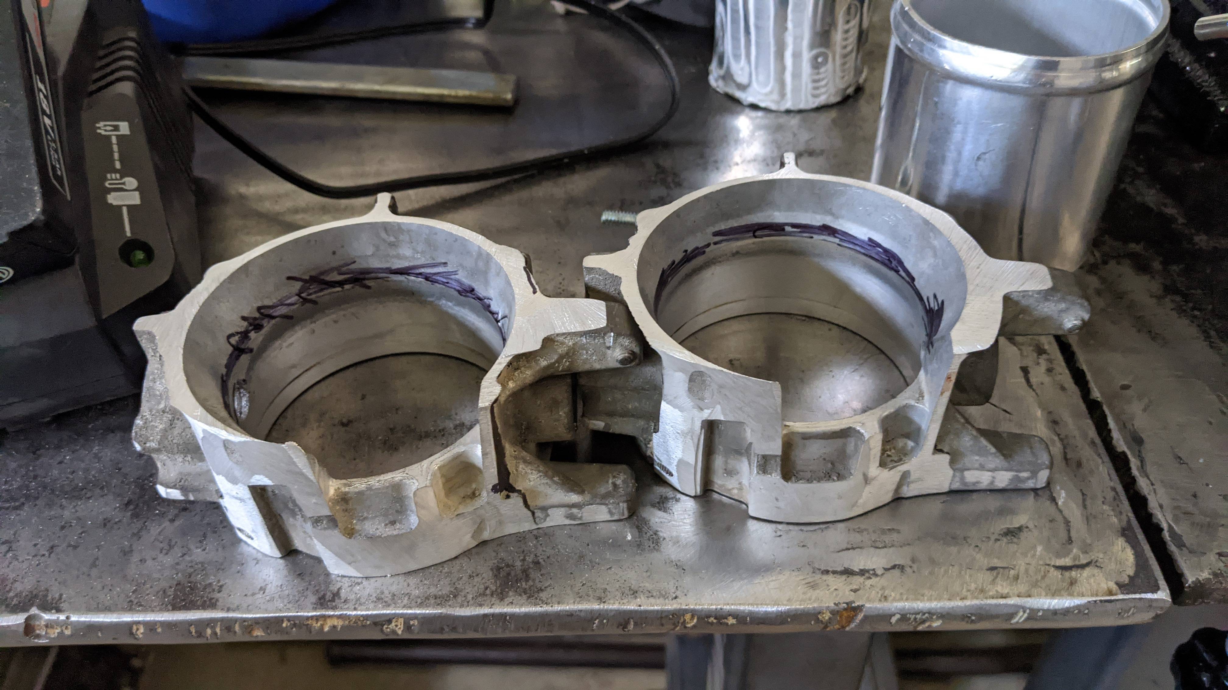

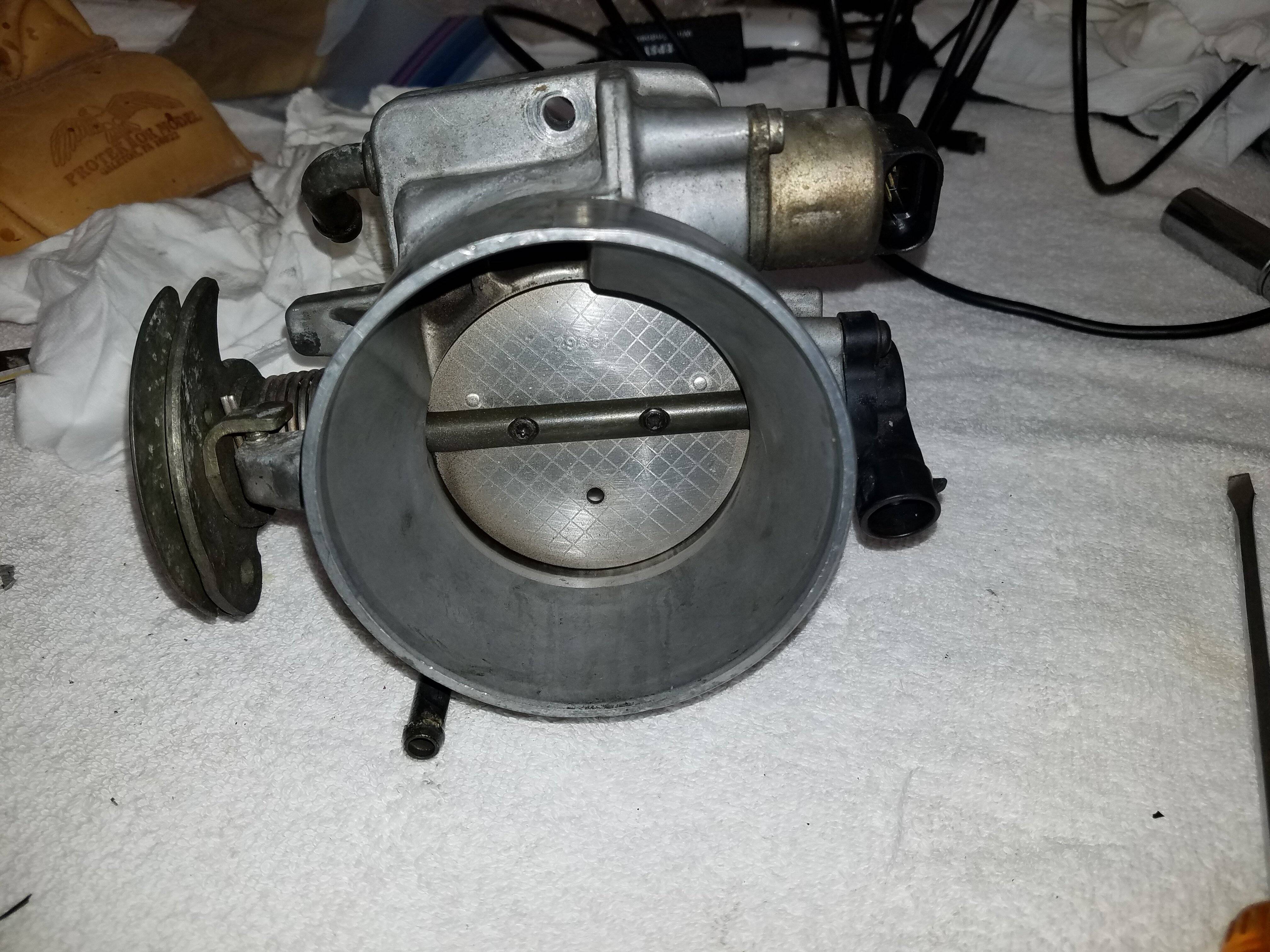

And perhaps the most challenging component is building the active exhaust valves. 3" aluminum butterfly valves aren't really a thing... so I am improvising.

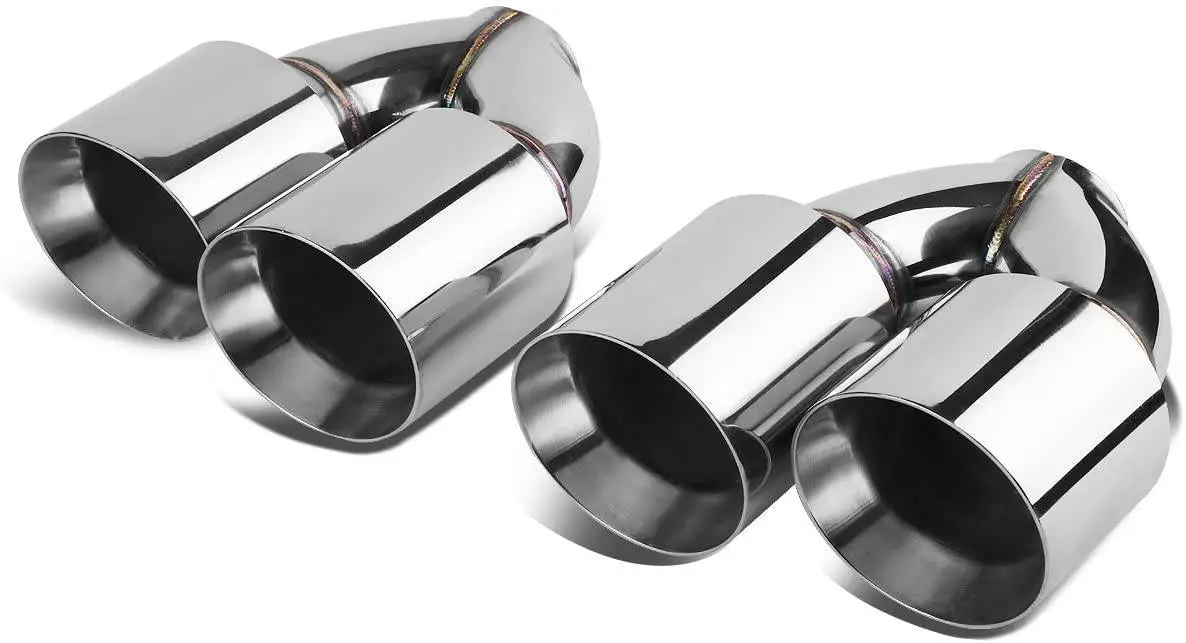

Also, tips.
Sorry, they are stainless.
