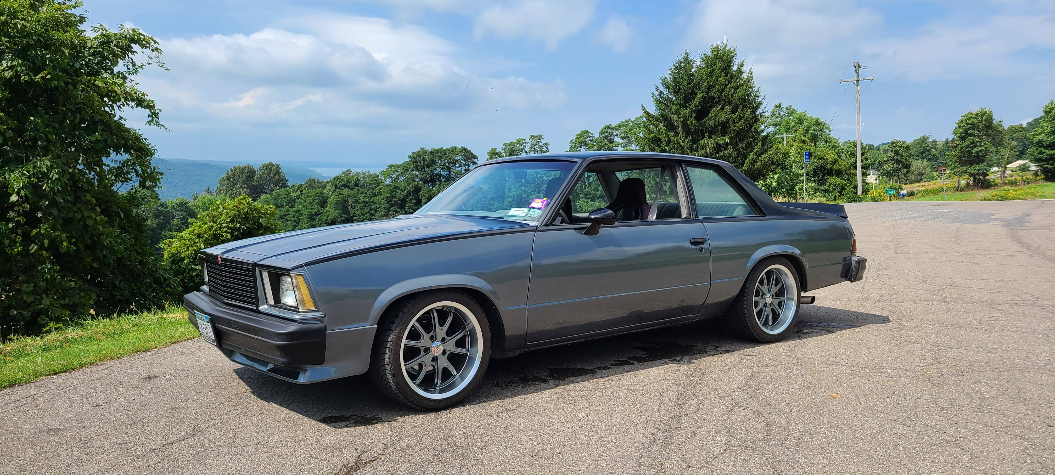

The front of my 81 coupe if kinda high. I used Hotchkis rear springs to lower the rear but I never changed out the fronts. The bottom of the fender lip is almost 28" from the floor on the 81. A drop will help.
