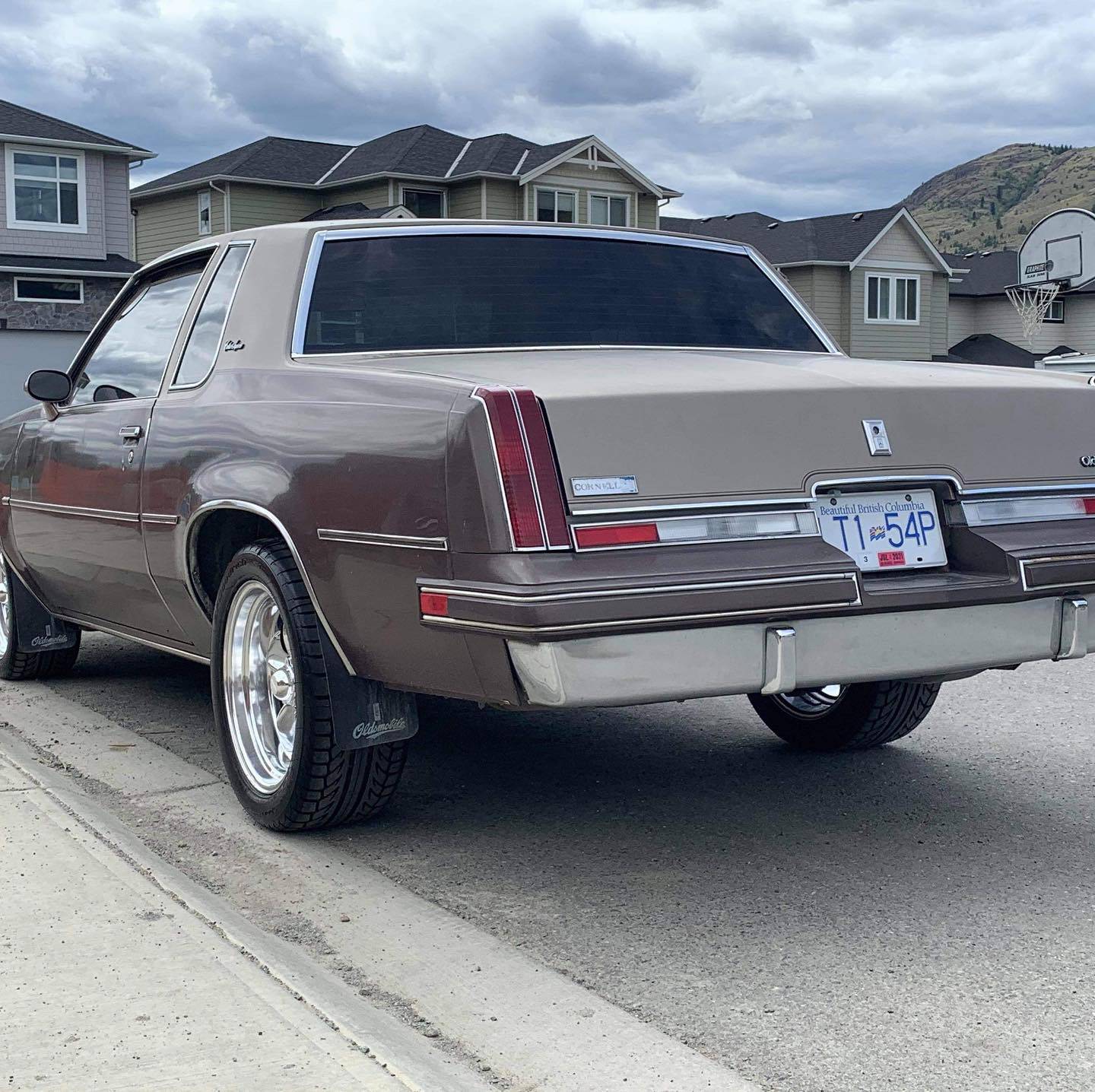

This is the look I want. Something different than the rally wheels.I went back through the thread & still did not see any mention of new/different wheel sizes.

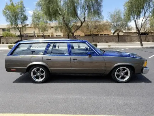

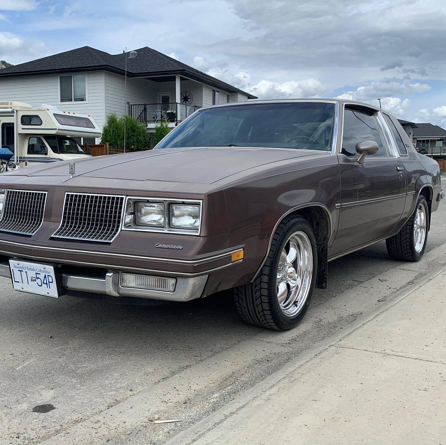

I appreciate the info. Thanks for taking the time trying to help.Mikester- Dude I'm checking out, you're on your own. People have given you options, measurements, pictures , graphs, real world experience and you're still unsure. Sometimes you just have to rip that band aid off and deal with the blood or scar. Best of luck to you.

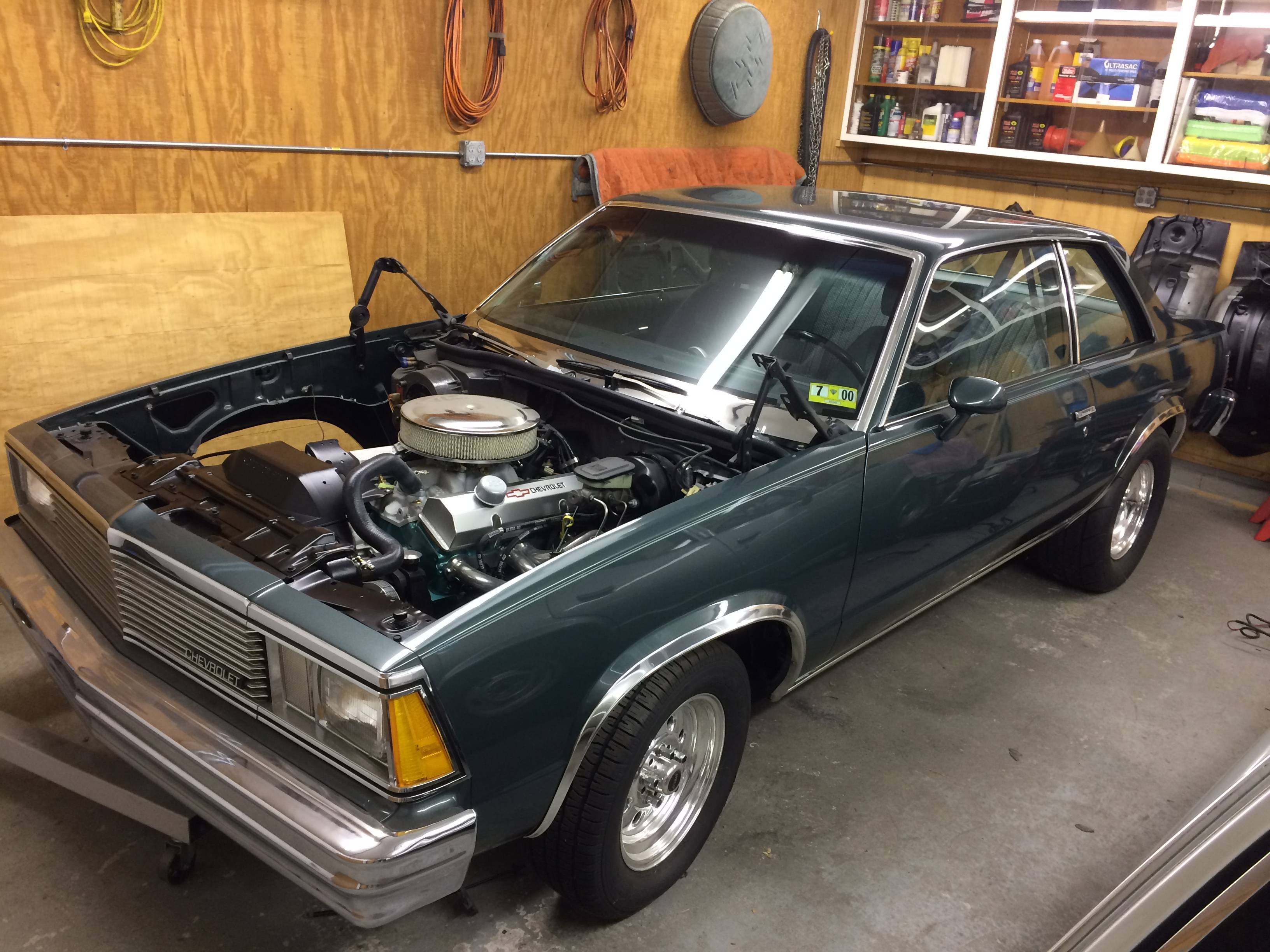

17's ?This is the look I want. Something different than the rally wheels.
I was looking at 17". Prefer staggered tires but the same 17" wheels front and back. Different widths is fine if needed. I ordered the 5660 springs this morning.17's ?

I don’t know if this helps you but my cutlass has 17x8 front and rear with 4 3/4 bs front and 4” bs rear with BFG 245 45 17 front and 255 45 17 lots of room all around , rubs only at full lock passenger side in reverse … probably does it in forward but I don’t hear itI was looking at 17". Prefer staggered tires but the same 17" wheels front and back. Different widths is fine if needed. I ordered the 5660 springs this morning.
I love the look ! Thats what I want for the wagon. I have 275 60 15s with 8" Weld wheels on the back and 215 65 15s with 6" wheels on my 81 Malibu and the fits perfect. I still need to drop the front down a little but the tires look right on that car. I wanted the wagon to have a different style.I don’t know if this helps you but my cutlass has 17x8 front and rear with 4 3/4 bs front and 4” bs rear with BFG 245 45 17 front and 255 45 17 lots of room all around , rubs only at full lock passenger side in reverse … probably does it in forward but I don’t hear it

If it had a little less back space I think you’d be fine .I love the look ! Thats what I want for the wagon. I have 275 60 15s with 8" Weld wheels on the back and 215 65 15s with 6" wheels on my 81 Malibu and the fits perfect. I still need to drop the front down a little but the tires look right on that car. I wanted the wagon to have a different style.
Do you think the same size tire on a 7" wheel in the front would still rub the inner ?
