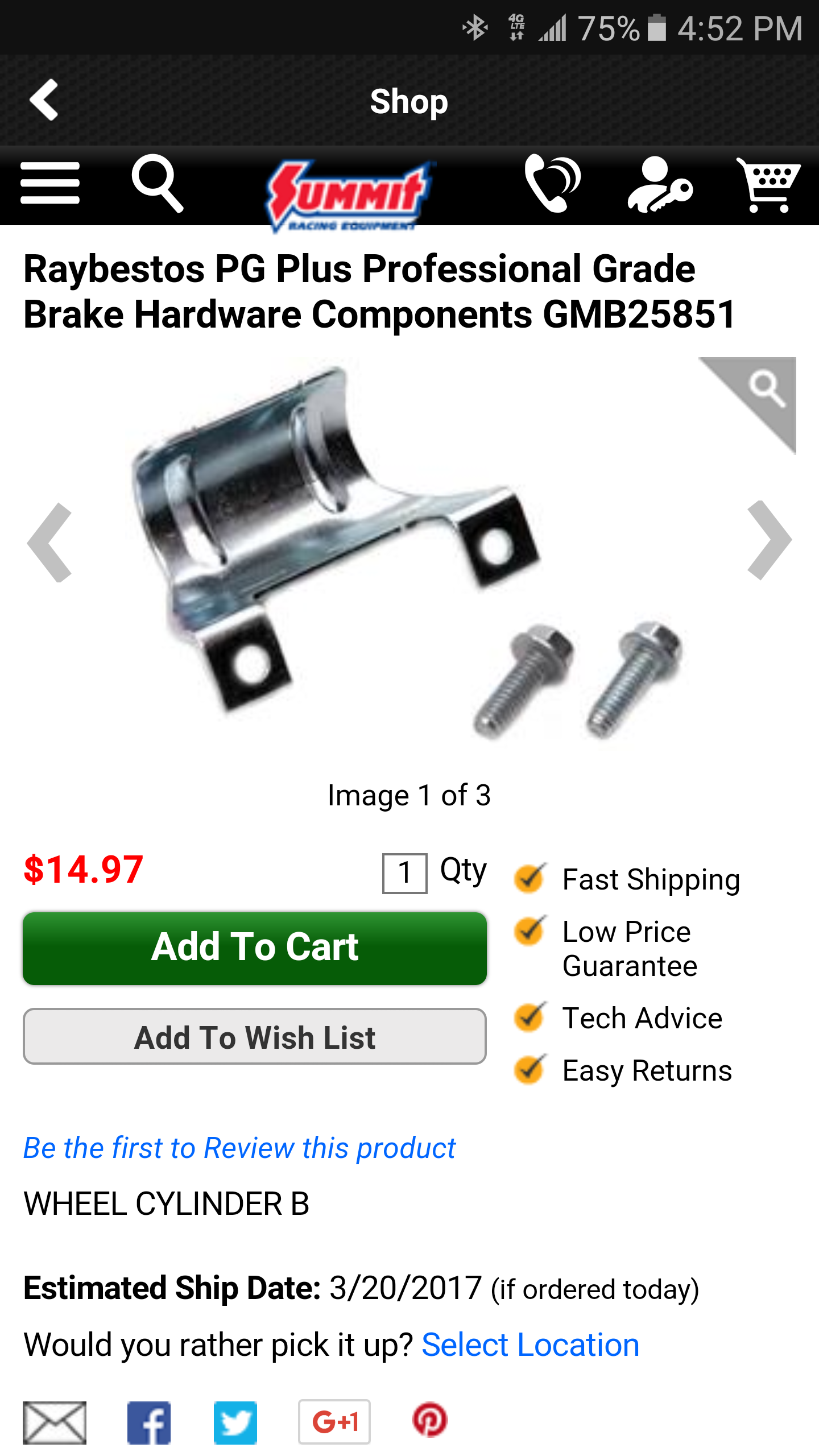

If you are talking about the rear wheel cylinders....yes there is an upgrade. It requires s10 cylinders and the brackets shown in the following pics. I believe you have to drill the axle mounting flange of the rearend as these cylinders bolt in, and do away with the stupid retaining clip.
If you are talking about the rear wheel cylinders....yes there is an upgrade. It requires s10 cylinders and the brackets shown in the following pics. I believe you have to drill the axle mounting flange of the rearend as these cylinders bolt in, and do away with the stupid retaining clip.View attachment 68786 View attachment 68787

All good lol! I have those saved in my wishlist on summit. I snapped the screenshots awhile back to check woth Jared(texas82gp) to make sure they were the right parts.
Lol I have no idea what a screenshot is
