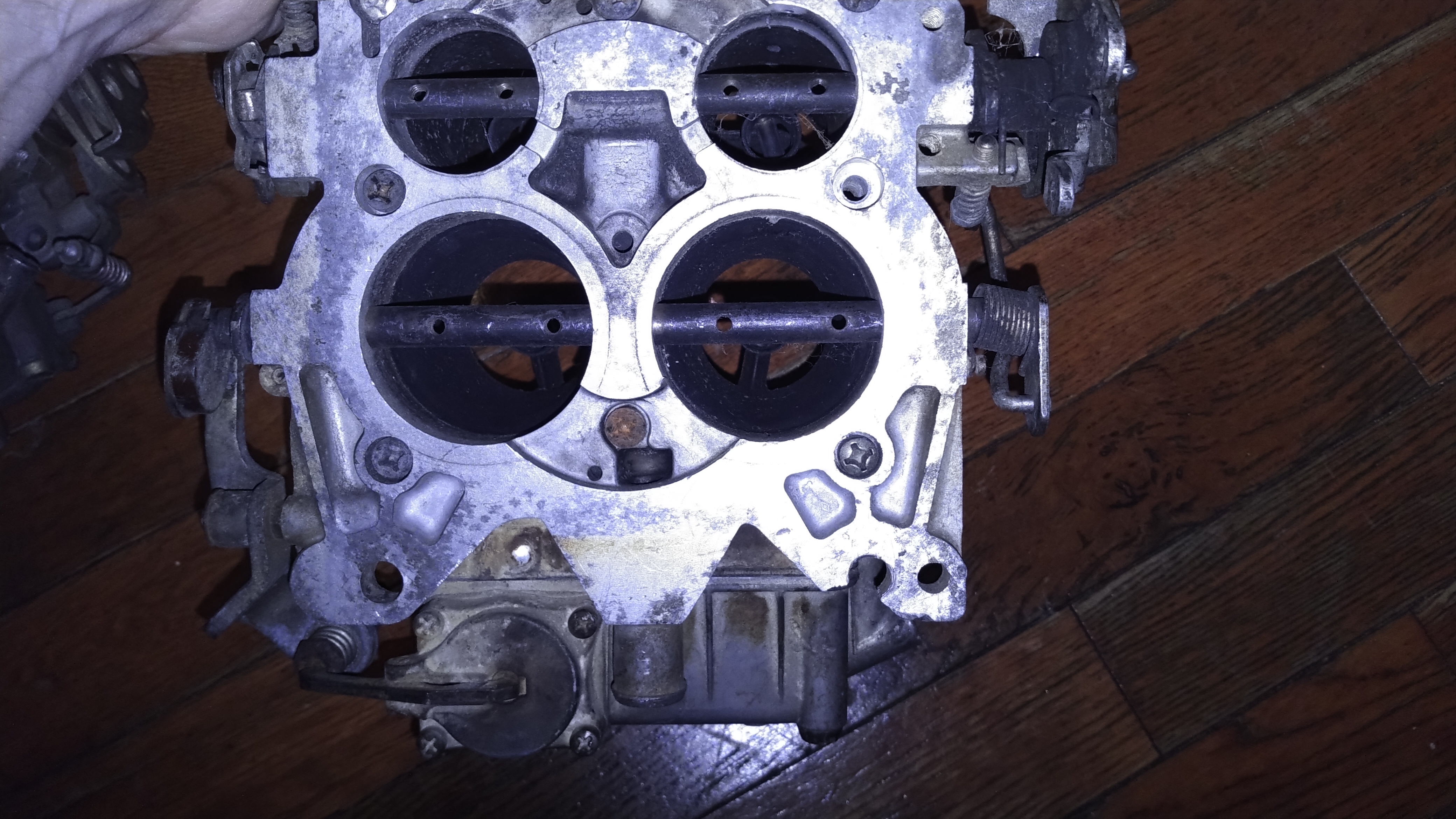

I dug up a Holley spreadbore I bought Manny years ago that looks like it had been dropped...or thrown? And it is one that fits my application.
But like I said it took a hit or 2

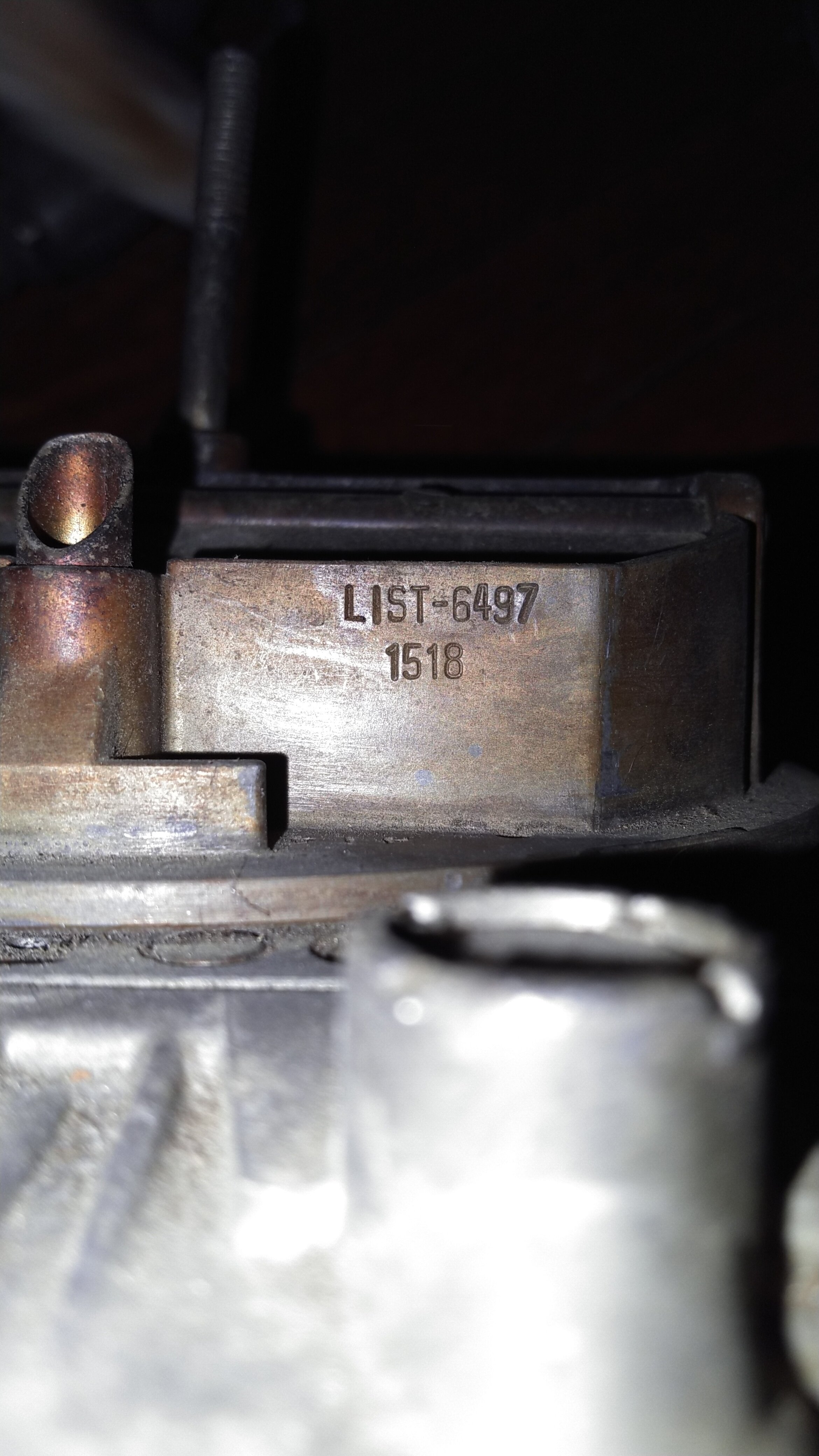

Sometime after buying that one I found this one for free
It has that all too common over tightened issue.

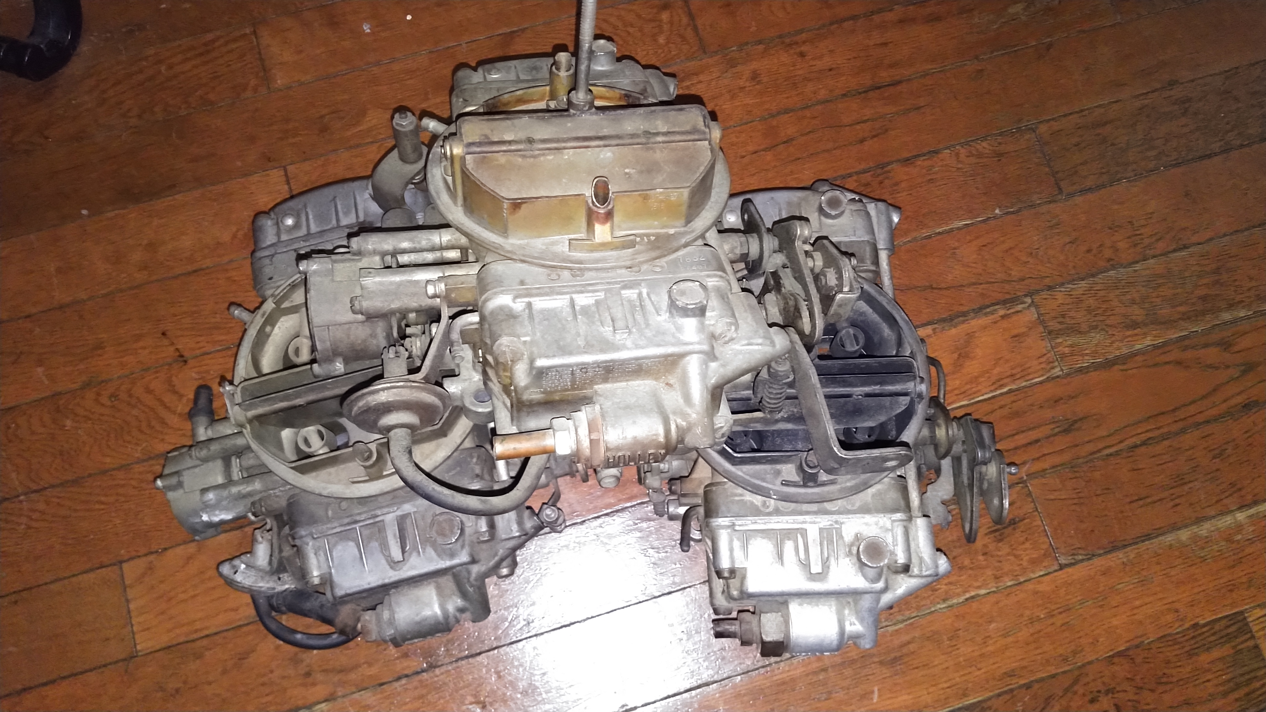

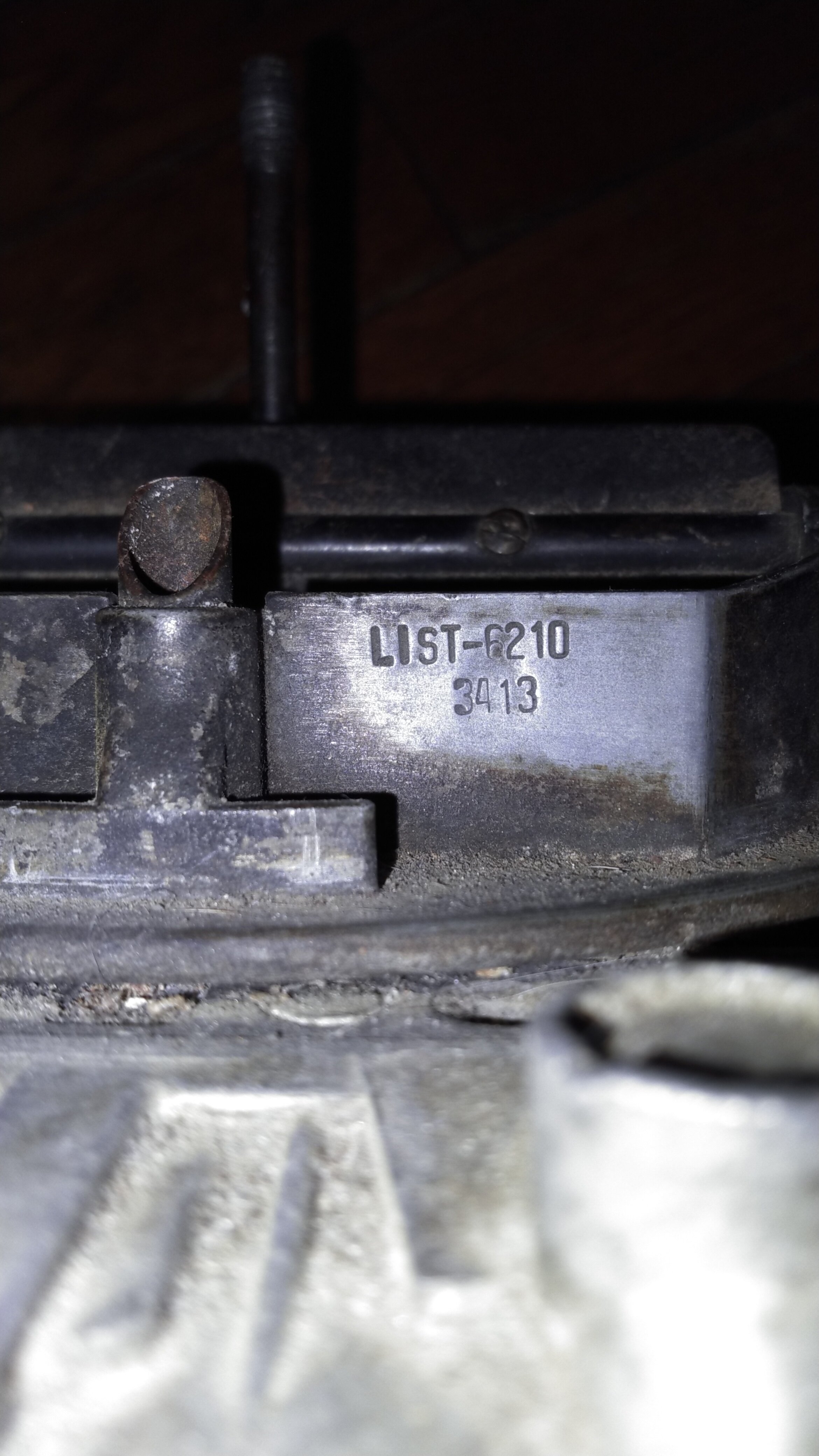

And if course the obvious parting out problem but it was free so it's parts. Now Bach to carb 1 I didn't think I could get the broken shaft for the rear pump out so I went looking for another base plate. Instead I bought this off market place for $50 and picked it up in the bowling alley parking lot around the corner from my house on my way home from work last night.
So from this pile of crap I'm going to make a Holley spreadbore 650 and put it together with non-stick gaskets.
2 of them even have the correct choke set-up. So sitting here writing this I'm deciding what I'm going to do as I go by way of what do I have.
Well the only carb studs I have are to long so with a little more digging I found that purple spread bore carb spacer that came with the free 350 from my brother. I don't have the correct linkage brackets to use on a Holley but with what I have I can bolt it down hook up a fuel line and see if the carb I bought last night works at all as is???? Yeah I think that's what I'm going to do. I mean it can't hurt anything it already runs badly. So now that I've eaten some dinner I think it's time to try a origen unknown Holley 650 spread bore. I don't have high hopes I don't expect it to run at all it's more of a mock up to see what I'll need after a rebuild.

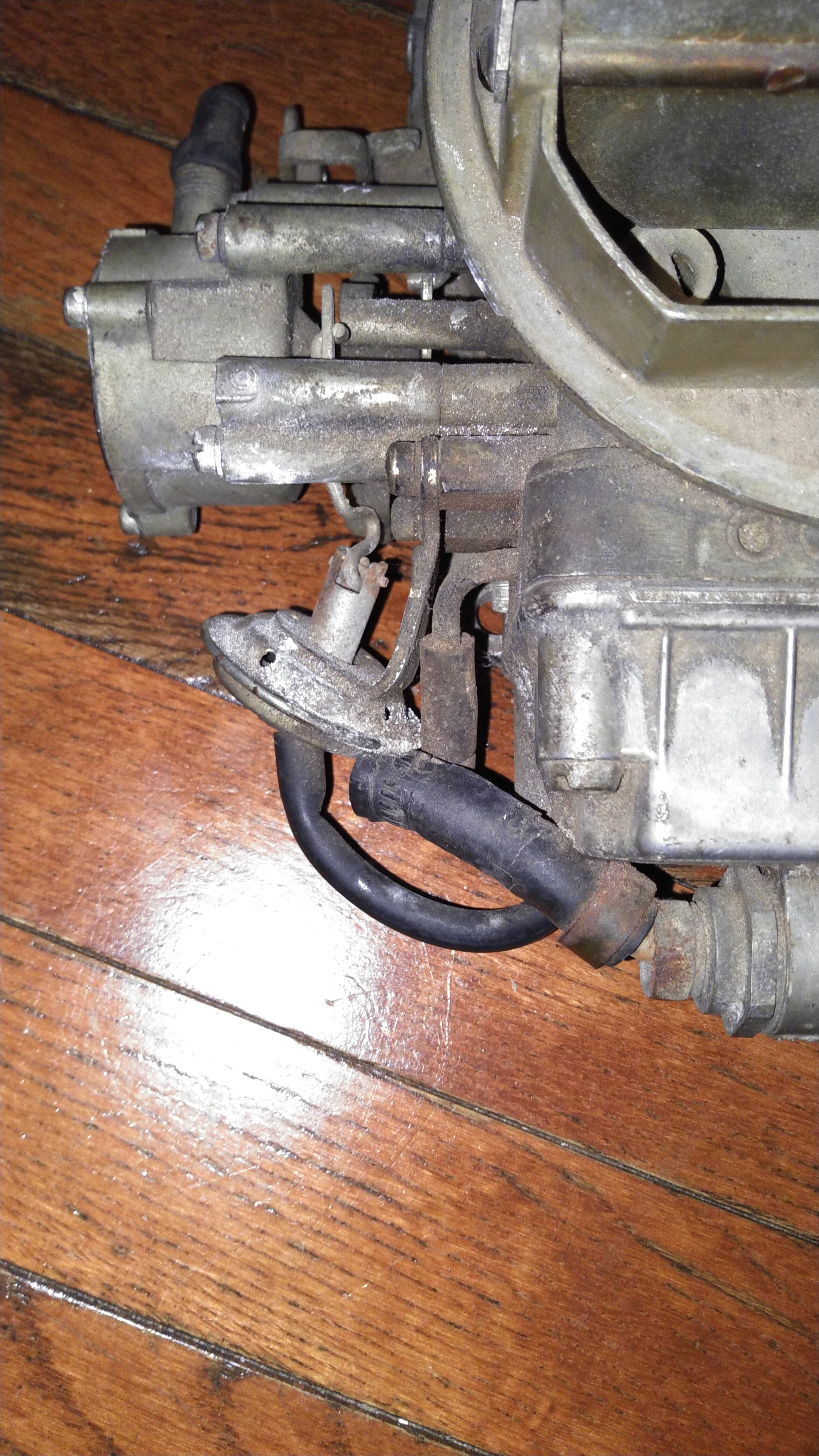

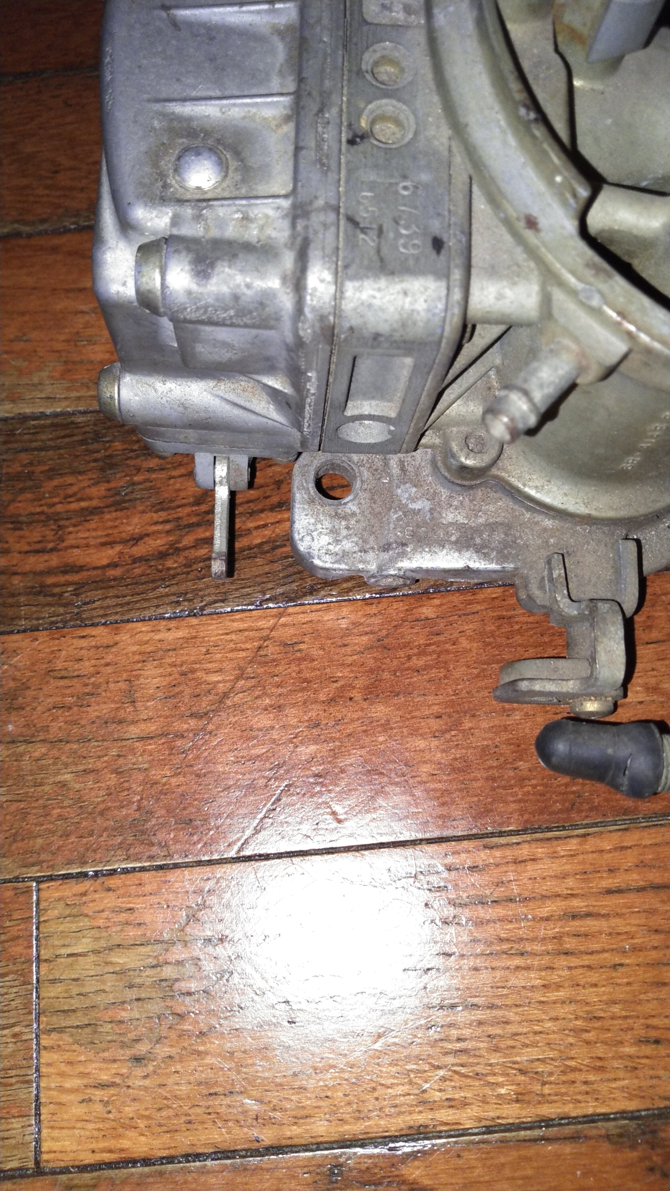

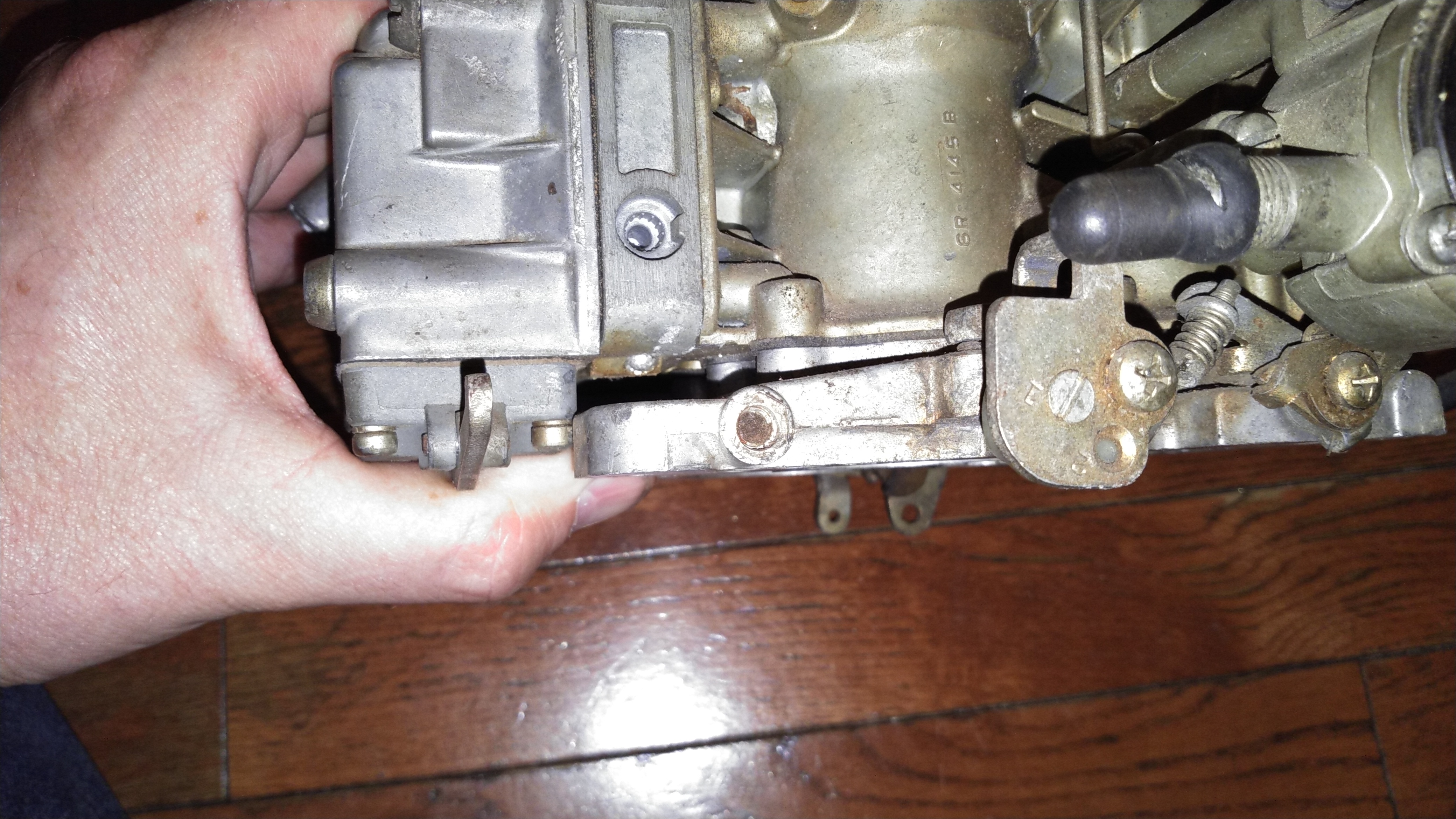

I dug up a Holley spreadbore I bought Manny years ago that looks like it had been dropped...or thrown? And it is one that fits my application.View attachment 221823
View attachment 221824View attachment 221825View attachment 221826
Sometime after buying that one I found this one for freeView attachment 221827
It has that all too common over tightened issue.View attachment 221828
And if course the obvious parting out problem but it was free so it's parts. Now Bach to carb 1 I didn't think I could get the broken shaft for the rear pump out so I went looking for another base plate. Instead I bought this off market place for $50 and picked it up in the bowling alley parking lot around the corner from my house on my way home from work last night.View attachment 221829
So from this pile of crap I'm going to make a Holley spreadbore 650 and put it together with non-stick gaskets. View attachment 221830

Those Holleys are all spread bore they are actually what Holley offered as a direct replacement for a q-jets. I really wanted a known good carb to try but I don't have anything available. The only thing my brother has is out of my reach. W-30 numbers restored never had gas in it that kind of stuff plus he's not big on loaning anything to anyone unless there's something in it for him. Perhaps I should be that way maybe I'd have a running car? The square body carb needs a rebuild and got parked with gas in it so... Not exactly known good I've several unknown carbs off but I don't want to try 30 dirty old carbs that probably won't work anyway. I chose the spread bore Holley because I always found Holleys easy to rebuild and if it does work I'll use it if not I'll put the q-jet back on and sell those spread bore Holleys to someone else all 3 of them. If I could buy an off the shelf carb for this application I probably would have by now but here I am picking at a problem without an answer
