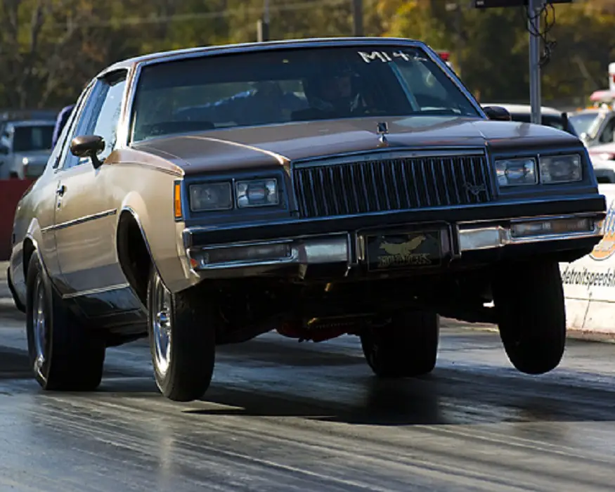

As far as real world experience, here’s mine. I have a GN 8.5 in my SS with 3.73’s, Detroit Locker, Moser axles, rear cover with cap supports, and axle tubes welded to the center section. I’ve had this rear in it for 15 years now with a 406 SBC that I keep hopping up. I drive it pretty hard and usually take it to the track a few times a year, the last couple years leaving on a transbrake with 28x10 slicks then spraying with a 200 shot as soon as I hit 2nd. To date I’ve never had any part of the rearend break on me. Maybe I’m just lucky IDK, just my experience. When the engine gets switched over to the F2 Procharger assisted 406, then it will probably be time to 9” it.
