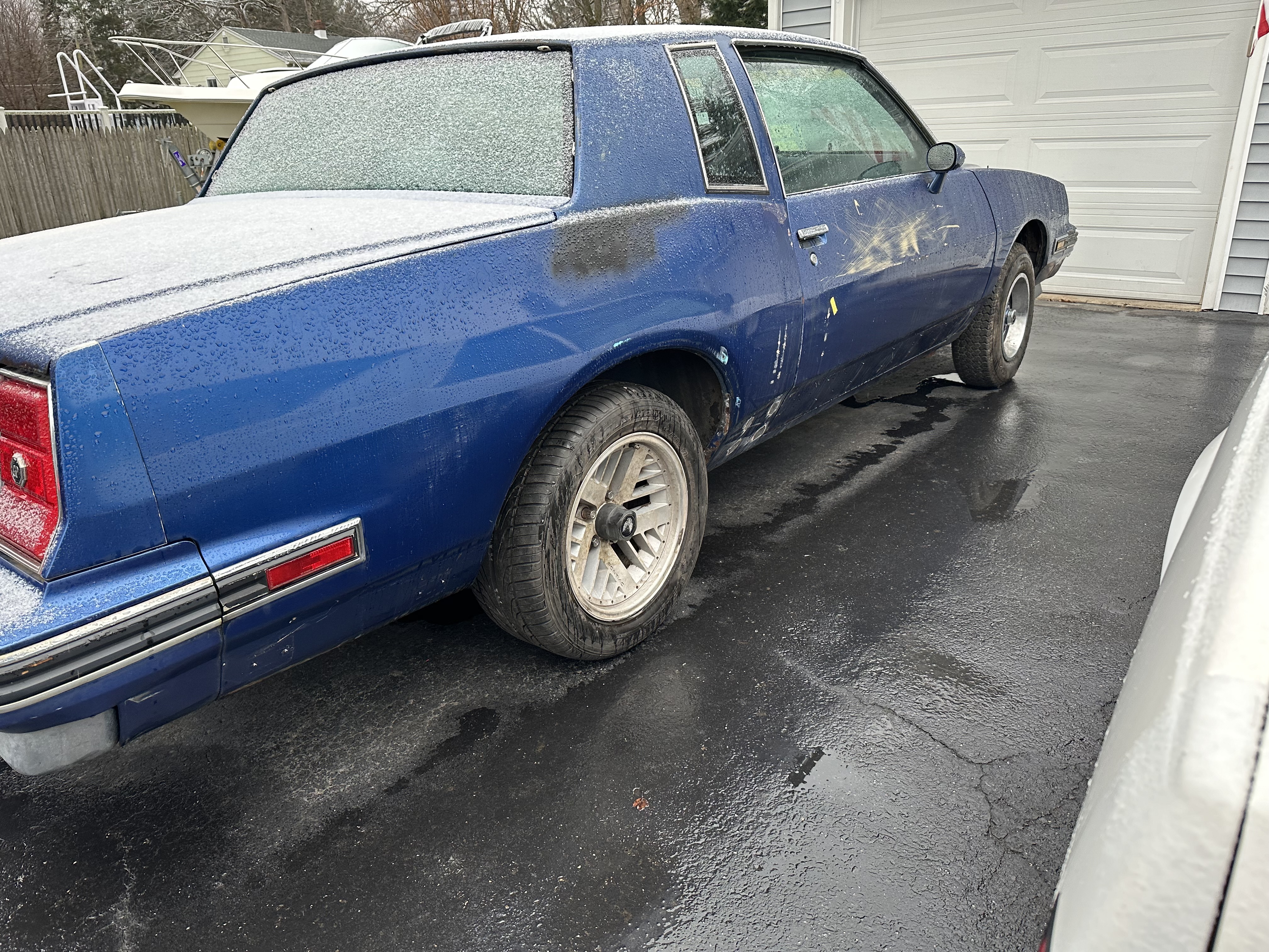

Insurance is on. Wish I didn’t have to work late tonight, so I could finish up under the hood. I want to drive it.
Also needs a serious altitude adjustment once I get the full set of wheels on.

I topped off the trans today and I ran it back and forth in the driveway, seems strong from a stop. Unfortunately I have a bit of an oil leak, that’s a little bit too large to ignore. Back in the garage tomorrow night to hopefully fix whatever it is. 62 vette is being dropped off Saturday am. I was hoping this car would be squared away before.
I got the timing set today and took the car for a little ride. I have brakes and all three gears. Have a little bit of an oil leak so I’ll have to get the car in the air and take a look. Unfortunately I also got the 62 Vette today, so the GP is on the back burner.

So I what I thought was a little leak, is a pretty major one. I thought that it was just a loose valve cover. Turns out to be the oil pan around the dipstick. I put a nice one piece gasket in, but something sure didn’t seal right. Had to walk away from the car tonight.
Progress has pretty much ground to a halt. I wasn’t able to get the leak handled. It seems to be where the dipstick goes into the pan, but that could just be where it’s finally dripping off of. In a couple weeks, when it warms up, I’ll get a better look.
The car got pushed outside for the 62 corvette project I took on. Progress on that has been slower than I’d like, as I’ve been preoccupied or sick the past 3 weekends, and my friends painter retired, so I’ve been helping him out in the shop. I finally put some time in on the vette yesterday, and I’ll do some more today and tomorrow. I was hoping 2 months max on this car and I’m already one in. Quite a ways away from the goal, but it’s getting there.
