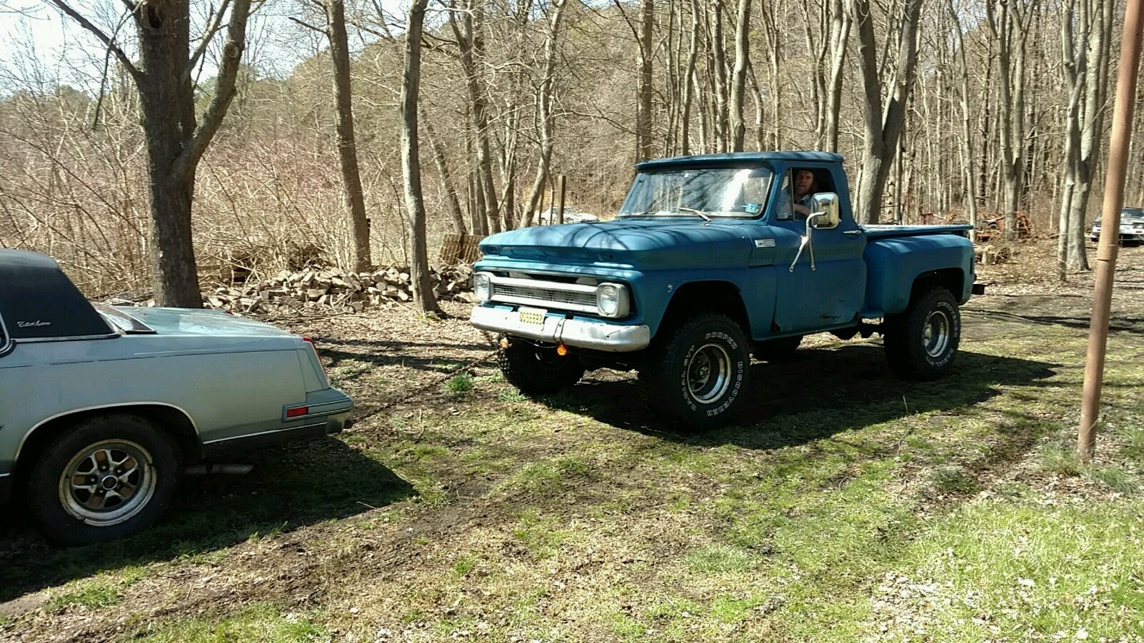

and this is her now sadly I don't have time for her now but I have a feeling that I'm going to make time
at least to make her run and drive again note the chain in this picture
