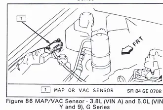

Just to make sure of something...assuming your VAC sensor on the passenger side fender well (behind the coolant overflow tank) is the orignal or if it was swapped out with a new one, it's an actual VAC (aka D/P) sensor and not a MAP sensor? If you're not getting a code, it's probably ok. Just asking. If they were swapped up, they do the opposite on voltage sensing so you would sure as heck get a code thrown.
