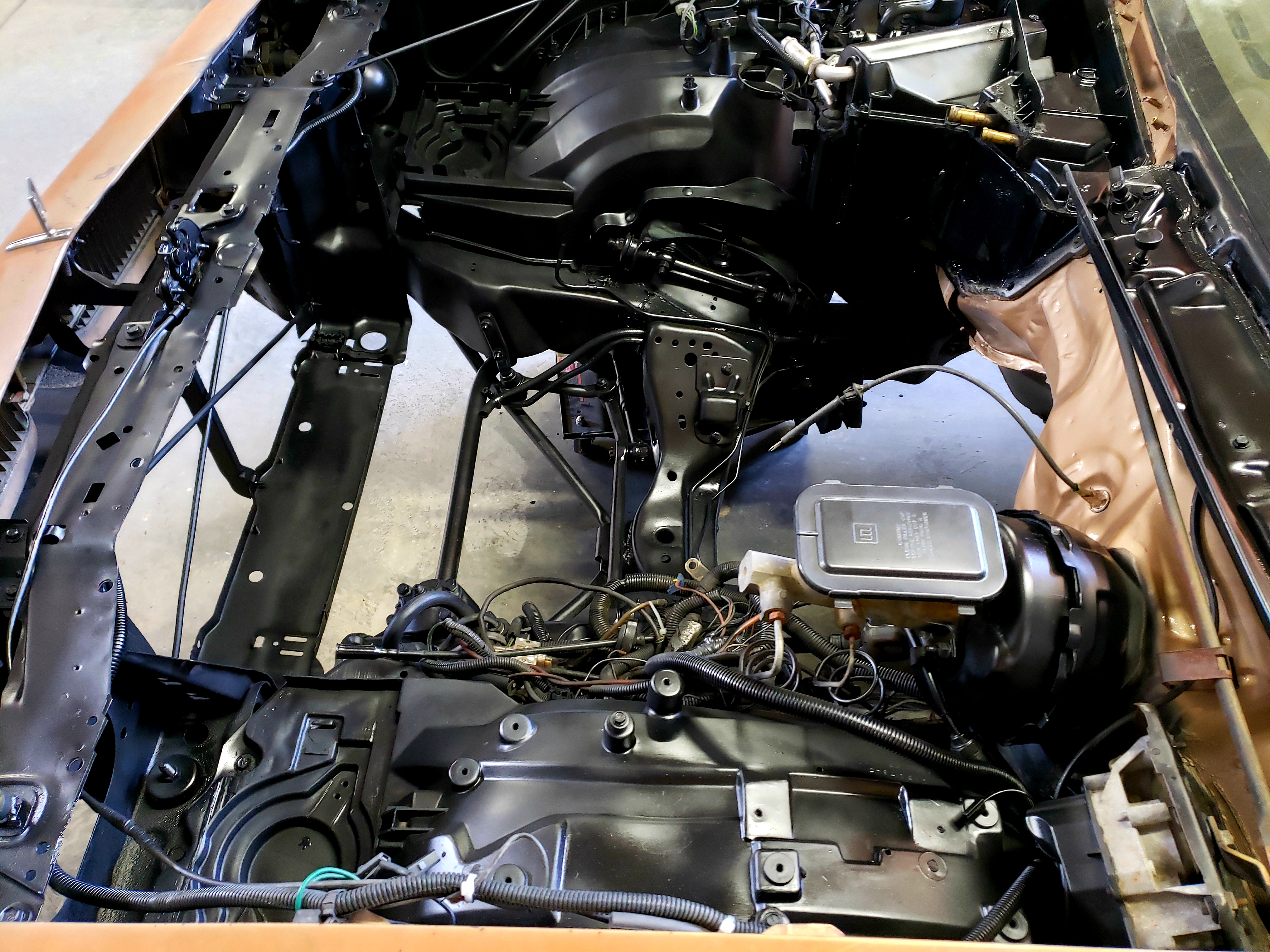

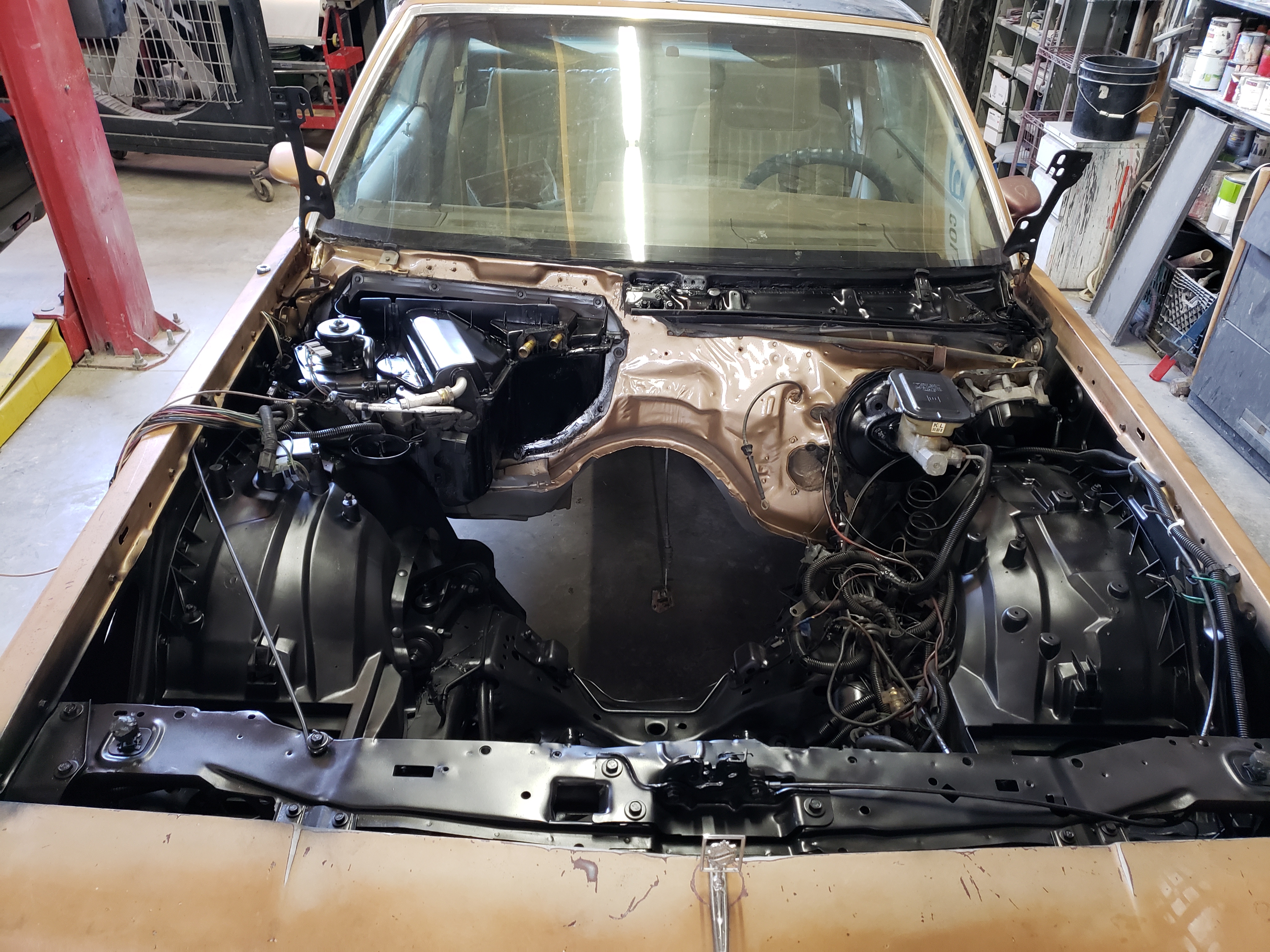

Another coat on the engine bay and she looks gorgeous 20190824_113501.jpg 20190824_103012.jpg 20190824_112757.jpg

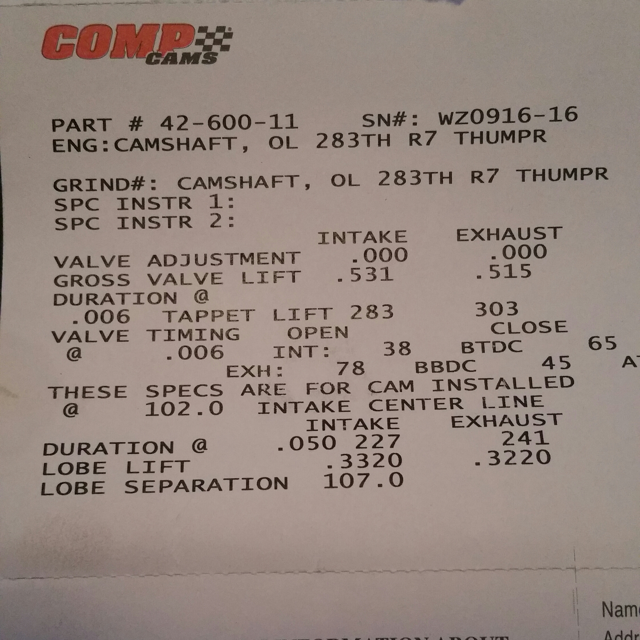

It should work fine, what cam are you running? My 2200 to 2500 stalls flashes at 2300 stall, worked nicely with the 3.42 gears.
Oct 14, 2008
8,825
7,777
Melville,Saskatchewan
I would think with that cam and those heads, you will be pushing the converter to the high end of it's stall. What is the compression ratio?
