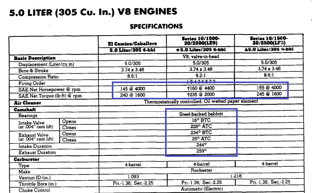

Truck engines commonly have cams ground for more torque besides intakes with longer runners. Big thing is truck engines often had more lax emissions gear compared to cars. Basically trucks have less strict regulations so they can burn dirter than a car of the same year. Its partly why most manufacturers mainly make truck based vehicles in the US anymore, the emissions are easier along with more lax MPG requirements.
80s GM trucks don't have CCC, not even in the US while GM cars did. The trucks had a weird dual stage accerator pump instead of a M/C solenoid and TPS found in cars. They probably don't want people converting their cars from a stricter car emissions setup to a more lax truck emissions setup.

p13-14
p56 has a reference to ElCamino models (in the truck pdf)
p60 engines, engine specs starting on p64
p80 LG4 305ci specs
p83 ..... the compression ratios are different in at least 1 case

I kind of suspect that the V6 engines may burn dirter than the V8s. When I swapped the Buick V6 out for the Chevy 305, I noticed the V6 used a much longer cat converter than the V8. This suggests the V6 needed more converter to clean its exhaust than the V8. However, it could also be the carbs as 2 bbls are a compromise design. The Dualjet barrels are larger than the primaries of a Qjet. Its been said that Qjets are actually more gas efficient than a Dualjet if you keep the secondaries closed. This is due to the primaries being smaller and more efficient for low speed operation. Dual jets sacrifice a little low end to improve their top end a little with its 2 bores.
