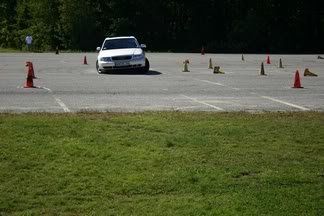

I have only done it a few times. Not in the cutlass but in my Audi. It is fun but put a lot of strain on the car.
Fun times
