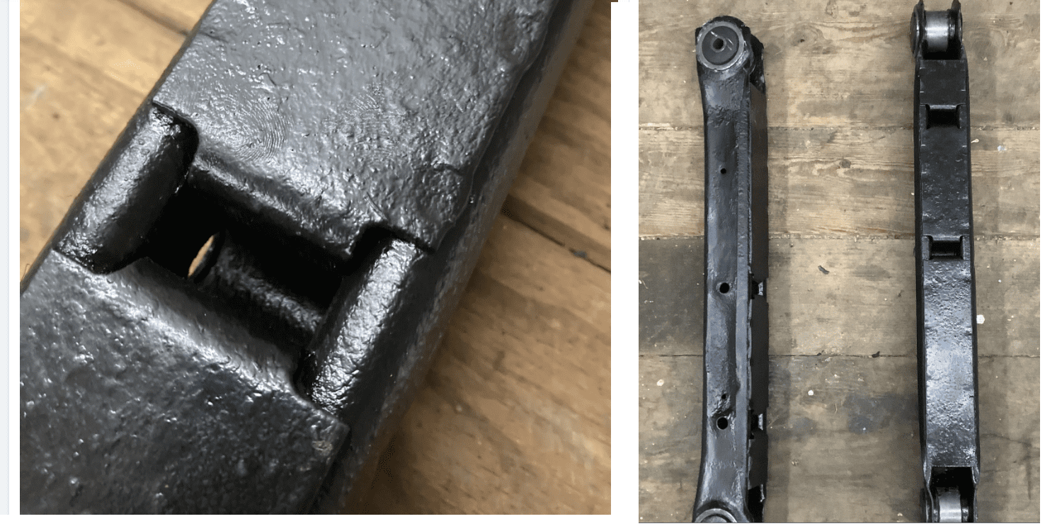

someone posted the pics below of their rear lower control arms from their El Camino after replacing bushings and repainting. the question came up, are these original on some G-bodys from the factory? looking at them, I think someone did it aftermarket with a kit and a spotwelder, or had a shop do it.
does anyone know if any G-body came with boxed Lower Control Arms? thanks!

Theses are for '64-'72 A-bodies with rear sway bar. '78-'88 never had boxed arms, just the insert for the rear sway bar.

Stock g body rear LCAs were unboxed to allow them to flex and prevent binding. Boxing the stock arms will increase suspension bind, as will the use of poly bushings.

64-72 was boxed in the higher hp cars and the F-41 suspension package. My 70 SS 396 has them, but my 70 Malibu did not. You can buy the factory boxing piece and add it as you described. I would be curious about the difference in length if the 64-72 would fit the 78-88. It may set the rear back a little and then use adjustable uppers to get the pinion angle right. Only asking because I could put the 70 bars in the Malibu and upgrade the 70. Hate to admit it, my priority is the 70 restoration, and the leftovers are going in the Malibu. Like the 468 in the Chevelle right now is slated for the Malibu in the future, along with the headers and converter out of the 70 as that gets replaced in the Chevelle.

The lowers are different. The interchange is '64-'72 only, '73-'77 only, '78-'88 only. As noted only they F41 & most hipo cars had them. With the El Camino/Caballero, they did have the F41 as an option so they did rear sway bars.

G-body LCA is 19.25" center to center. A-body LCA is 22" center to center. Not sure about the bushings.

64-72 are 22" center to center on the bushing holes. 24 3/4 OAL. Bolts are 7/16 14 X 3 1/2 and flange head 3 3/4 with prevailing torque nuts. El Caminos and 71-2 Sprints did not come with sway bars because of the air shocks had a tin shield that was in the way of the sway bar. No picture of the tin shield since all my cars have sway bars. The 72 Sprint is from A 68 Le Mans and the 67 is from a 72 Cutlass.
The fully boxed arms are rare big engine HP 4 speeds I have never seen a factory one like that, The standard f-41 is basically the same insert like the g bodies use to keep from crushing the control arm.
73-77 mount to the bottom of the LCA and have boxes to provide the mount location.
G bodies went back to the 64-72 design but are shorter.
