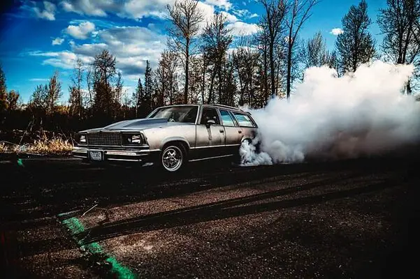

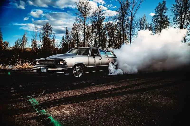

New member here! Sorry if I am hijacking a thread, but I inherited a pair of 15x10 with 4.5 inch backspace. What is the chances that a 295/50-15 will fit? All stock rear end and suspension on 78 malibu wagon.

4.50" BS with push the tire out of the wheel well.

The Ideal offset in back on a G-body without a frame notch is around -.400" or -10mm
That would make the ideal BS for a 10" wheel 5" + .3" (to convert from offset to BS) -.4" or 4.9" - call it 5". With 5.5" BS you could add shim spacers to just keep the tire off the frame for max lip clearance.
4.5" BS would be giving up almost a 1/2" at the frame.
