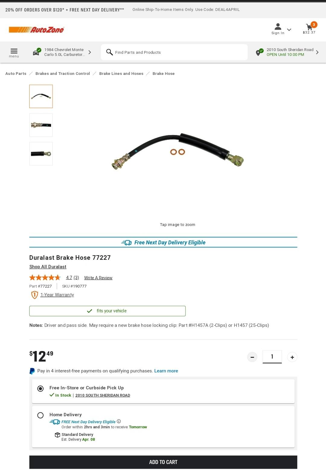

Now...how can I repair this or do I need to replace this hose ?
If i need to replace the hose, how do I remove it and install it...never messed around with brake hoses/lines before.

Well at least the part is cheap...👍🏾
Any good reference videos of removing and installing one of these I should be looking at ?

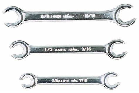

You need to use flare nut wrenches on the tubing side. This nut is easy to strip. Picture is for reference only wrenches are metric for your car.
Should those flare wrenches be standard or metric ?
What exact wrench sizes do I need ?
