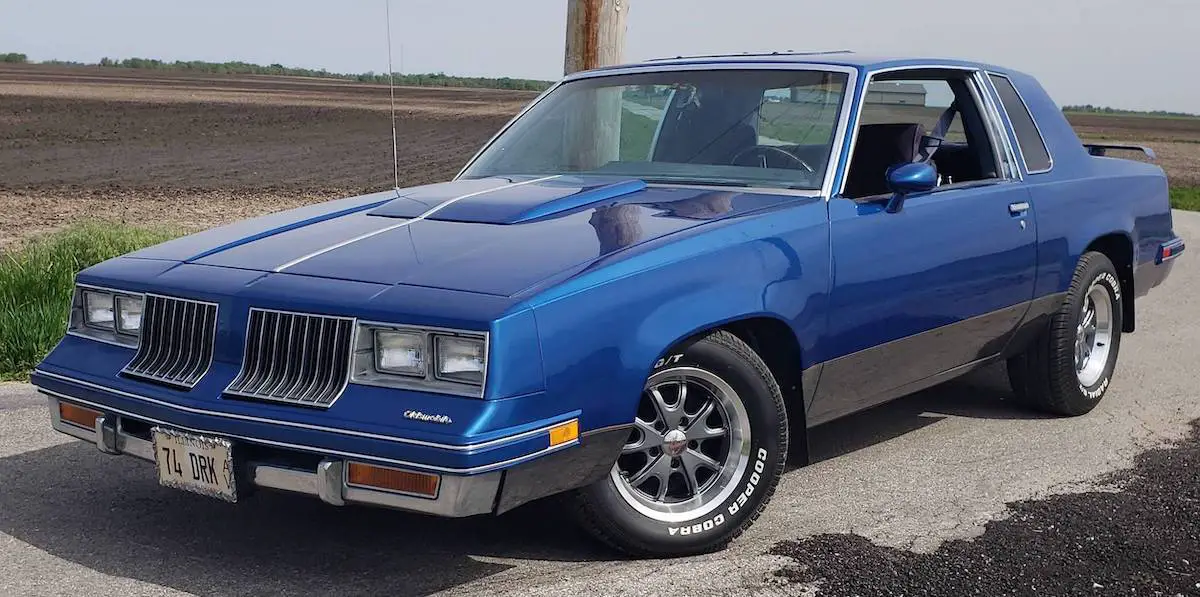

Congratulations and love the hue of blue. What is on the bottom? Paint or smoked chrome veneer/sticker? I would like to some striping to complement the separation as on the '83 '84 Hurst/Olds.

The bottom is painted base clear with the pinstripe covering my paint line. I matched color chips to the wheels but with less metallic for the bottom and the grill inserts so everything was uniform.

Drkuhar.... may i ask, what size wheels and tires you have on all four corners, they look all the same in the picture.

Nice car , I would also like to know more about your tire specs , suspension and maybe a few more pics too please

235-60-15 on 15x7 3.5 backspace for front, 255-60-15 on 15x8 3.5 backspace on rear
Front coils are moog 5660 with 1/2 coil trimmed, rears are cargo coil cc627, all my pics are in my build thread.
