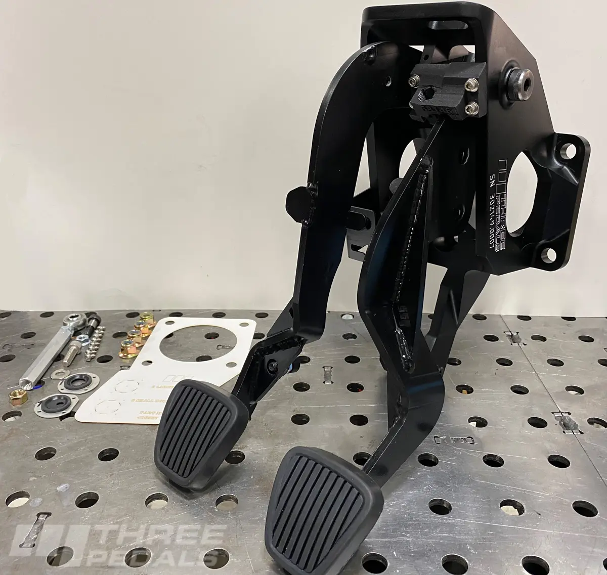

Sick speed Monty has a nice pedal
Tick performance has nice hyd MC setup
Three pedals is very nice but also ~1000.00
