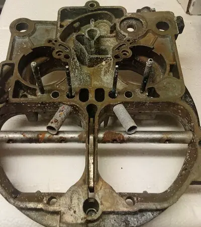

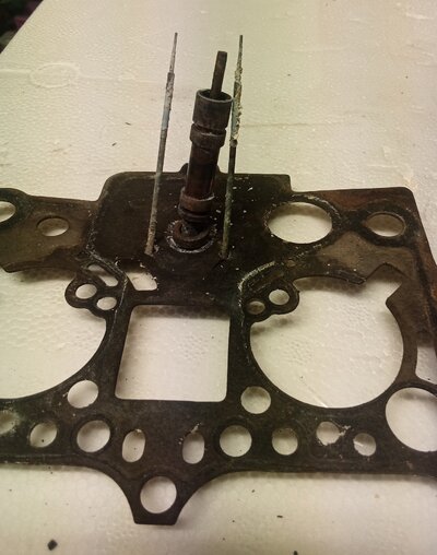

Photos tell the tale. Newer fuels evaporate out and leaves a crystalline residue. When a car sits for years this crystalline residue gets everywhere and is a particular problem with carburators.

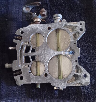

Pics show build up on primary rods and on inside of carb. Float bowl (not shown) was full of this residue. The residue as shown jams the rods and starting, tuning and driving is not possible until carburator is repaired or replaced.
The primary and secondary throttle plates are seized.
I have opened up a few of those. The old Permatex Carb and Choke Cleaner did a pretty good job of dissolving that crud. You can't get it anymore so I also try #2 oil and acetone or lacquer thinner.
Worse than that is trying to run the engine. I did just that once. The crappy fuel made the intake valves stick open. Lots of backfiring. It took hours of idling with fresh fuel to straighten that out.

I have a Holley that sat still on a 1956 Chevy for 10 years. The carb looks like 78Delta88's carb.
