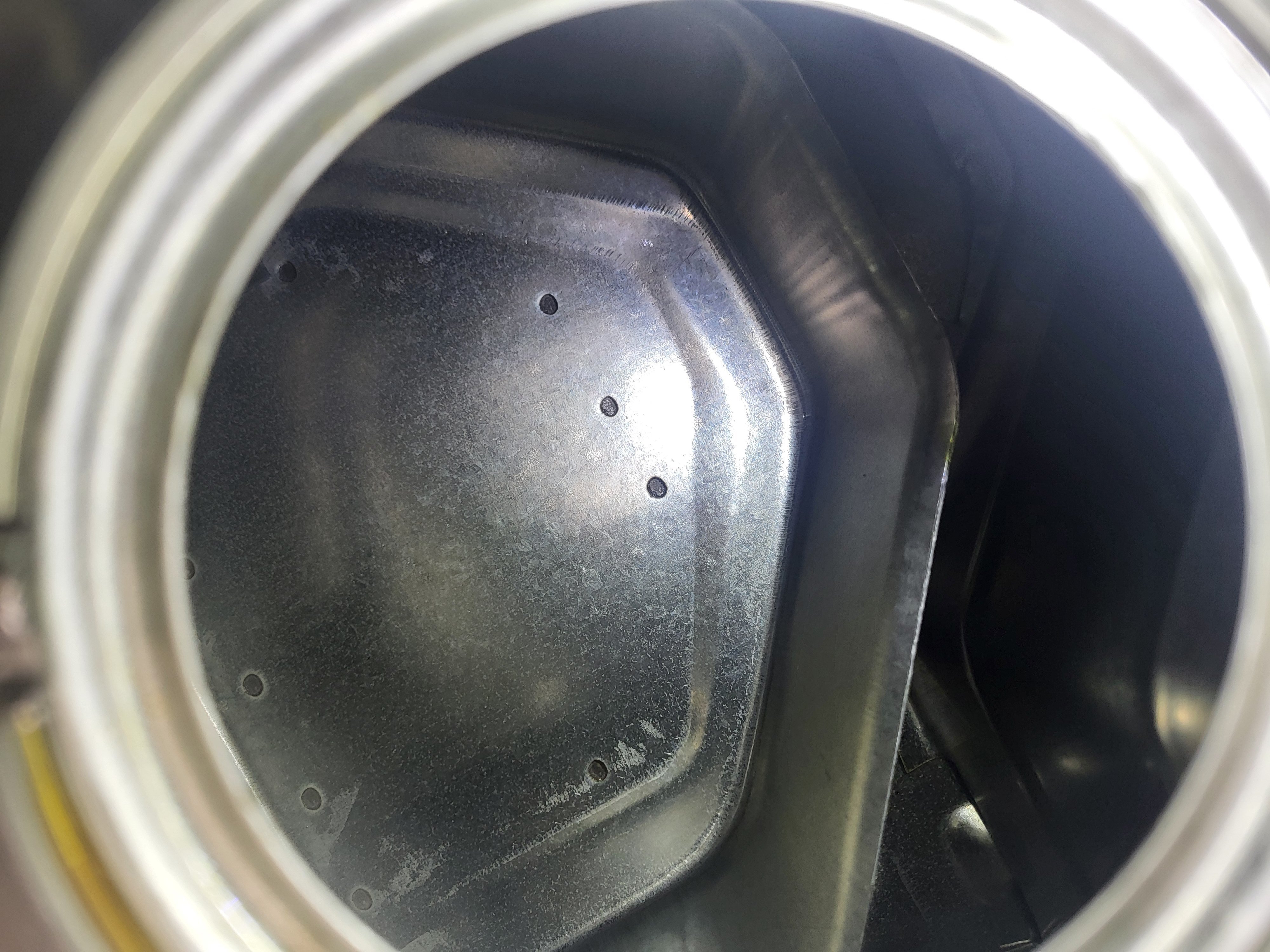

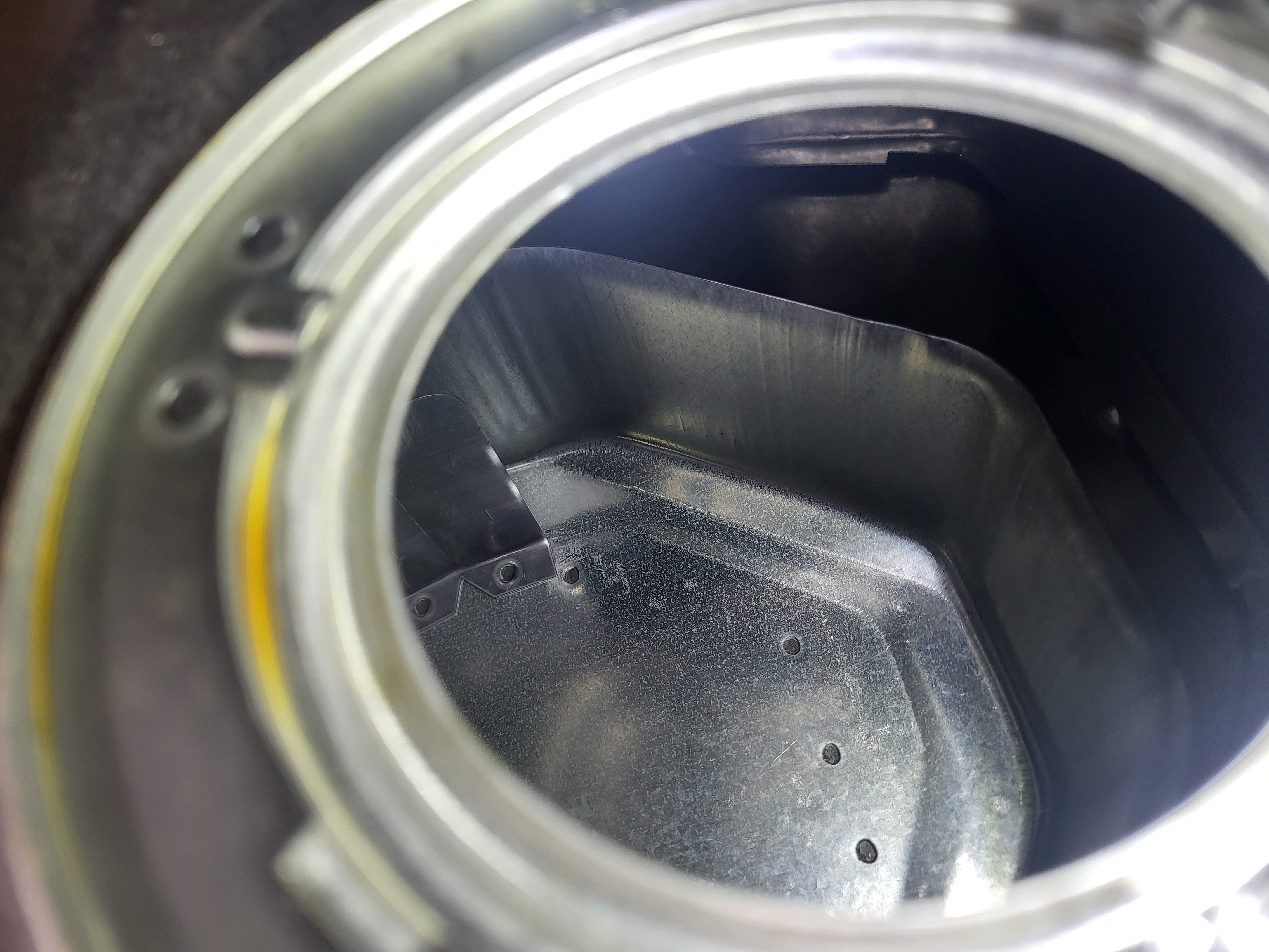

So this is the top of the GP tank so im
Assuming it’s not EFI and probably the same as my original cutlass one. Next question is because of that can I just use my cutlass tank with a racetronix drop in? Or is the baffle in that tank not high enough
The efi sender would have a return on it. The one pictured looks like the typical carbureted sender.
You can put an efi in a non baffled tank but you will have to make sure you always have enough gas in there as you will not have a way to direct or capture the fuel.
Last question being if I got the G body parts GN tank and dropped the Racetronix hat in it I should be fine correct? I wouldn’t have to cut and swap filler necks?
Yeah that's a carb sender on the GP tank.
