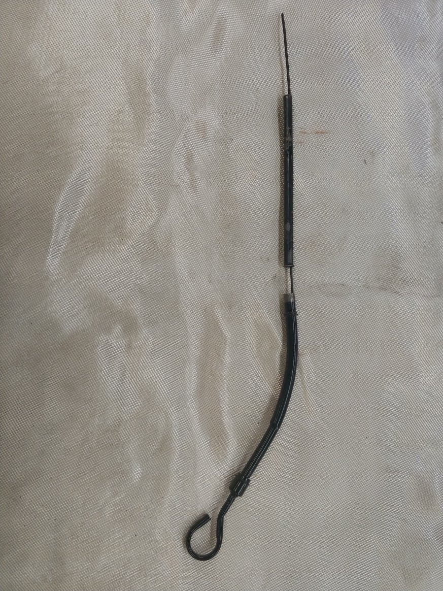

Never did find the peace. These are the pictures I took straight down the dipstick tube where it enters the block I’m not sure but the oval looks like where the dipstick should’ve gone to keep it in place. And you can see part of the blue gasket from the oil pan that sticks in there

Judging from the scratch marks on the side of the dipstick by where it broke off there is a clearance problem, when I replaced the stock 305 for the 350 I put in I took the 305 dipstick tube with me and purchased a chrome mr. Gasket tube and dipstick and the end of that dipstick got broken off outside of the motor fortunately
