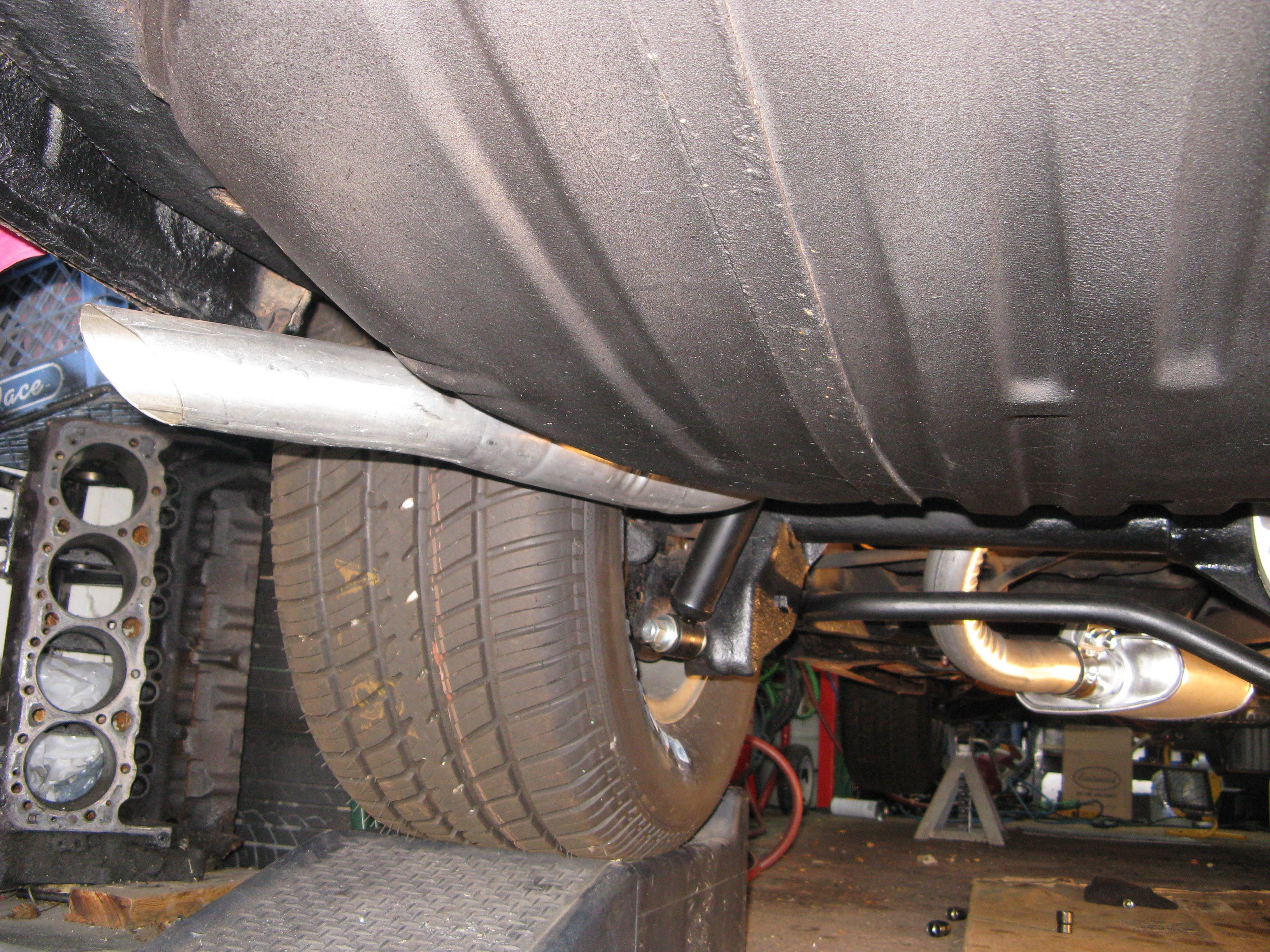

On my Monte I made the 4" tailpipes so that they exit right behind the rear tires and then turn down.
On my Regal I have stock Olds 442 tailpipes that exit about the same as my Monte but just have a angle cut on the end.

On my Monte I made the 4" tailpipes that exit right behind the rear tires and then turns down.
