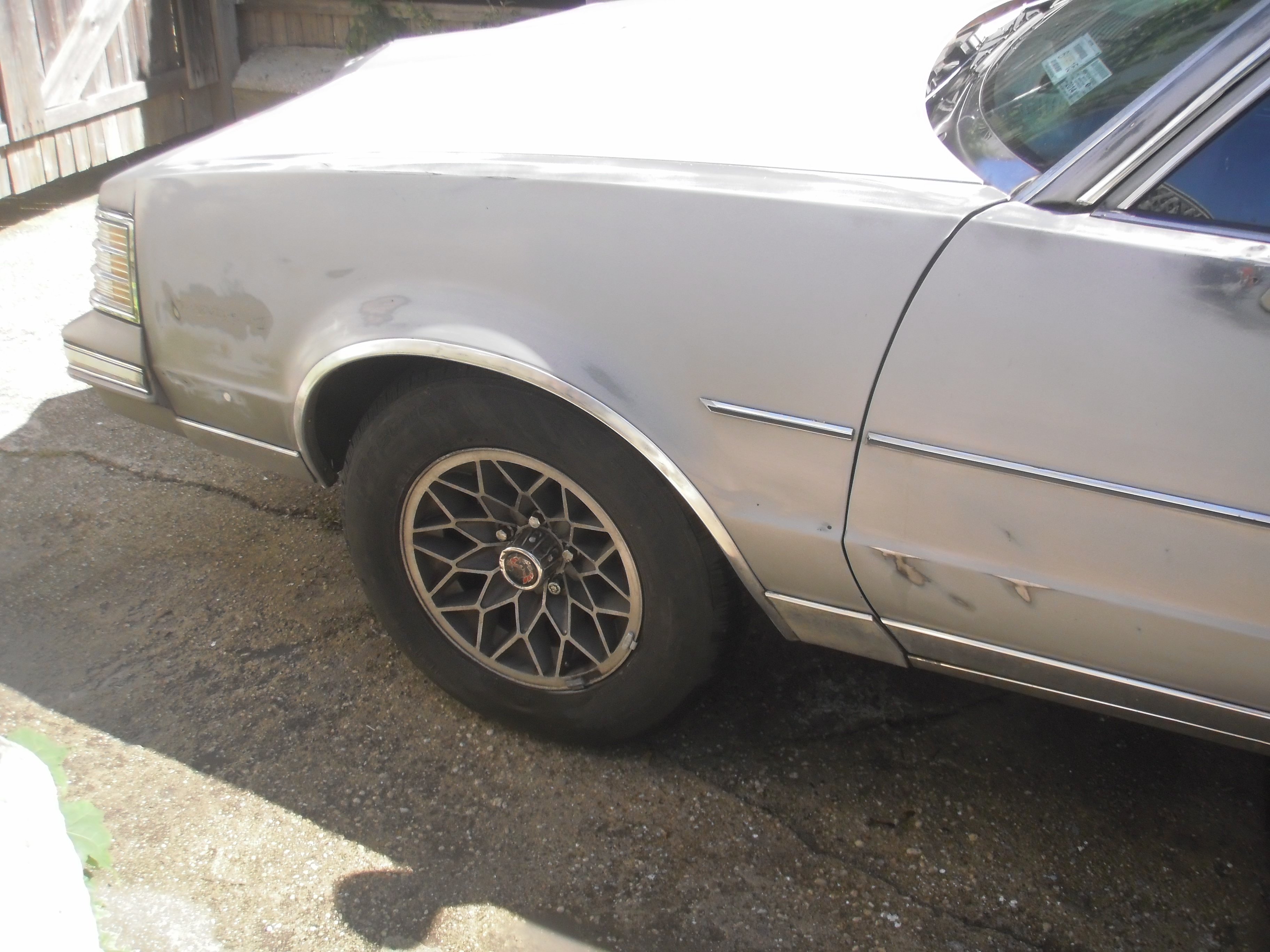

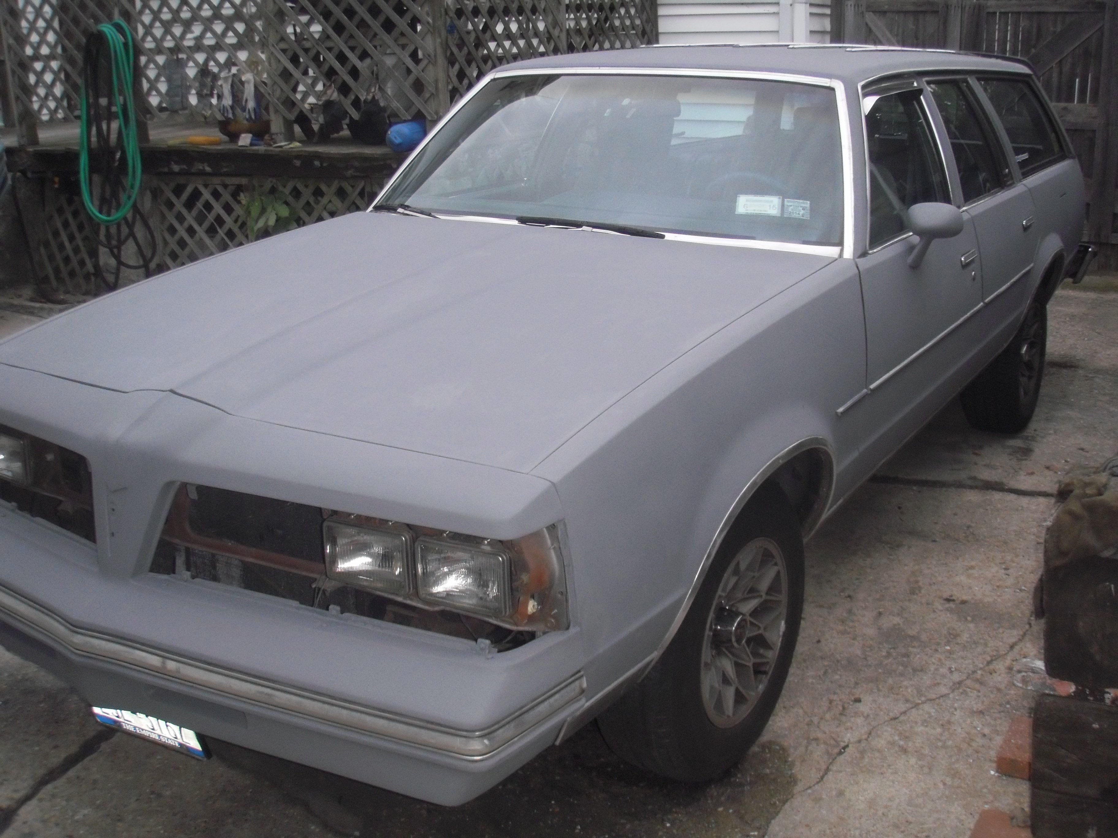

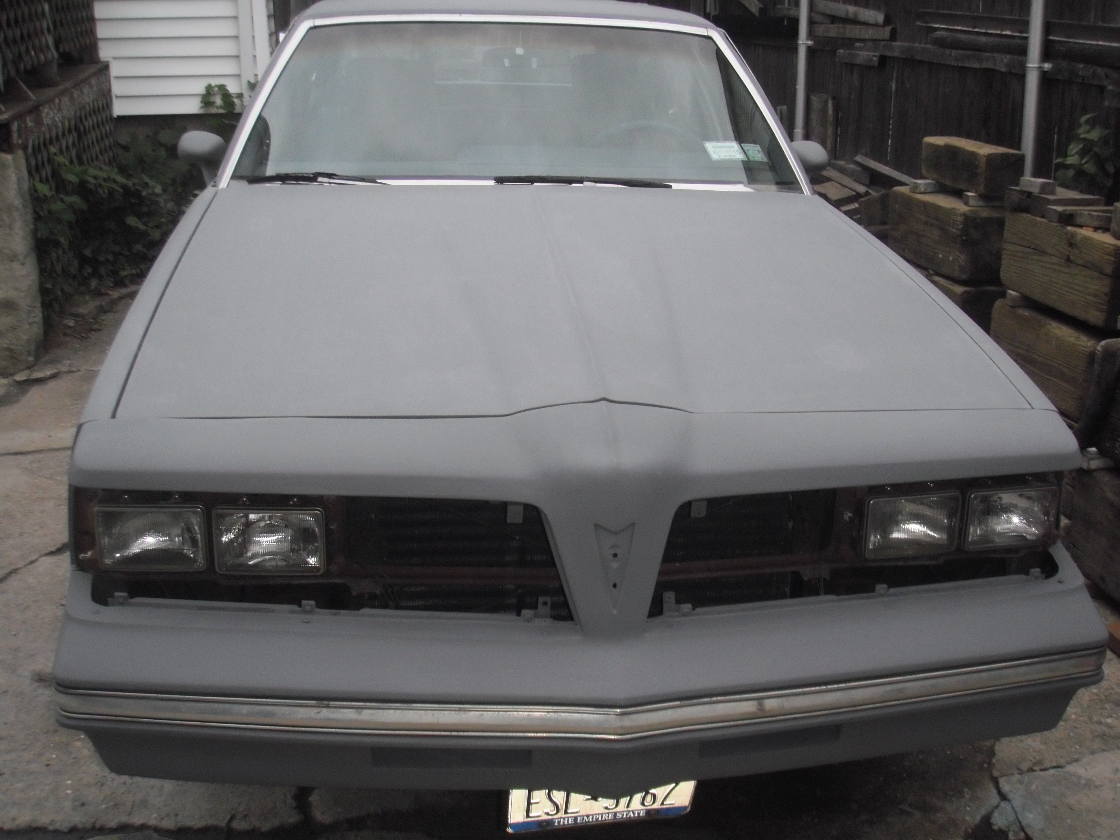

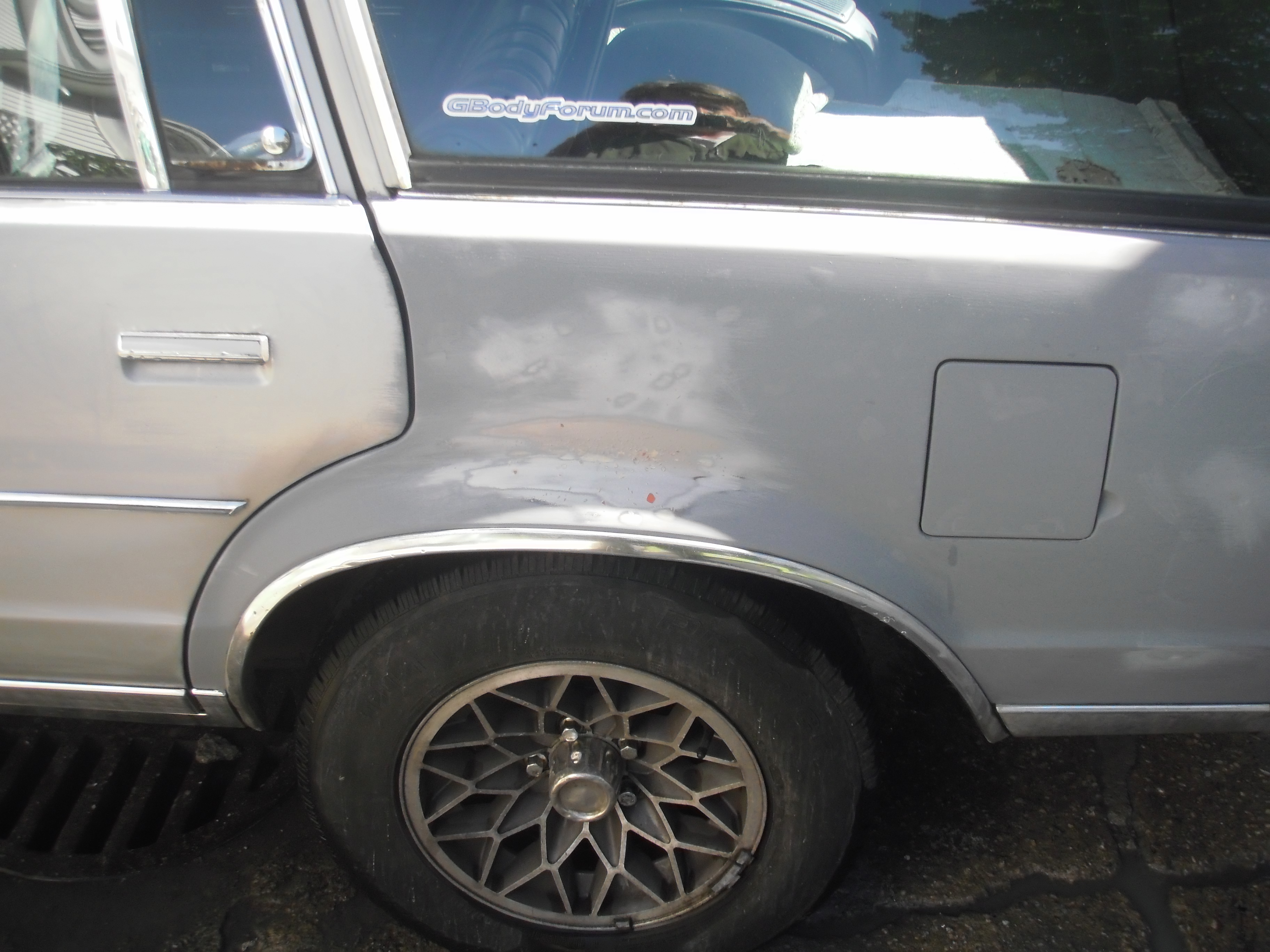

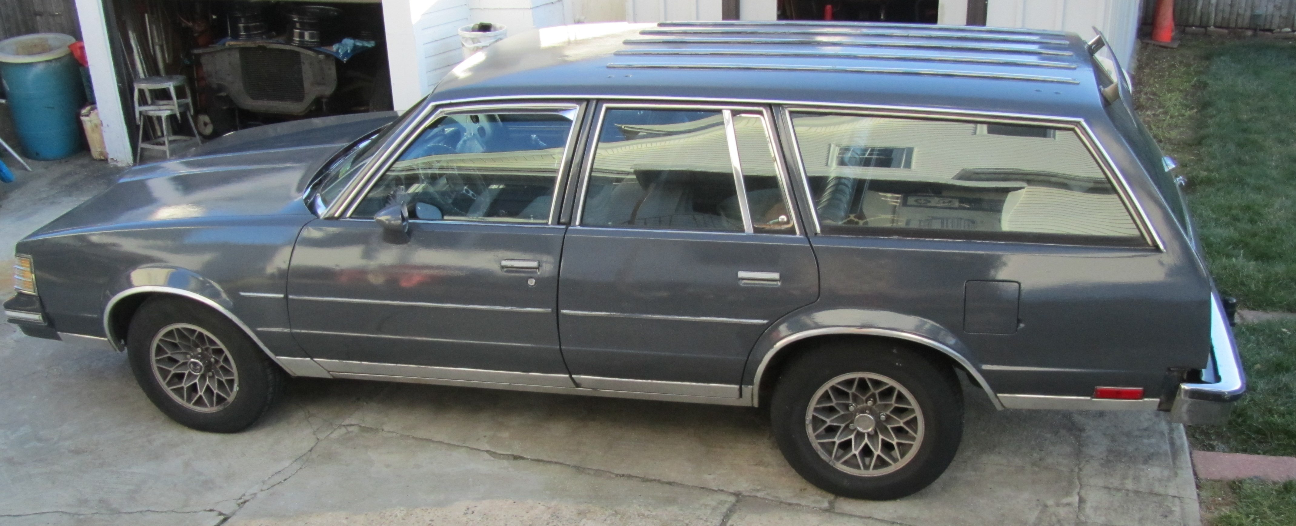

C'mon guys. There has to be some more home paint jobs to share. I know I can't enter the Bonnewagon again. But here is how I managed to get it presentable. The 93 year old guy I bought it from had an Earl Schieb $99 paint job done that was disintegrating. Some rusty spots had to be repaired too. I spent a lot of time cutting out rust and smoothing the little dings and dents. I had no indoor storage so no way I was doing an expensive paint job. I used rattle can primer and some Interlux boat enamel for a brushed-on top coat. Once it was all the same color it looked pretty good. Brush marks are a problem and I later re-discovered something they use with boat varnish. A product called Penetrol delays drying, improves flow-out, and hardens the surface. I was impressed at the improved gloss too. Here are some body work pics so please don't be embarrassed at your shade tree paint job. All that matters is that you are happy with it. I know I am, and I can park it anywhere without fretting it will get scratched. It is NYC presentable and that is all it needed.
