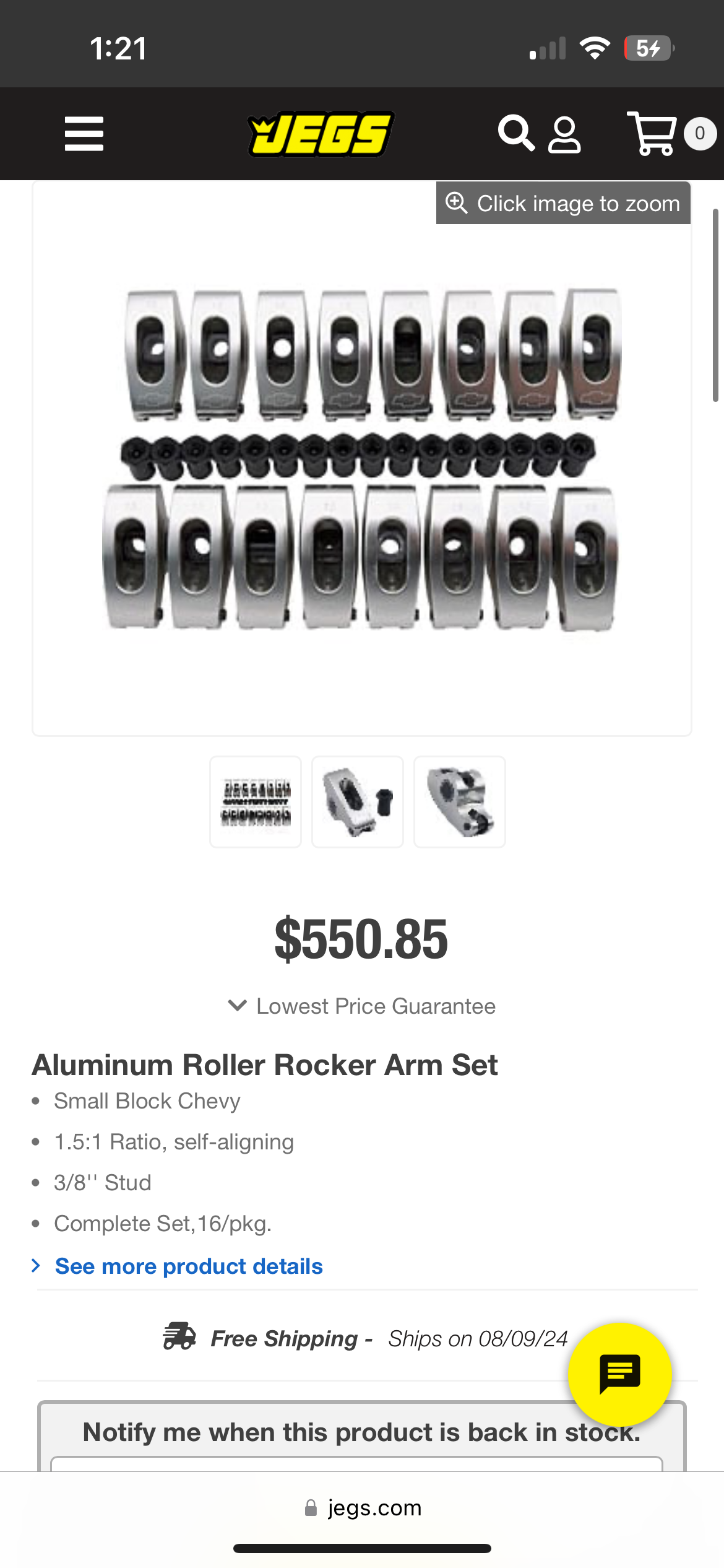

A buddy of mine gave me a set of these full rollers
I have a flat tappet valve train would I just be able to swap in the rockers and go like use the original pushrods and everything or what would I need to get them on
A buddy of mine gave me a set of these full rollers View attachment 242815
As long as your rocker studs are 3/8" and you have enough valve cover clearance they are a direct swap.
