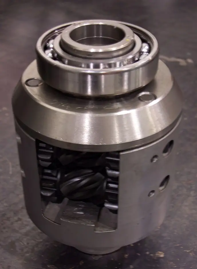

Eaton makes True Trac and Torsen makes torsen.
Just to be a smart arse
Torsen - Wikipedia
en.wikipedia.org
Torsen was made by Gleason (which is also one of the biggest gear tooth cutting tool mfgs) and bought by Zexel and now owned by JTEKT aka Koyo bearings.
But yea, Eaton=Trutrac Gleason/Zexel/JTEKT=Torsen
The factory GM 7.625 did not apply power in a 50/50 ratio to each wheel. And the factory Torsen in a Miata is the same. Does a TrueTrac apply power evenly?
The 7.625 Torsen we have always has done something that is very odd that I never understood. When on ice, implying zero traction - one wheel spins and the car would not move anywhere without someone pushing. But on dry pavement it would leave tire marks of equal distance. I never got my mind wrapped around why it operated in this manner on ice. Any ideas?
