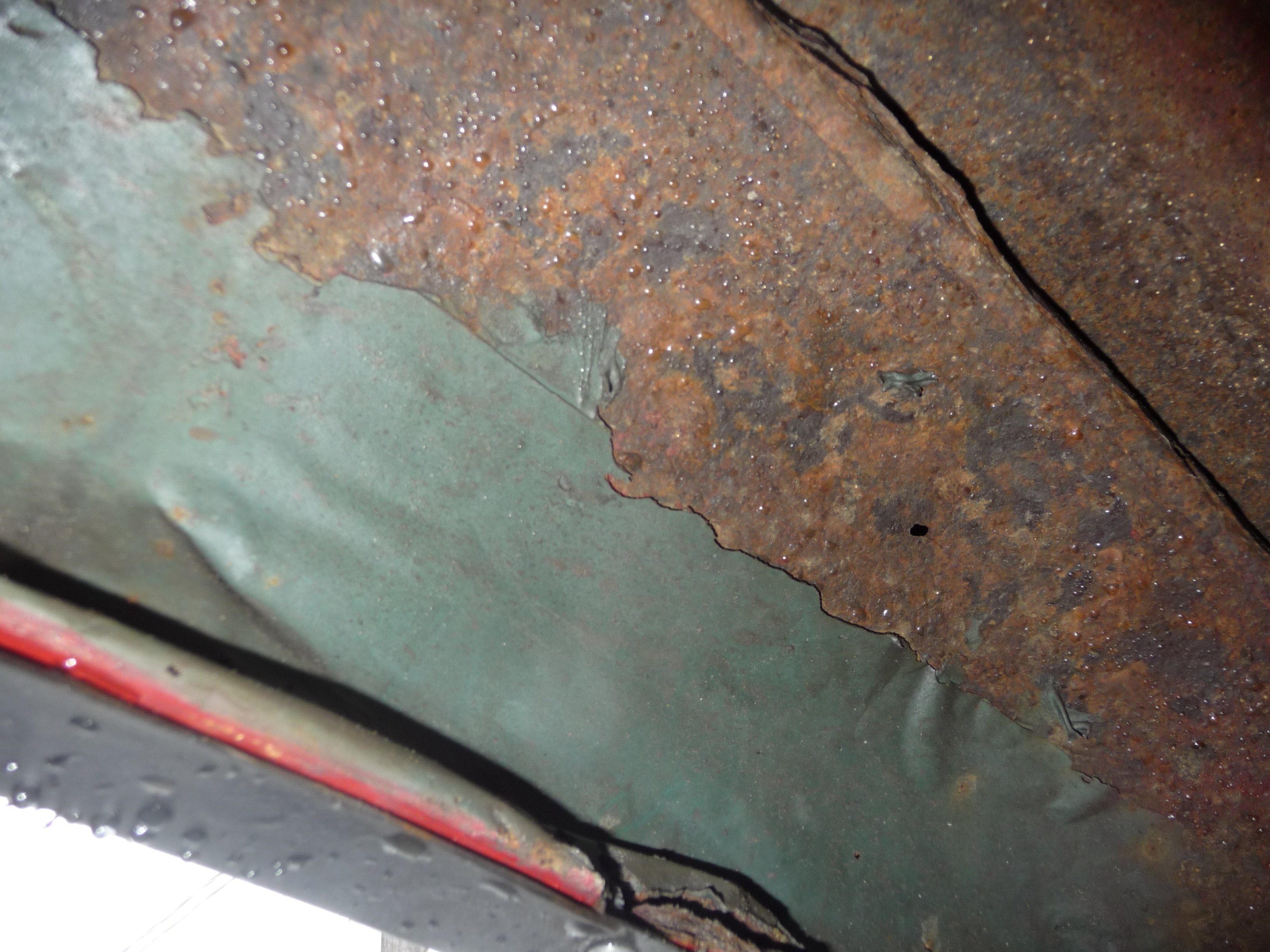

Pictures do lie---I looked at a View attachment 83033 120|K mile 2005 Silverado - obviously a repaint: wavy rockers(slip on), painted over lower fender rust, holes in front fender liners, rear fender liners patched with ?, frame crossmember at the point of being porous, poor attempt to blackcoat sections of the frame, primer inside the gas filler cap etc. Wonder if the average used truck buyer cares.View attachment 83028 View attachment 83030

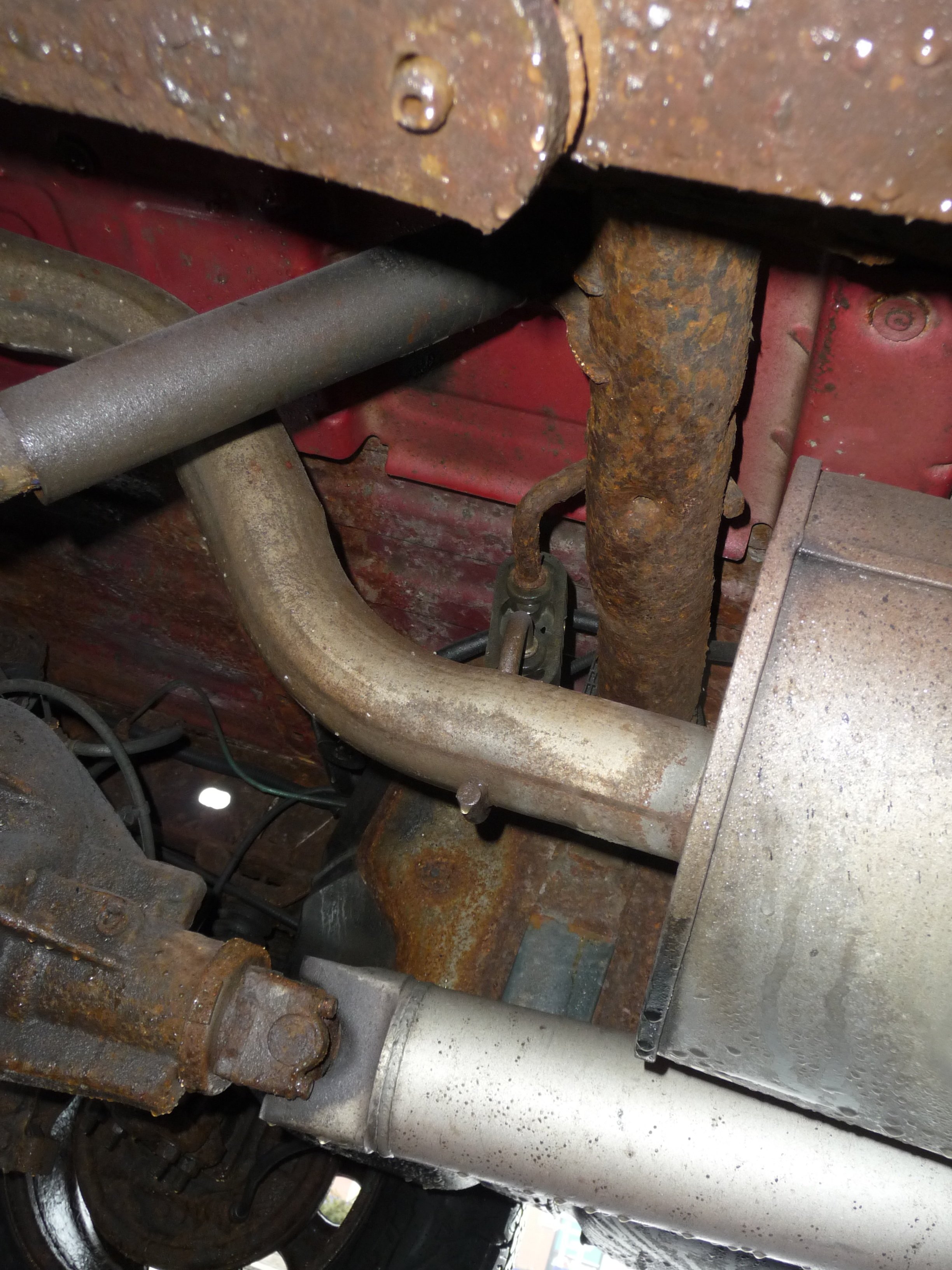

pic of inside rear fender lip and photogenic truck
Those body shop 'butchers'.(sorry to all the pro body people). The reason I could not feel holes in the rear wheel tubs to fender joint- they smeared some sort of epoxy layer in the gap left by the rust hole(grey material). By doing that they eliminated the drain holes.
That's dealer work it all gets done by the lowest bidder that's why when choosing a shop to work in I all ways asked if they did dealer work if they say yes I'm out the door
