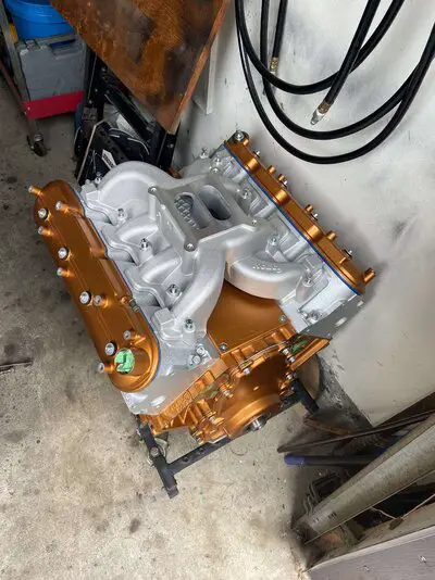

Picked up a Gen 3 4.8 back in October. And after stripping it down, .030 over, and all new internals(except rods and crank) I’ve finally got it in!
Start:
3.8/Th200
Reactions: Tony1968
Gen 3 4.8 .030 over
I’m going carbed for a few reasons,
Mainly because I like the look of a carb/air cleaner, and I eventually would love to do a blow through turbo set up, which I think looks badass. But for now this is the set up:
Sloppy stage 1 cam
PAC 1218 springs
BTR trunnion upgrade
BTR chromoly pushrods
LS7 lifters
Holley dual plane intake
Ofcourse new valves,gaskets,timing chain,etc etc
originally was going to paint it the old Pontiac metallic blue, but made a last minute decision to go with the “burnt” copper colour, which I think looks good against the aluminum.

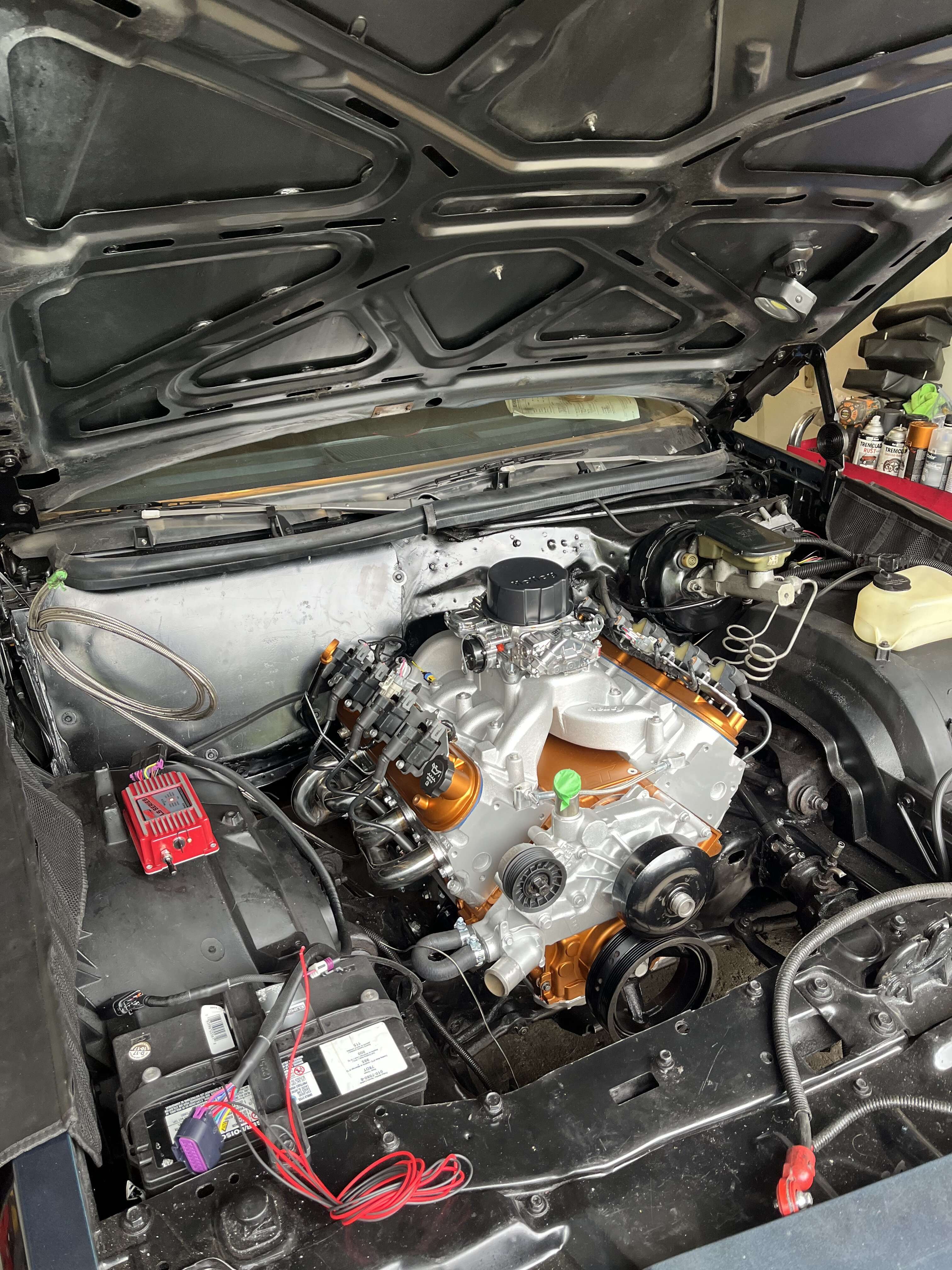

Also Picked up the TH400 for the shop, rebuilt with a shift kit. 2400 stall converter
Got the Carter fuel pump mounted and plumbed. HotRod fuel hose braided line and fittings.

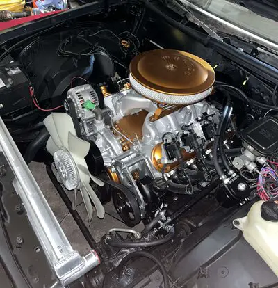

Also got my EBay headers installed, and started throwing alt/ power steering stuff back on, as well as coils. Eventually I’d like to get nice looking brackets but these will do for now. Also I don’t think I need that big of an alternator.
Couple updated engine pics..
Changed alt/power steering setup,
added 750 QFT,
Champion Rad
couple vacuum lines, fuel line etc
Various other things.
I ran the fuel line in from the back to try and clean up the engine bay a little, since I wasn’t planning on using a fuel pressure gauge.
This is my first swap, so If anyone sees anything that’s not right or could be better, please feel free to say something.
