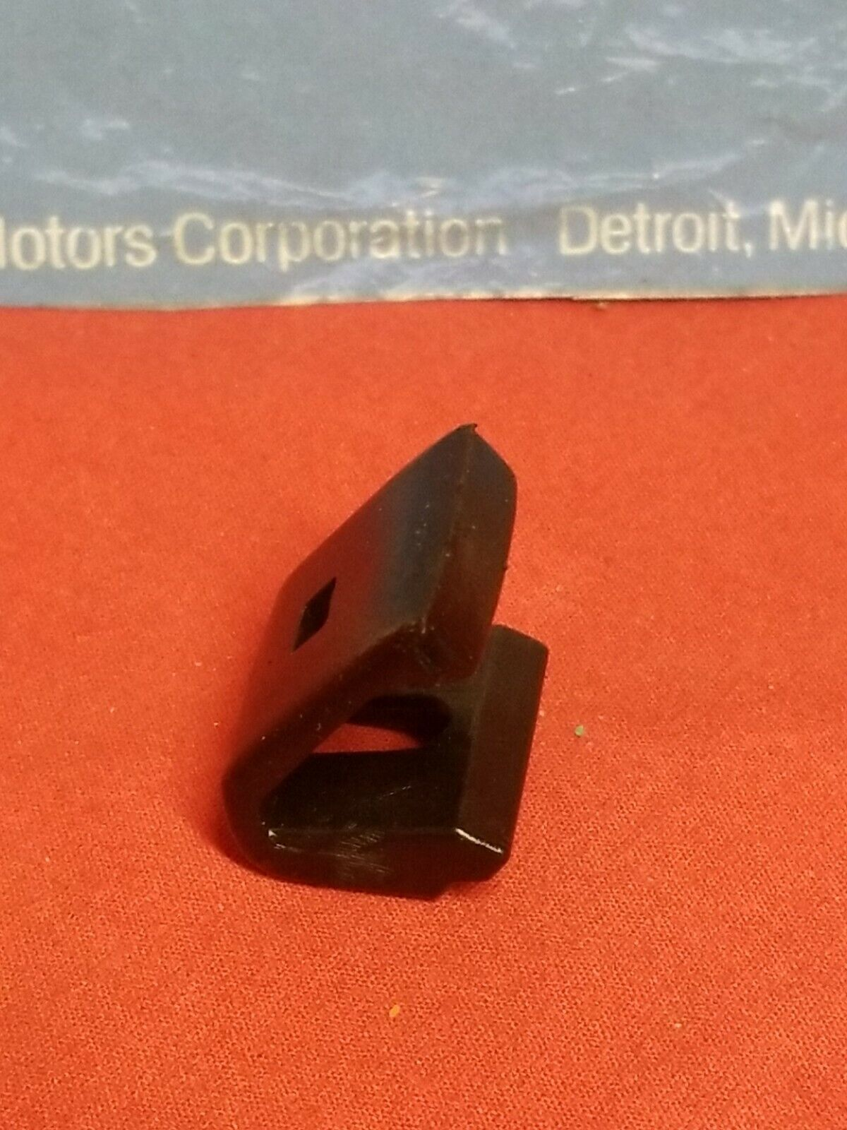

Yes just wondering if any of you wagon guys actually have any pics of the trim pieces that holds the headliner in? I got some pieces but don’t know what I’m missing

Chris if you could re-pop those plastic clips I think you would be an instant hero!!! I can send you one if you think it will be doable.

Awhile back I noticed someone (I'll have to search back) had the rear clips over the rear hatch window. I think they were within reason. I believe you had to purchase them in bulk. Let me find that and report back. The difficult expensive clips are the ones over the quarter windows. I've seen those for sale for stupid money on Ebay. Man, people have chutzpah, don't they?
I'll see if I have any of those that can be duplicated. I might, but it would most likely have the broken lock tab which renders them useless.
Someone offered to duplicate them some time back, but I guess the notion fell by the wayside.
Windshield interior moulding clips- https://www.clipsandfasteners.com/GM-Window-Upper-Garnish-Moulding-Clip-p/a18398.htm
The part # for the rear window garnish moulding is #3074737. It requires 5 if I'm not mistaken....or at least 4.
The 1/4 window trims are part # 3073629 .That requires 3-clips on each side.
The small U-clips that go over the door window mouldings...I don't have a part # for, but I think they may be easier to find.
It looks like the sources for the other clips are NLA. I'll continue to do a search for them.

I think this guy spent too much time in his basement sniffing glue. I think I have one or two of those that I could submit to the cause. Plus the rear hatch moulding clips. I don't have any of the 1/4 window clips. Not even a broken one. I shouldn't have tossed them. If anyone has any of the 1/4 window trim clips, let us know. I think between us we can come up with a few that can be 3D printed. What do you guys think?

Oh, right, yeah the clips like what Bonnewagon's pic shows.
I hope between us we could come up with a few guinea pig / test case clips to be printed.

I have some nos clips. Sides and rear

I posted pics of the clips some years back on the section showing the assorted G-body hardware. I was later advised that the pics were no longer there. Thanks to Photobucket. :rant:
Thanks for re-posting the old thread link.
