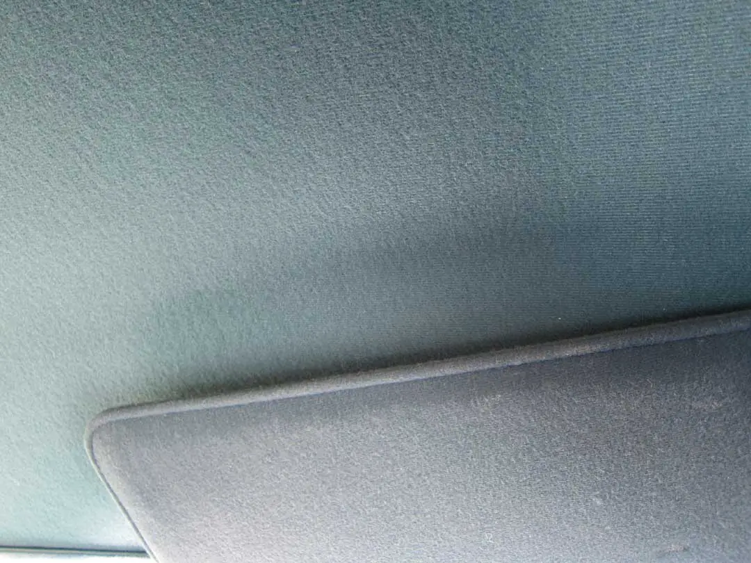

Here it is after I reinstalled the newly refurbished headliner. Not too bad of a match at first glance. Those lines aren't wrinkles, it's just sun reflections. It's been 11 years now using 3M headliner adhesive and it's still looking great. So I have confidence in the 3M stuff. It's been at least 20 years ago (yikes) for the 84 H/O done with 3M glue and it still looks good as well. But keep reading.

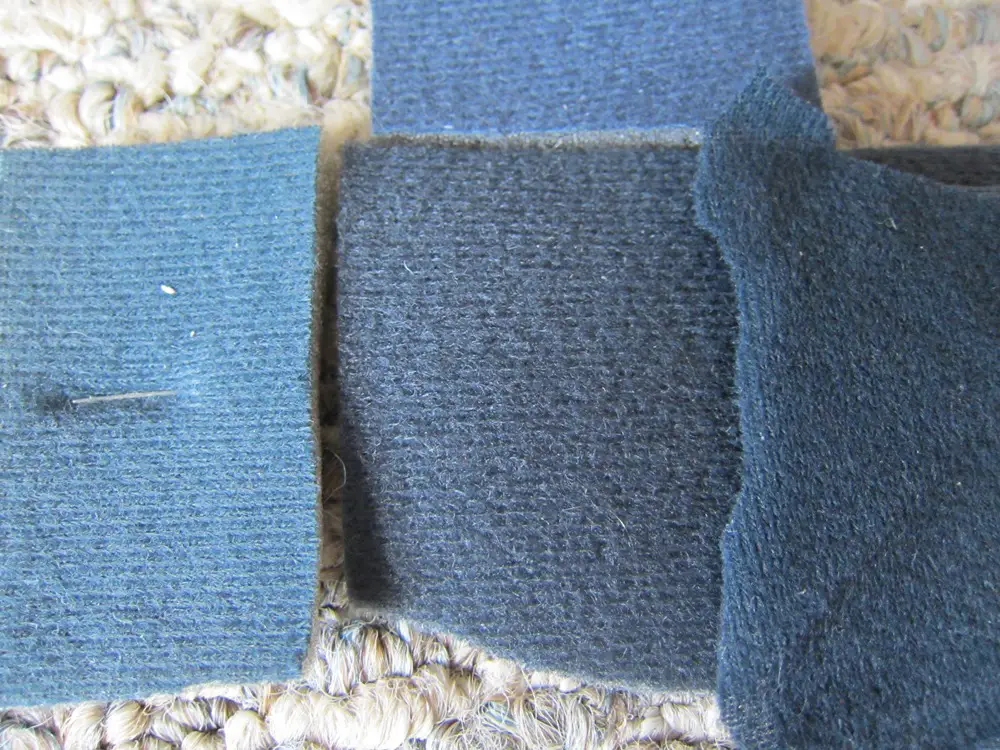

Samples are usually off with dark blues and maroons. The 87 442's original material is bottom right triangle looking piece without any foam on it. Nothing looks exactly like OEM here. This is just a few samples I had out of seemingly a dozen blues from various places.
OEM on far right.
I finally got something "close" but still, not exact. I don't look up much when I'm driving anyway. And this is why I said you have to have enough new material to redo the visors, just to keep things matching. You can see here it doesn't exactly match the OEM visor color. Redoing the visor makes it look "even" and in the case of the blue or maroon it would blend effortlessly where someone might not even notice. It was a bright day and the camera didn't capture the correct hues, but in this pic, there's no doubt there's a difference.
