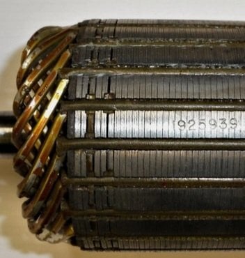

A factory big block olds starter will have square armature windings any so cauld high torque starter' has 2 tabs connecting to the bottom solonoid and were the copper tabs gothough a rubber bushing...the 455 type starters I've use have a bigger armature square windings and a big type case .. if you can find one of these starters it will as they say" twist its tail".....of course you have to have the right cranking amp battery I'm including a pic of the type of winding in some big block delco Remy starter I can't find and olds one in particular ',but they had them
