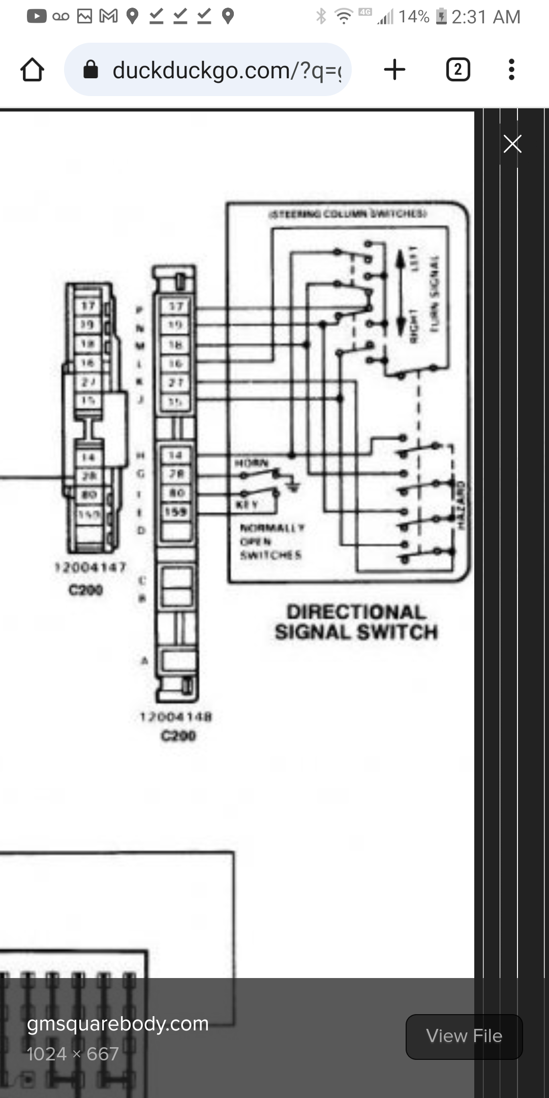

You will need to remove horn button and check that the horn connector will ground to the horn ring when you press it.
Attached is basic schematic and pin layout of the connector at base of steering column.
Pin 28 is the horn...

It's hard for me to read that drawing but (I think it's) E and F. If you jump those two together. The problem is in your new horn switch and everything going to the relay is good.
