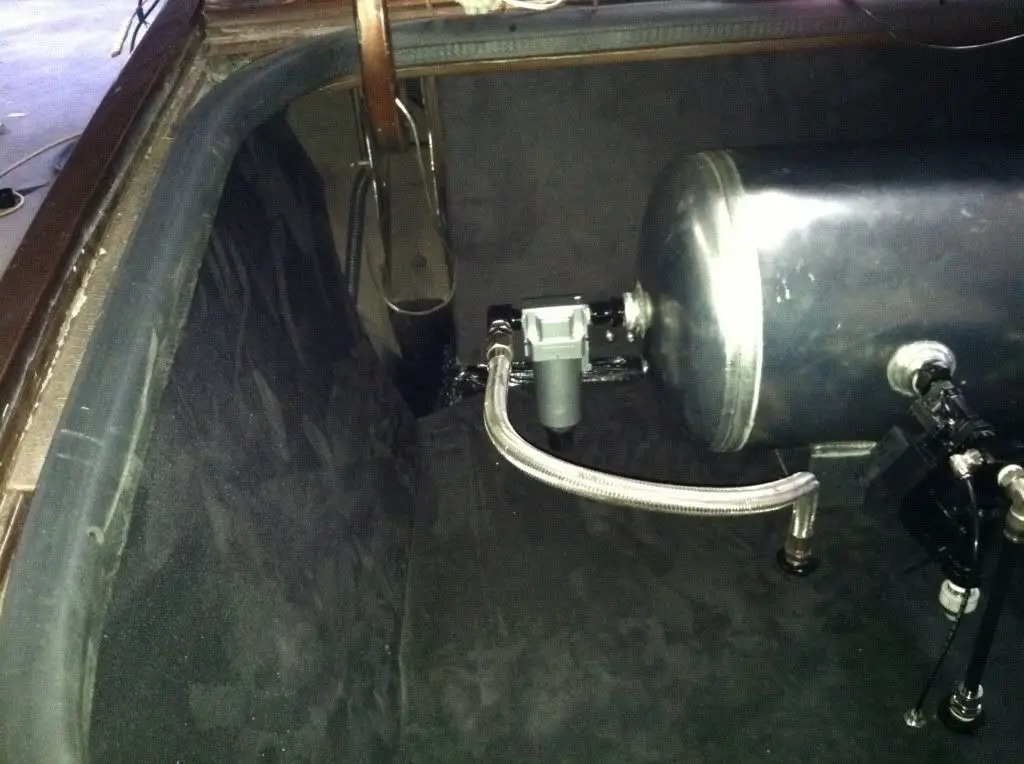

i re did my trunk setup tried to clean it up a bit.

here is my old setup not really up to my standards but i was rushed and said i redo it all later so i did

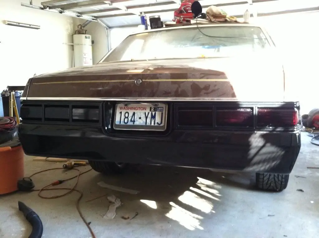

I also tinted my tail lights and touch up my plate box.
They are under the floor in the spare tire well that is what that fan is for it wired up to come on when the compressors turn on and stay one for 5 min after they shut off using a delay relay. Keeps them nice and cool auctually at a lower temp than if they were just mounted in the trunk like they used to be. I brought the head temp down from 131to 81 taken 5 min after shut off after running for 13 min ( the time it takes to fill the tank to from 0 to 200psiG
The trunk deffinitly looks better.I like the blackout taillights too,have you tested them in the sun,I was wondering do they still look bright enough that you wont get rearended?
That's very clean looking. Nice touches with the bulkhead fittings and that compressor compartment with the fan.
