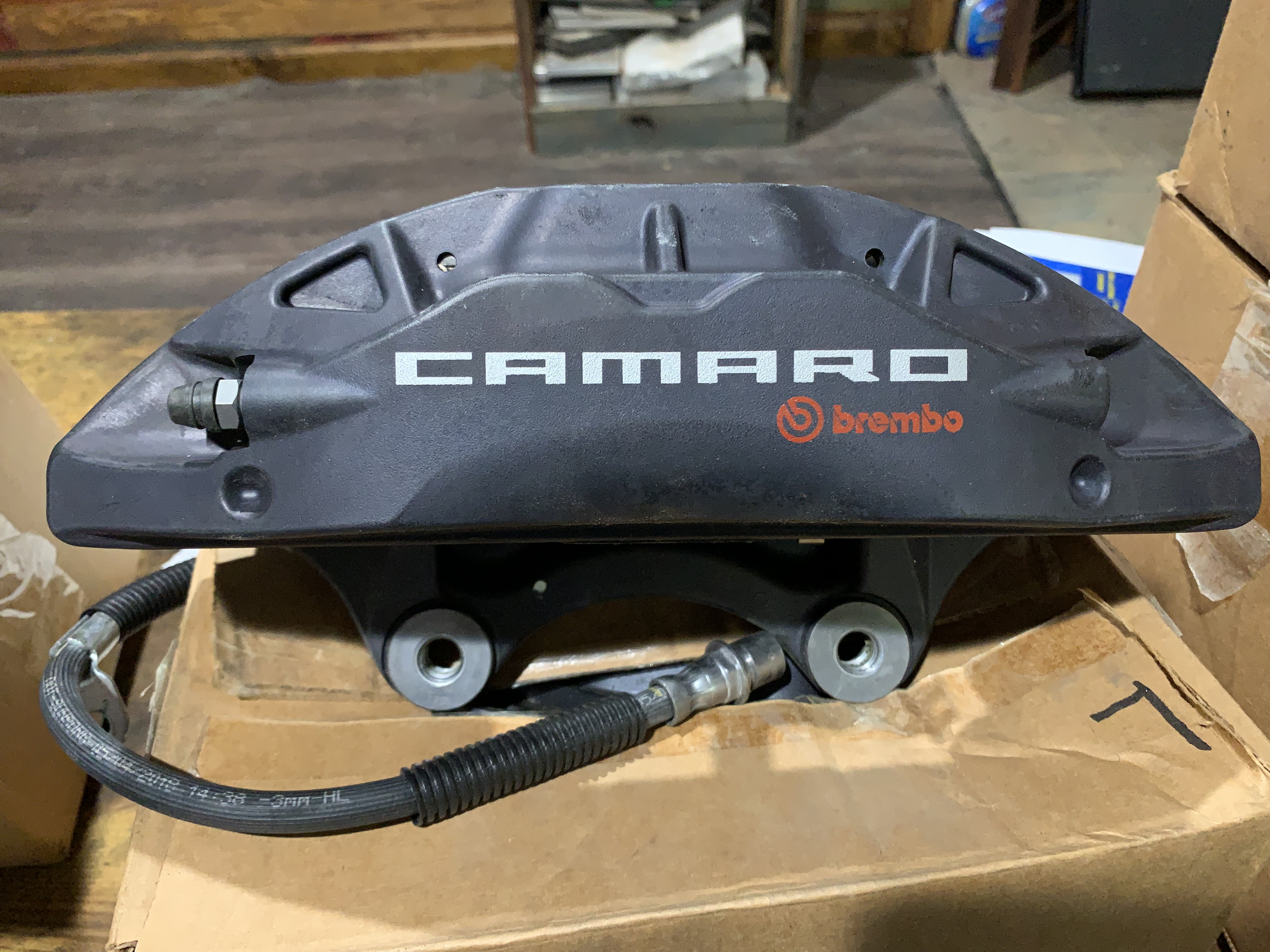

But I’m kinda dead set on another change- brakes. The current setup has some issues, mainly leaks, and I think I need to step up the size of the master cylinder. The brakes will stop the car quite well, but I need to bury my foot in the floor in a panic stop situation and I feel like I’ve left some brake performance on the table. Going to a 1-1/8” bore MC should help without being overkill, and should be properly sized for these:

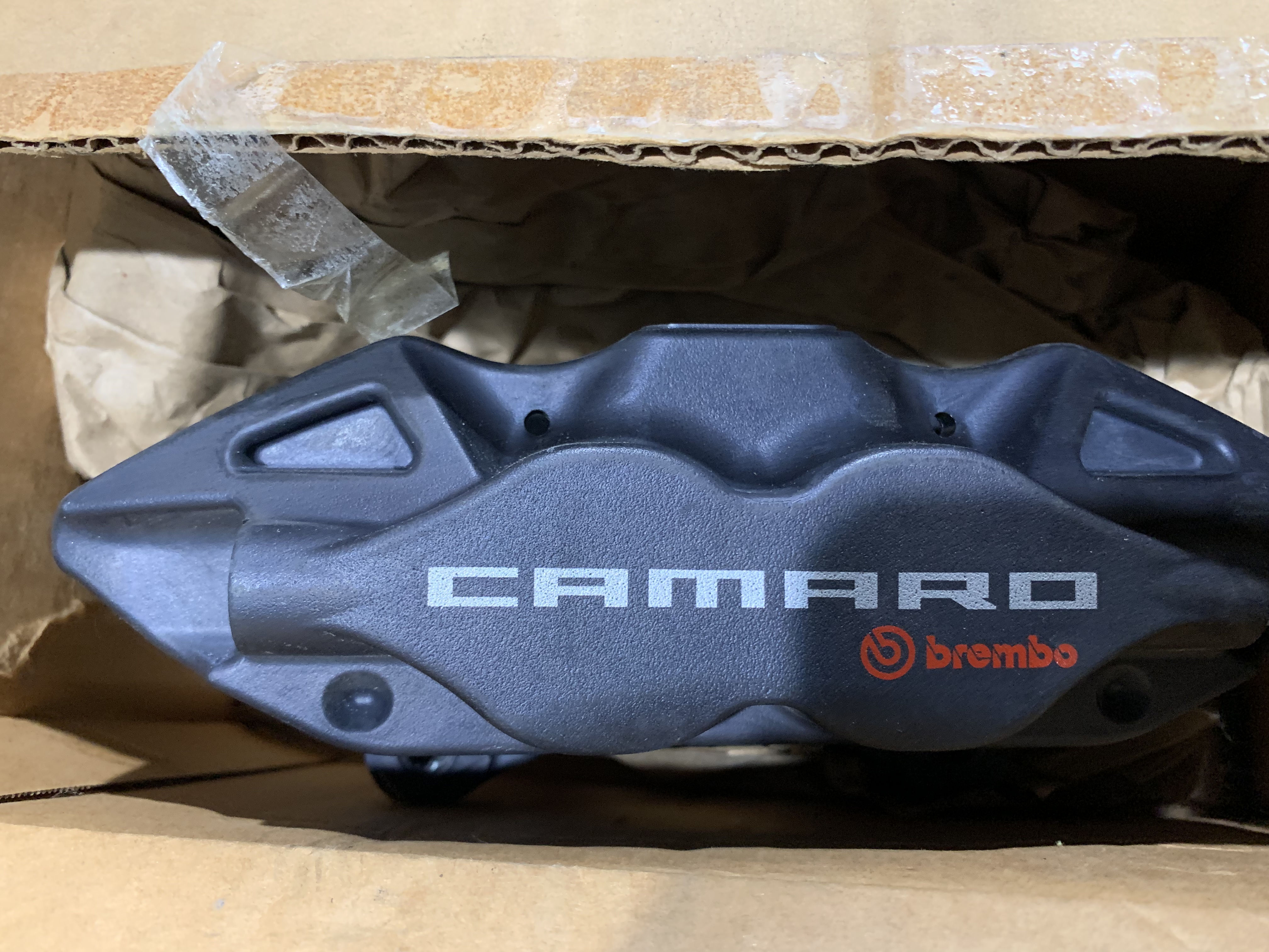

13.6” and 13.3” front and rear brake calipers from a 6th gen Camaro SS. Completely overkill, but the price was too good to ignore vs something with Wilwoods. I’ll have to take some measurements to verify if I can run C7 Corvette rotors front and rear, or if I’ll have to try for Camaro rotors but since those need the center bore opened up I’m trying to avoid those.

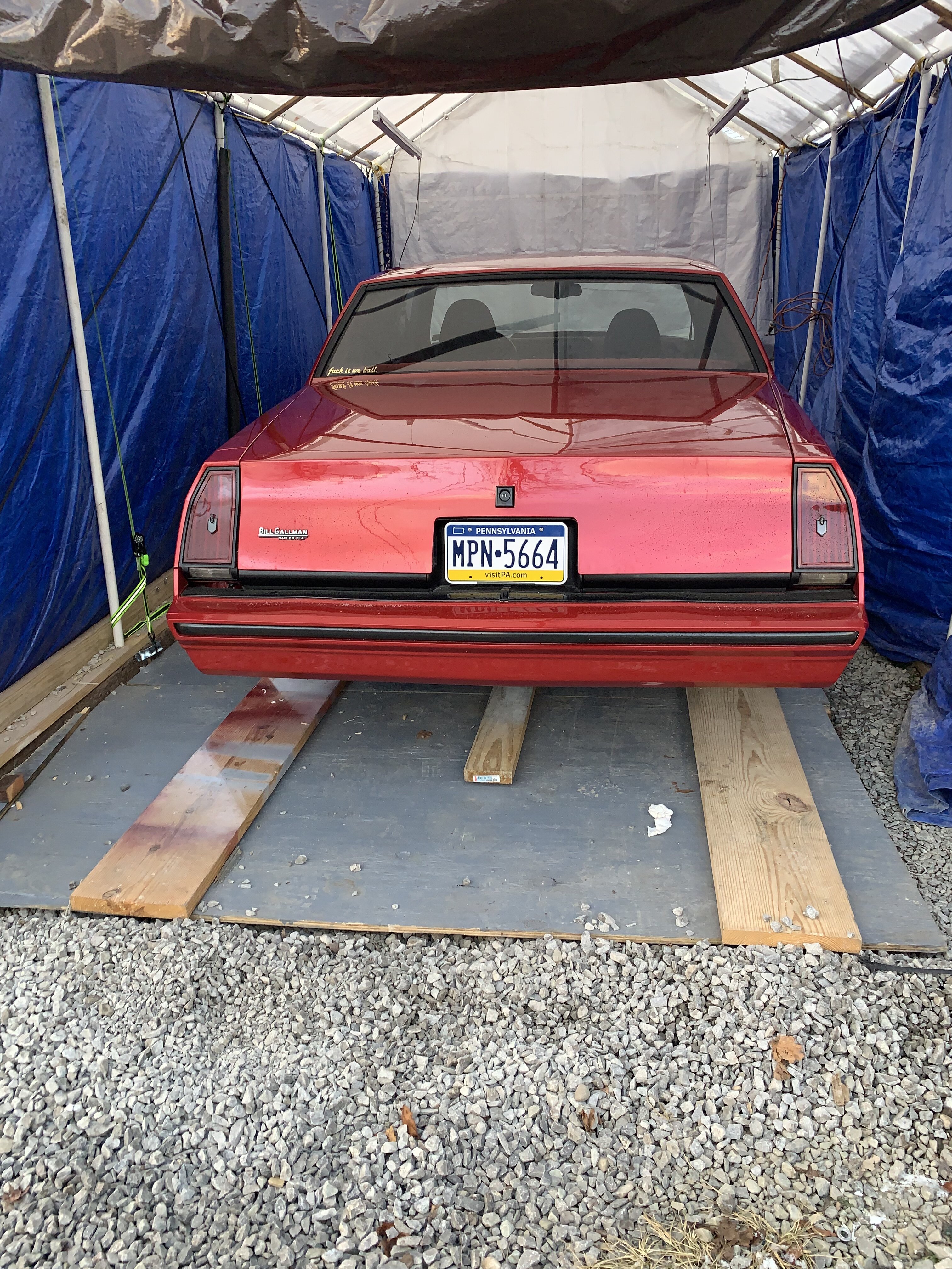

It’s been a minute. With winter officially here in Pennsylvania, I’ve stored the car for the season.
Stored back in the tarp garage with a few changes: added in 2 extra pairs of uprights, and traded the sketchy rails for a makeshift floor. Hopefully the floor will help the moisture issues I had last year. At least it’s more comfortable that gravel!

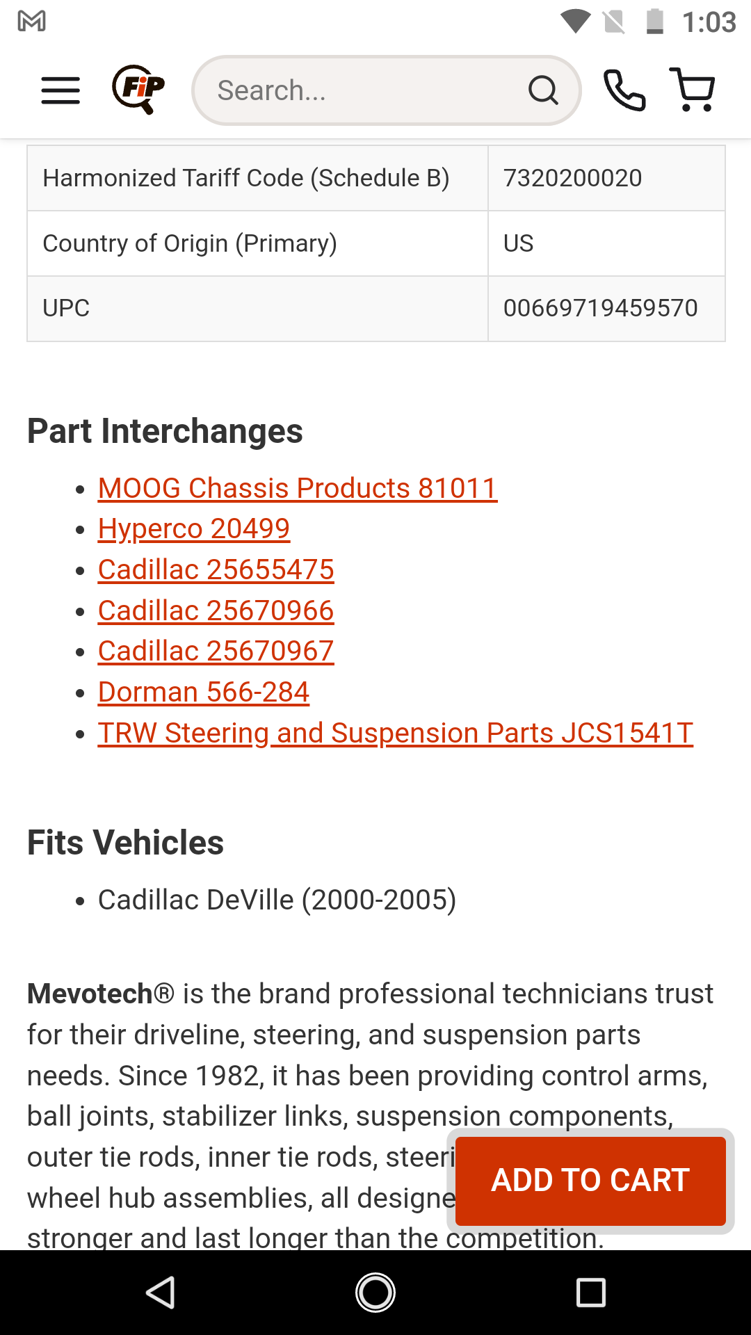

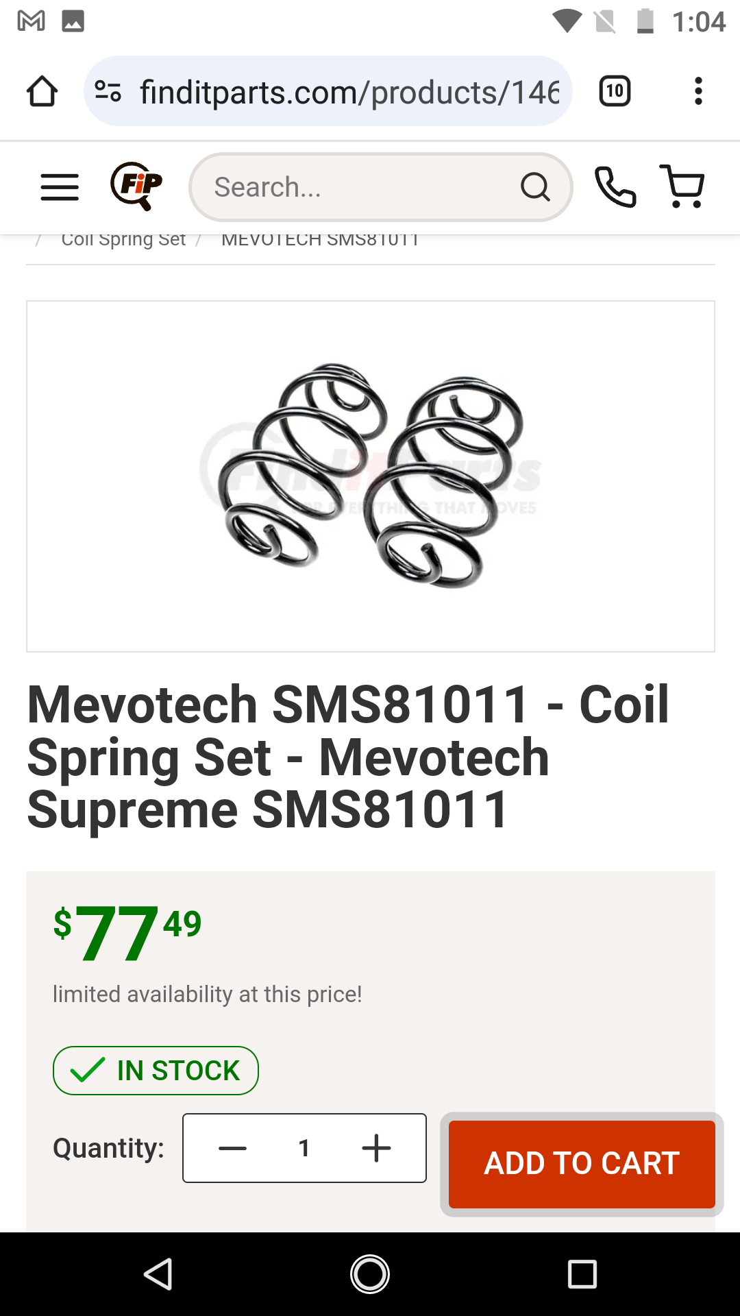

I'm super happy for you, man. That's an awesome car! I looked into the coil springs and found Moog 81011: double pigtail, 12.79" free height, 5.57" inner diameter, 0.56 bar diameter, constant rate of 145#. Discontinued but available from Mevotech for $80.

Great looking "garage" and adding the floor was a smart thing to do. Now all that you need is the 50 pounds of moth balls to strew around both outside the car and inside on the floors and under the hood and in the trunk as a deterrent to the critters. And yes you will have them come, it's like that line in the movie, "if you build it they will come". Somewhere enclosed and dry and sort of warm? No odds against there.
View attachment 249057View attachment 249058
Thanks for the find Johnny, but I ditched the stock pigtail springs for 5” OD springs the circle track guys use.
I’m going to inquire about some custom springs if anyone will make them. If no one will, adjusters it is!

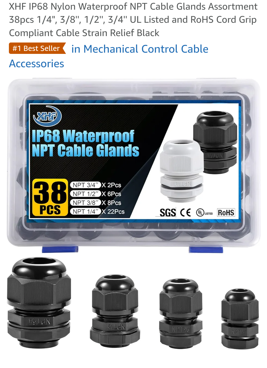

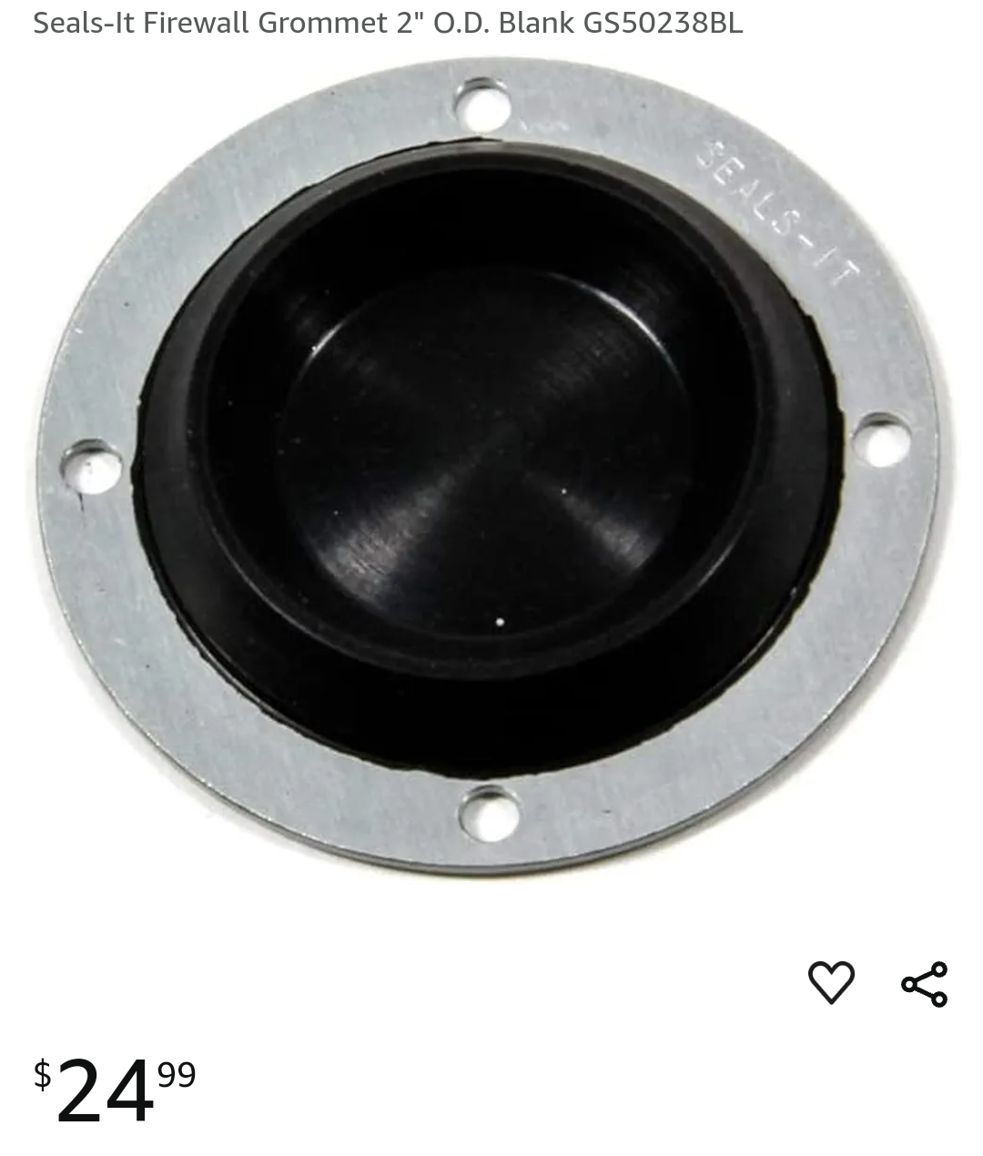

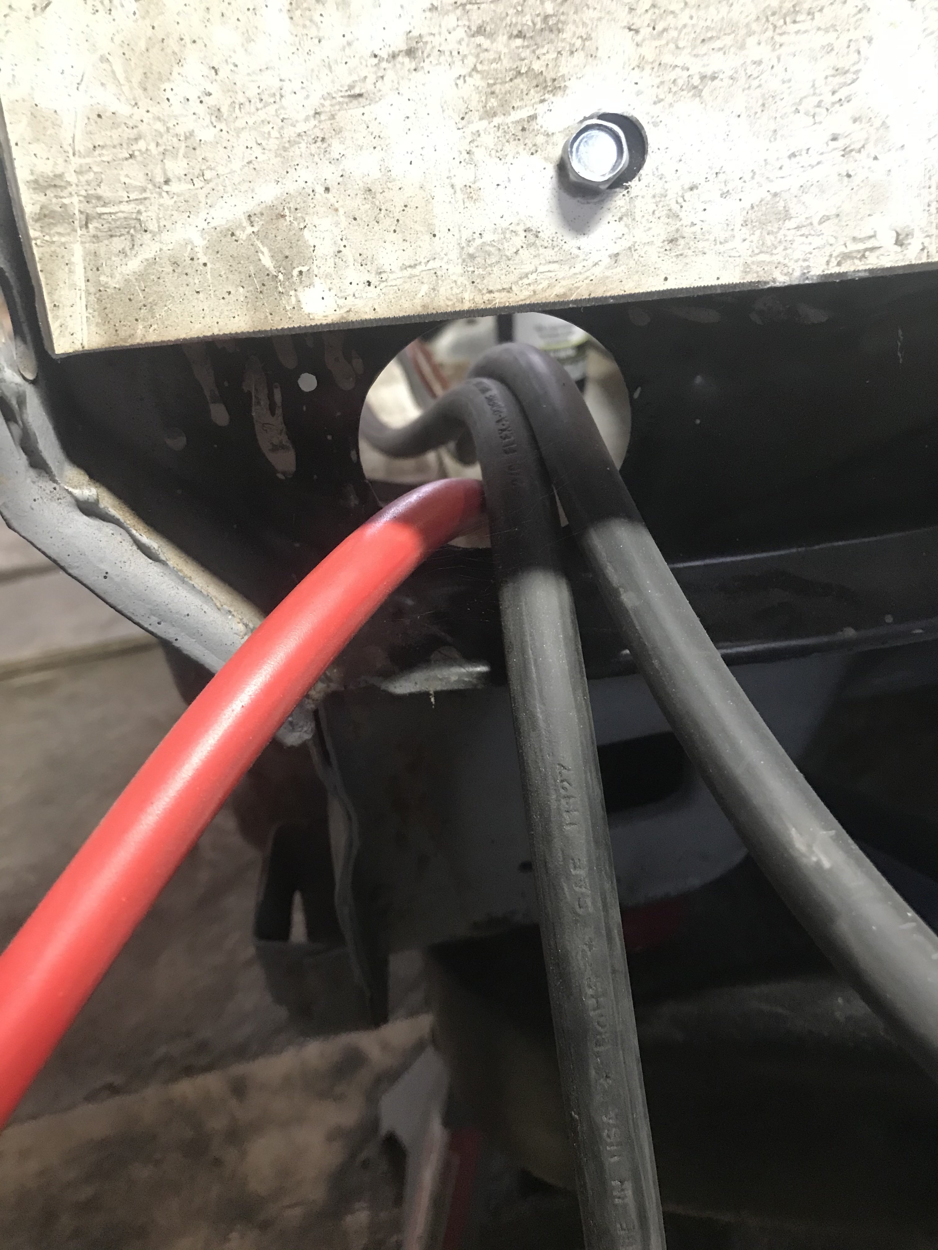

I’m hung up on what to do about the 3 battery cables I’m running through the firewall opening for the computer harness. I do have the grommet for the harness, would it make sense to cut it up to fit the cables, or does anyone have another suggestion? I’ve got both the 90 degree elbow style and a style with 2 holes that used plastic plugs to hold the harness.
Urethane or a boat stopper ? Maybe an inch of pipe with tak-ed flange ?

My apologies for the poor recommendation, I forgot that you'd swapped and I didn't re-read anything before posting. If you're still looking for cable grommet ideas (thanks for the reminder, spongbob) I've considered cable glands or grommets for Asian vehicles.

Thanks for the ideas guys, those are better than what I did. Just took the A/C harness elbow, pulled the harness, cut the center out ran the wires through and used sealant to hold them in place.
