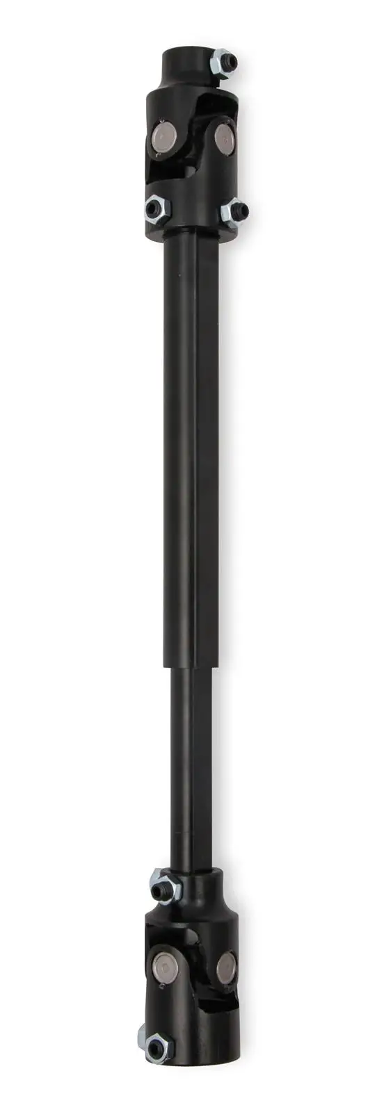

It looks like buying a new shaft rather than buying the U joints Is the more economical way to go. The Hooker Blackheart shaft is on E bay for $49.

ok thanks. awhile back i seen someone install a blackheart on their gbody and they had to hog out the end a bit that goes to steering wheel a and sounds like 1 i'm lookin at does too.

I like the Hooker shaft as it has no rubber isolater. I think that's the way I'm going to go.
The telescoping feature is nice in a wreck as well, potentially preventing you from spiking yourself. That whole column or just the center shaft can come into the cabin if the front end is smashed a particular way. This is an area where the rule books for circle track, derby cars, etc. illustrate what needs improved if Nana's car is to be used for "spirited driving".
The Astro van shafts melloelky mentioned have no rubber isolator, and Hooker basically copied the design but made a few changes. They make a great product, though I personally see it as a more expensive version of a capable factory part. But we all buy that kind of stuff, don't we? I know I do.
I'll be installing an Astro shaft into the G Body & one from a 3/4 ton Express van into my C10. Nobody really likes the Jeep shafts unless they just don't know better, but their quick ratio steering boxes are good.
It's my opinion that the Jeep shafts are inferior due to there being 2 different designs utilizing a rubber isolator. One seems more likely to fail than the other, and I've only read of a few Jeep shafts failures to begin with, but one completely fell apart leaving a steering wheel that did absolutely nothing. The Astro/Express van design is safer whether purchased from GM or Holley.

Ok so what's the consensus? What appears more factory but is a double u joint shaft? Price consideration also. Hooker or Astro?
one of the other beef's i have with the jeepster shaft is most of us are aiming to get one from the junk yard or an ebay seller etc etc.the rubber inside has a service life like everything else.chances are it's in ok shape because it's relatively late model(compared to the metric chassis we're all using)probably hasn't seen the heat/cool cycles as our stockers have but why bother as it's a safety issue.if you're set on the jeep model,spring for the new one and it'll outlive you.yes i'm sure the rag joint'd shafts we're all removing isn't shot juuuuust yet but i can see the attraction with these swaps.that said i perfer my astro shaft vs the jeeper.and for those of you not sure what the swap intails,here's an article.
