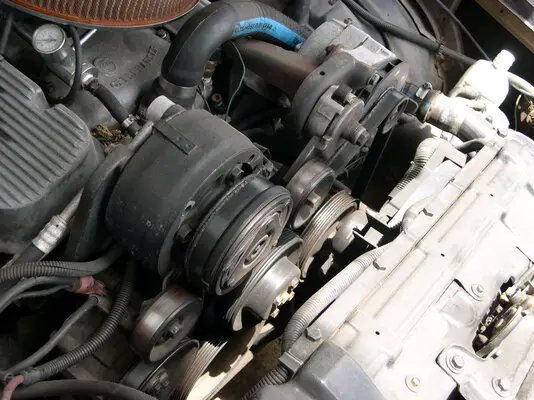

I have seen a few threads here where people started these swaps. Unfortunately it looks like they never finished up the threads. I have already built the top end of the motor for my swap. I'm planning on also swapping in a 4L80e while this takes place. But I saw mention where the power steering pulley is too large and you need to swap in a 3.1 V6 pulley. I've got one ordered. But the big question for me now is the AC compressor. I saw mention in one build thread that the AC compressor didn't clear the hood. The user had posted a few more pics of the car driving with a stock hood on it, but no mention of how he got around it. I'm guessing he deleted the AC compressor for the time being.
How much clearance is needed for the compressor to fit under the hood? I planned to get a cowl hood anyhow. But I'd like to maybe see if I can make all this fit under a stock hood and keep AC. To further complicate things, I plan to add onto the stock bracket a mount to mount a procharger P1SC supercharger onto it as well. But I planned to tuck it outward and lower than the AC compressor with two idler pulleys inboard. (Probably use a timing belt idler from a modern car for a smaller diameter pulley)
