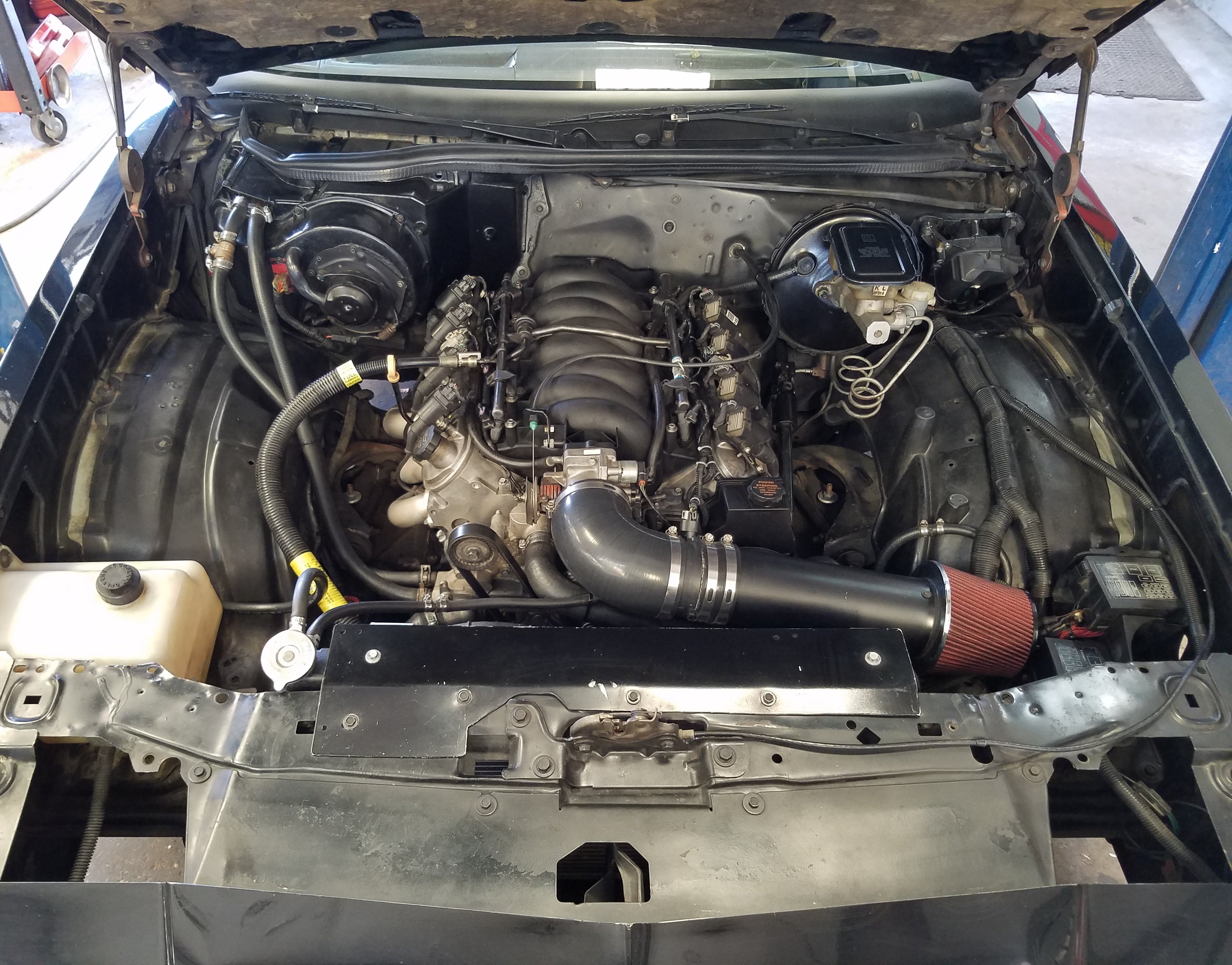

Factory 99-02 V8 Truck Cable and move that little black piece to the crimp that's farther up on the cable instead of the factory location. Bend the Gbody Gas Pedal for full Throttle Body movement.
Have had a truck one since 2010, no issues. Keep a spare one in a box that I got for free a while back incase I need it.
Running the same setup. Works great.
