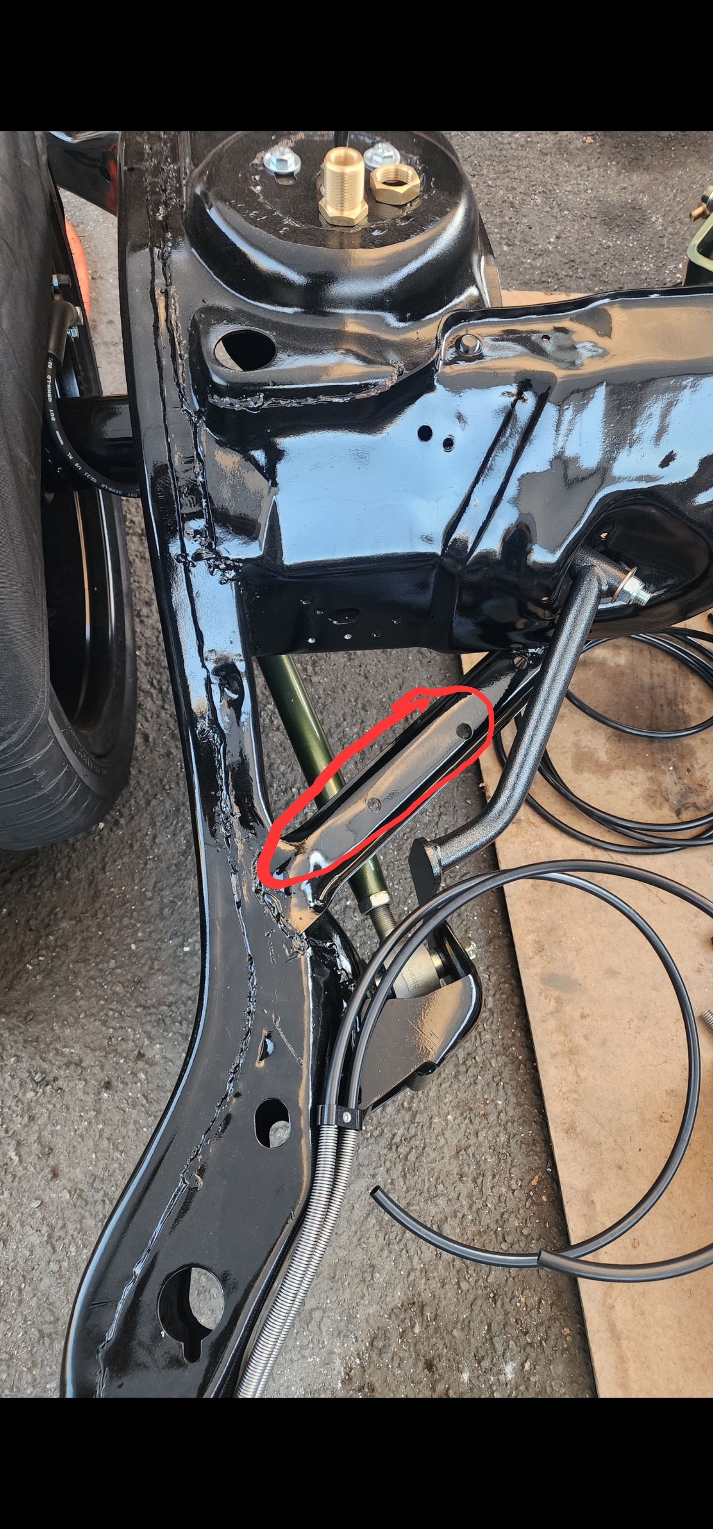

Need some help. Can any body tell how much clearance is between this braket and the body, im trying to run my air lines on top but im not sure how much space is there, and I dont want to crush them when the body is on.
And while I'm asking, also how much space here also between the frame and body.
I’ll crawl under my car again tonight, but there’s quite a lot of space there.
I’ve got a -8 and a -6 push lock fuel hose set running there. The control arm mound braces are far tighter to the floor than that bracket.
And body spacing between the frame is as much as your bushings, but I don’t believe it’ll be easy to run anything on top without risking the body pinching it to the frame. The channels for the floor pan are really tight, even for my soft hands.

Thank you UC465
If you're under there and can snap a couple pics i would appreciate it .

Sorry it took me a a bit longer, had some dental work that required me to keep my head elevated.
I don’t have any concrete measurements, but the gap between that brace and rear seat pan is about an inch wide at its tightest point. Take a 1/4” off for discrepancy’s sake.
My control arm braces are far, far tighter however….
It ain’t clean, but what street car is?
If you’re really worried about the braces, a rubber mallet will solve that. This area is under the rear seat bottom, coming up the the base of the back cushion. If you’ve got a passenger in there bottoming out the rear seat cushions… they shouldn’t be in your car. I’m 6’1” and 290 pounds on a dry day, and I don’t bottom out my used rear seat.
If you need more references, let me know. I’ve got the fuel tank out of mine so it’s easy to access on the ground.
Hope this helps!
