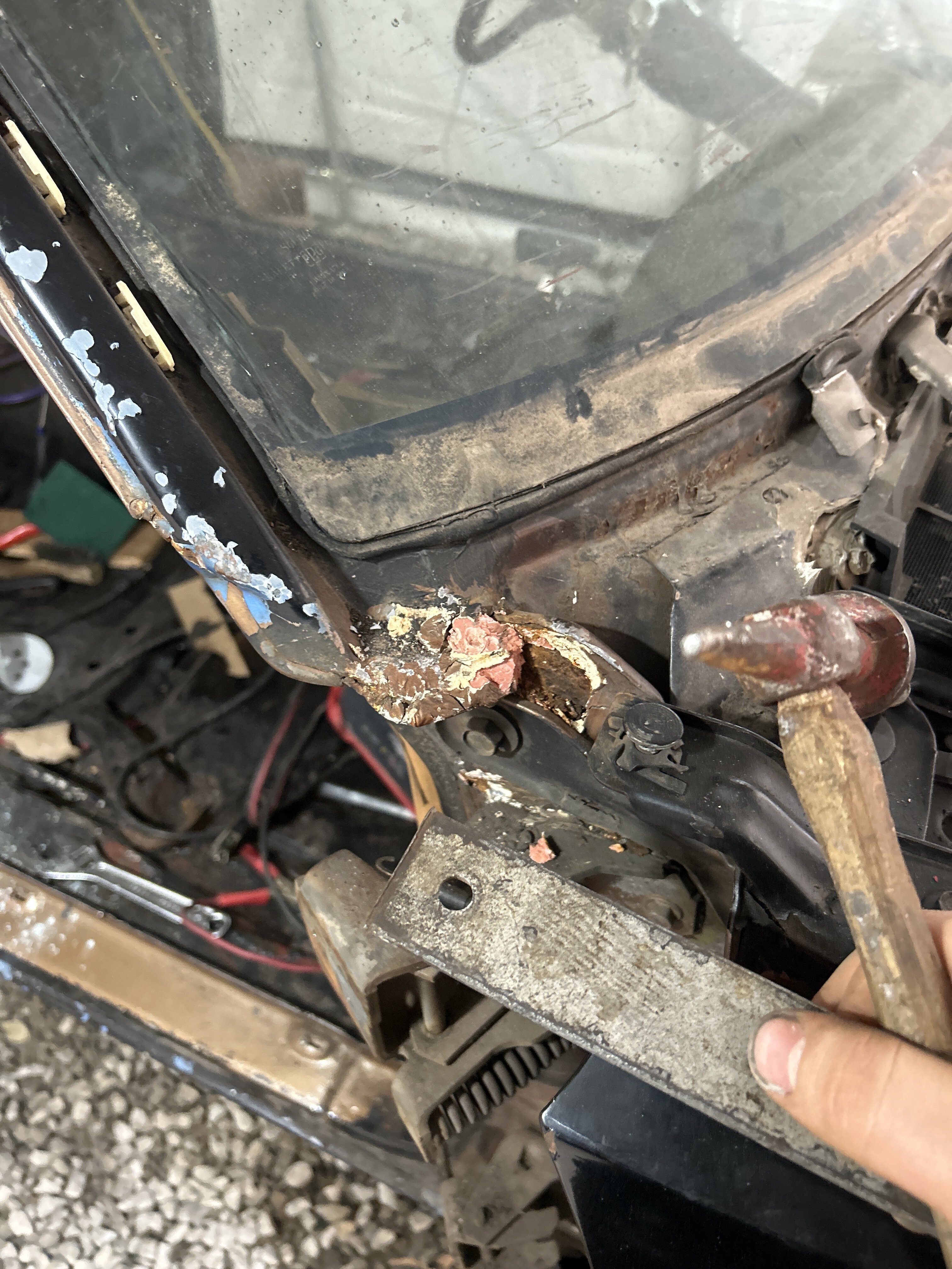

image.jpgMore bondo found at both driver and passenger corner, not a shocker, should I put more on?
Putting more Bondo on that is like putting a Bandaid on a melanoma. It'll cover it up and make it look better, but the cancer underneath will still grow....
Depends on your end goal I guess.
Bondo absorbs moisture like a sponge and rots metal faster.
What’s left is thin metal covered in about 1/4” of bondo so does that mean that the original just rotted away so much that whoever “repaired it” put that much, I want to know what the original looks like so I can know if I need to weld in something new or just cover it?
the factory globed on seam sealer there i bet that is what you are seeing
Over 20yrs ago the floors on my 84 soaked went the car got wet. The factory sealer cracked allowing water in. I picked out all the old sealer and used silicon to seal it back up.
