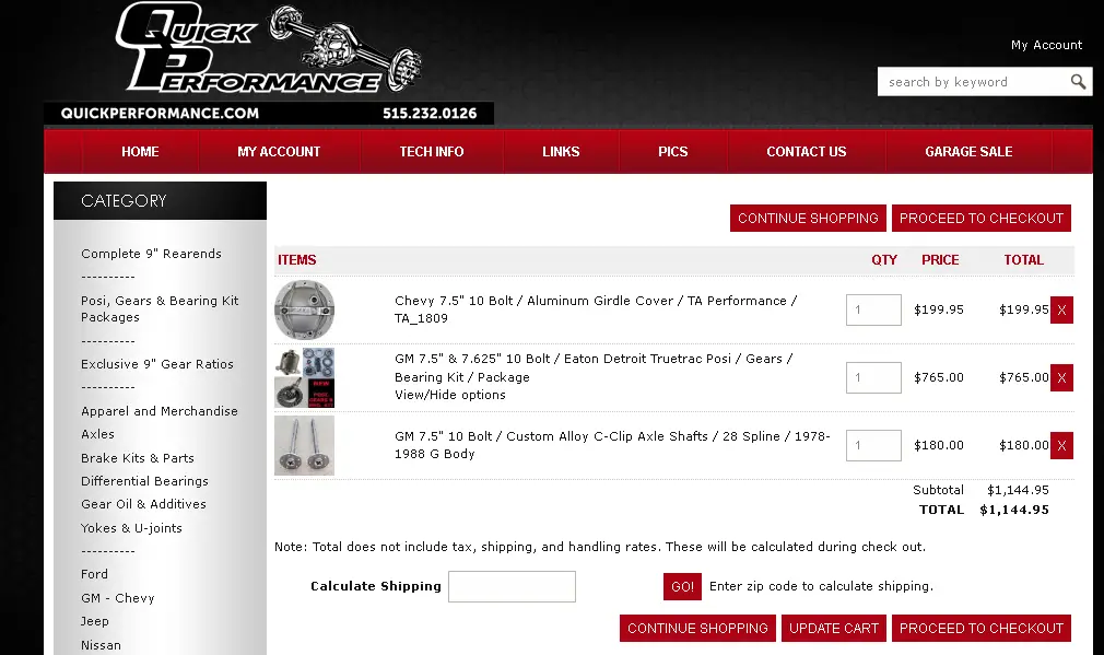

These components below (and a few cans of spray paint) will upgrade the existing rear to the extent possible... Obviously the aluminum cover isn't necessary. That is what I would do with a 350hp SBC.
I had the local transmission shop rebuild my 7.5" rear in 2021. Rebuilding a rear isn't simple, but many here have done it.
The way the 7.5" rears fail is hooking with gummy tires on a hard launch - axel snaps and the wheel/axel walks out of the housing.
