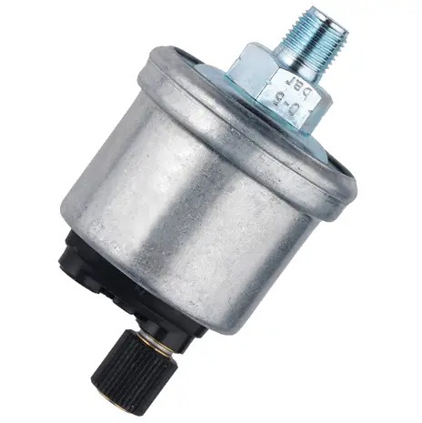

Typically, you see 2 types. One for 0-60 psi gages, one for 0-80 psi gages. Each are calibrated for those particular applications with different ohm ranges. However, think about it. A 20 psi range difference on your factory gage isn't going to make much of a difference in real life between the 2 calibrations. I believe all the G-bodies have 0-60 factory gages, and a few of the 4 cyl other platforms and trucks use 0-80 gages. Not 100% sure on that.
0-60 psi type, p/n 459417, superseded to 14036243
0-80 psi type, p/n 14040816. Lots of part numbers in this one's lineage.
Call me crazy, but I've never had one blow out on me.
Here's an OG style ACDelco 0-80 psi, 1/8-27 NPT. $58-ish plus tax. Buy once, cry once.
And another one 0-80, even older with a previous part number. $42 OBO plus tax.
