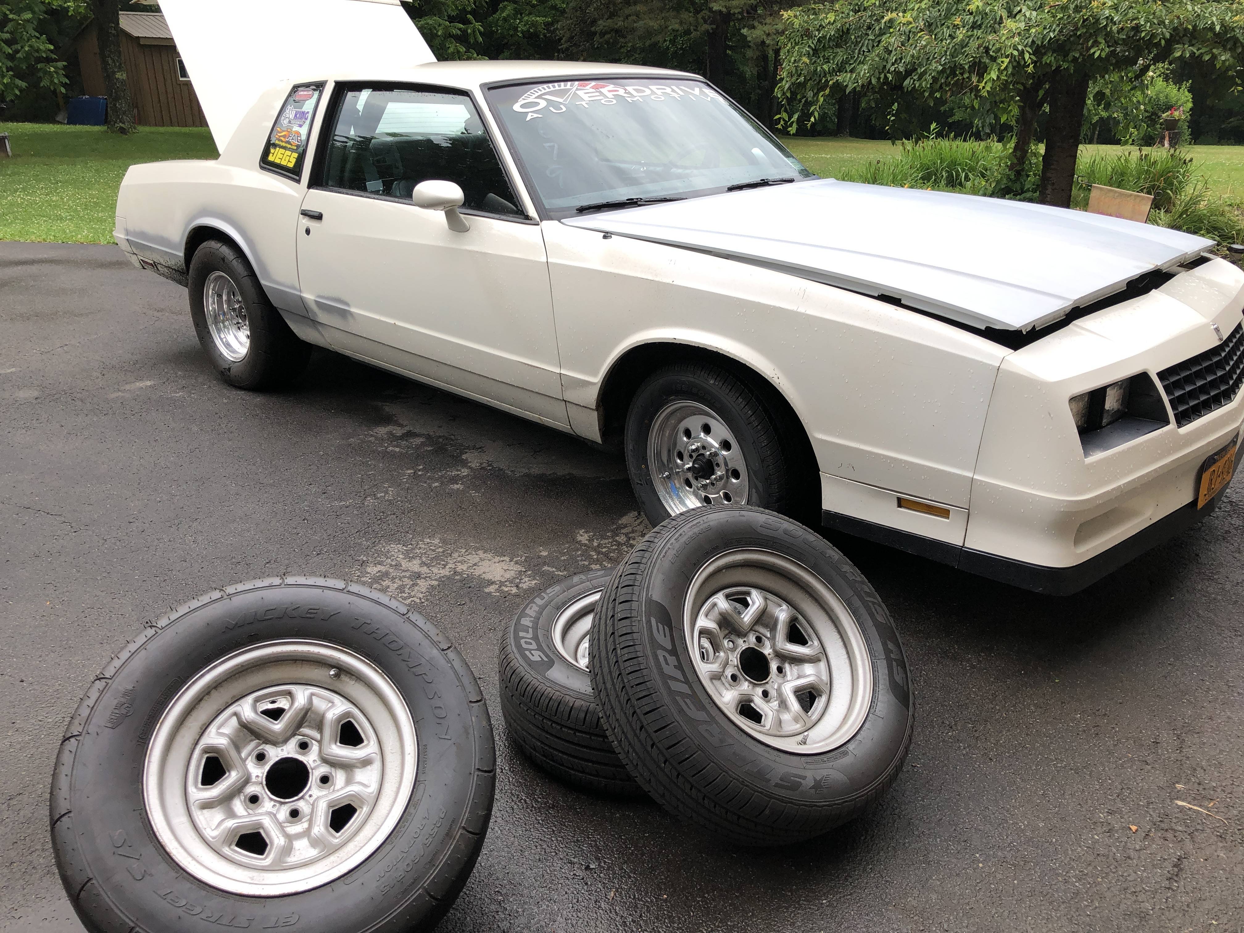

So, back on with the ‘street’ tires’ lol.
You got a draggy?
